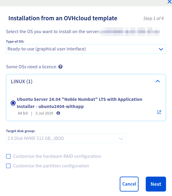

  1. Select your server under Dedicated servers.
  2. In the General information tab, next to Operating system (OS), click the ... button, then click Reinstall my server.
    Click the button next to the operating system to start the installation
  3. In the Installation from an OVHcloud template window, set Type of OS to Ready-to-use (graphical user interface), then select the Ubuntu Server 24.04 "Noble Numbat" LTS with Application Installer template. Choose the Target disk group and click Next.
    Custom partitioning and hardware RAID configuration are not available with this template, so these options remain disabled.
    Select the Ubuntu template with Application Installer

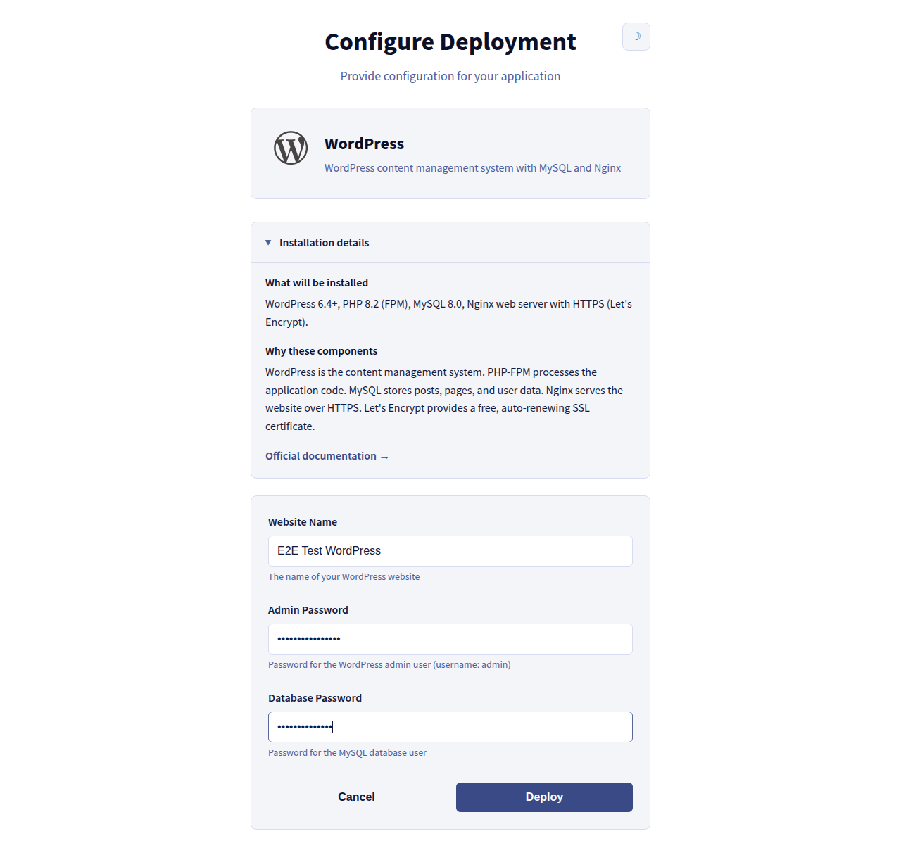

Step 2: Filling in the configuration form
The configurator opens directly on the application you selected at installation. Depending on that application, you either deploy straight away or fill in a short form first:
  • Applications with no fields — Coolify, Dokploy, Easypanel, FastPanel, HestiaCP, Discourse, Matomo and n8n — generate any credentials they need and display them at the end. Click Deploy.
  • Applications with fields — WordPress, Drupal, Nextcloud, PrestaShop, OpenClaw and OVHcloud Game Panel — ask for a few values, such as a site name, an administrator password or a database password. Required fields are marked and optional ones may have sensible defaults.
An Installation details panel above the form lists what will be installed and why, along with a link to the vendor's official documentation.
Each field is validated before the deployment starts (for example an email field must contain a valid email address, and passwords have a minimum length). Fix any highlighted field and submit again.
Tip
Choose strong passwords: the values you enter here become your real application credentials.
Configuration form for a WordPress deployment
Then click Deploy.

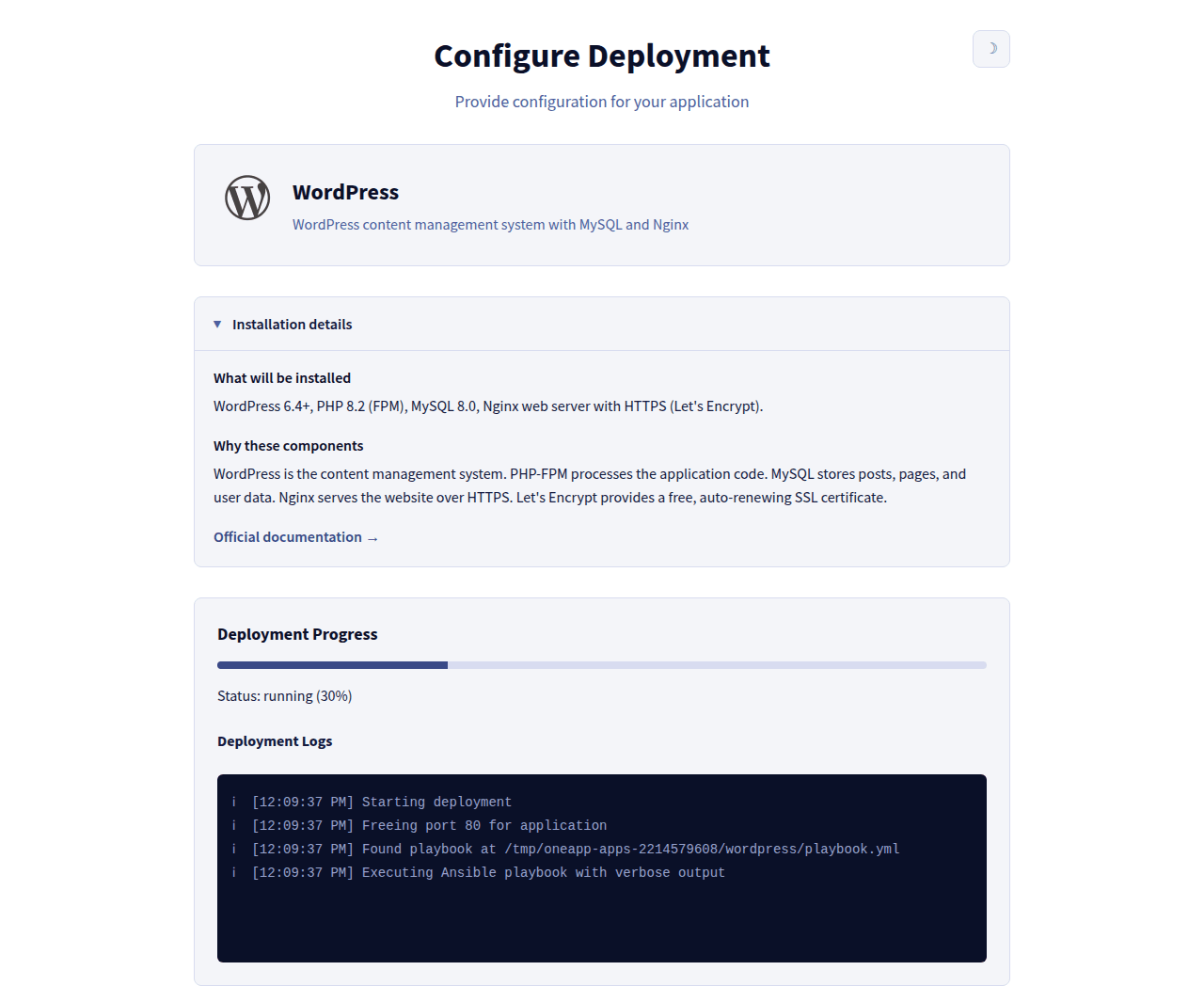

Step 3: Following the deployment
The configurator runs the installation and streams the progress live: a status (pending, then running, then completed or failed), a progress bar, and the installation logs. Values you entered in the form are masked in the logs.
Deployment progress and live logs
A deployment usually takes a few minutes; heavier applications such as Discourse take longer. You can keep the tab open, but the installation continues on the server even if your browser disconnects — reopen your link to resume watching.
Only one deployment runs at a time. If a deployment is already in progress and you start another, the configurator sends you back to the one in progress instead of starting a second. This is what enforces the "one application per server" rule.
