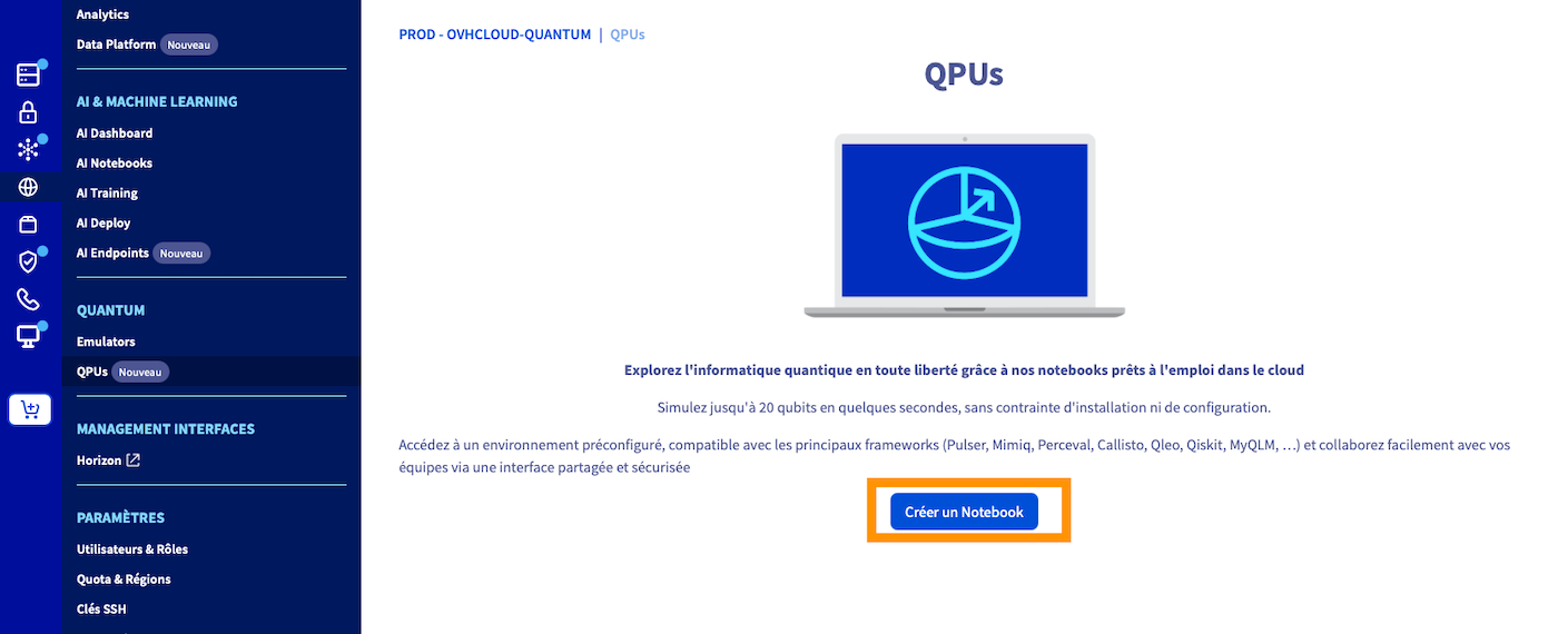

  1. Log in to the and navigate to the Public Cloud section.
  2. Select the Public Cloud project you want to use and click the Quantum QPUs category.
  3. Click the Create a Notebook button. The authorization process will take place silently in the background.
Create a Notebook Control Panel manager 01

Navigate to the Public Cloud section of the and click the Quantum QPUs category. Click the Create a Notebook button and follow the prompts to specify the configuration of your Quantum Notebook.

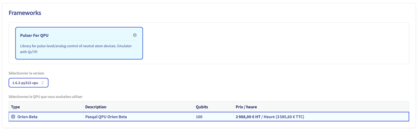

4. Pre-configured frameworks
Choose the Quantum Python framework you want to use, which will be pre-installed and ready to use when your notebook is launched. Select the version that suits your needs. Then, click Next to continue.
Create a Notebook Control Panel manager 04

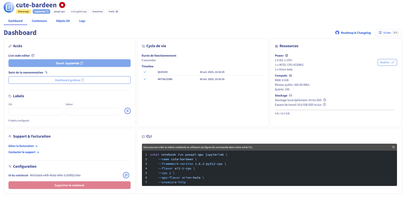

9. Launch the Quantum Notebook
At the end of the process, review your settings and click the Order now button to confirm and launch the creation of your Notebook. You will be redirected to your notebook dashboard:
Create a Notebook Control Panel manager 10

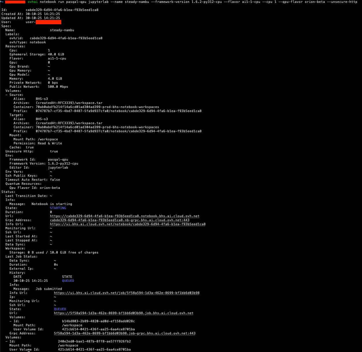

Note at the bottom of the screen the equivalent ovhai CLI command. This command allows you to run the exact same Notebook using the CLI.

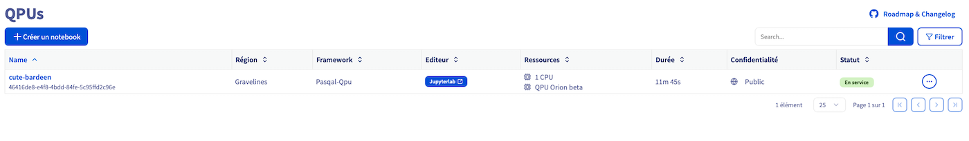

When your Notebook is created, it will appear on your Quantum QPUs tab:
Create a Notebook Control Panel manager 11

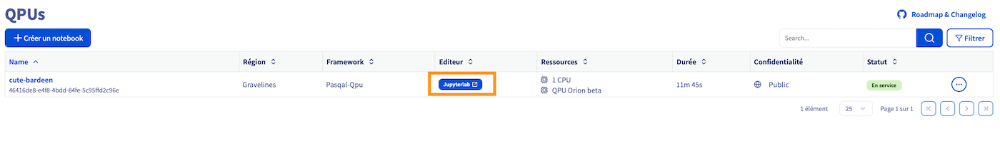

Once your Quantum Notebook is created and running, you can access it using the JupyterLab link in the Quantum Notebooks board or through the ovhai CLI, Quantum API, or Python SDK.
Using the Control Panel (UI)
Using ovhai CLI
Using the Quantum API
Using the Python SDK
Click the JupyterLab link in the Access column:
Accessing a Notebook Control Panel manager 1

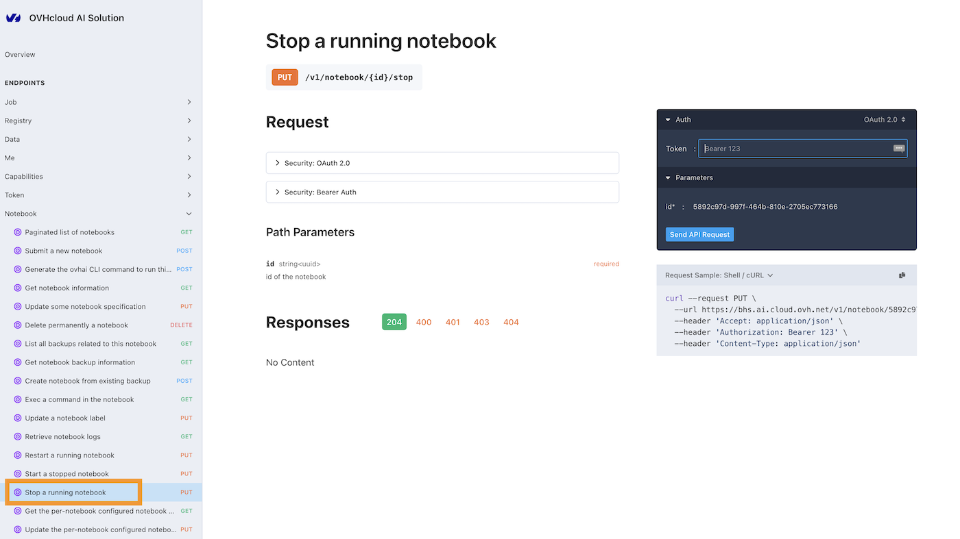

Stopping a Quantum Notebook
You can stop your Quantum Notebook at any time to release its compute resources. This will release its compute resources but will keep your Notebook data and installed libraries. Therefore, you will not incur any further charges for compute unless you restart the Notebook. However, attached storage will be billed at the price of OVHcloud Object Storage (consult the Quantum Notebooks Billing documentation for more information). To do so, follow these steps:
Using ovhai CLI
Go to the Quantum Notebooks board and click on the ... button next to the Notebook you want to stop. Click the Stop button to stop the Notebook. Or, on the notebook board, you can click on the red button at the top of the page.
Stop a Notebook Control Panel manager

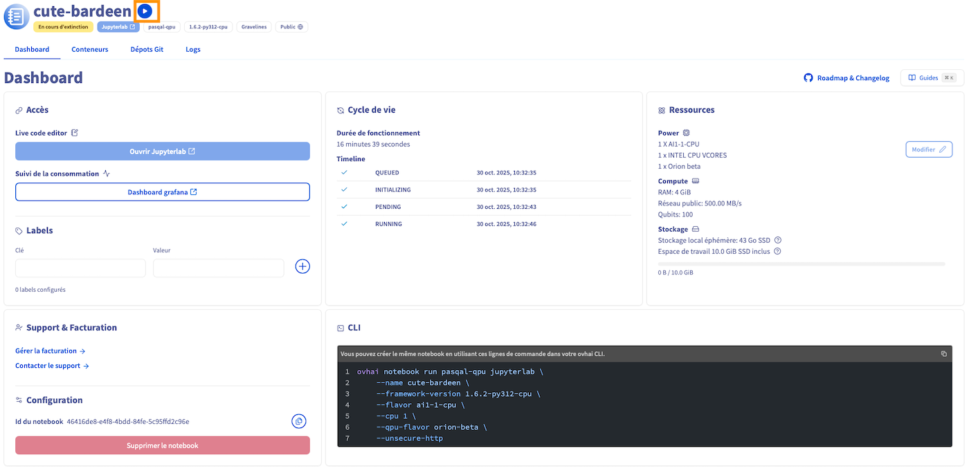

To restart a stopped Notebook, follow these steps:
Using ovhai CLI
Go to the Quantum Notebooks board and click on the ... button next to the Notebook you want to restart. Click the Start button to restart the Notebook. Or, on the notebook board, you can click on the blue button at the top of the page.
Restart a Notebook Control Panel manager

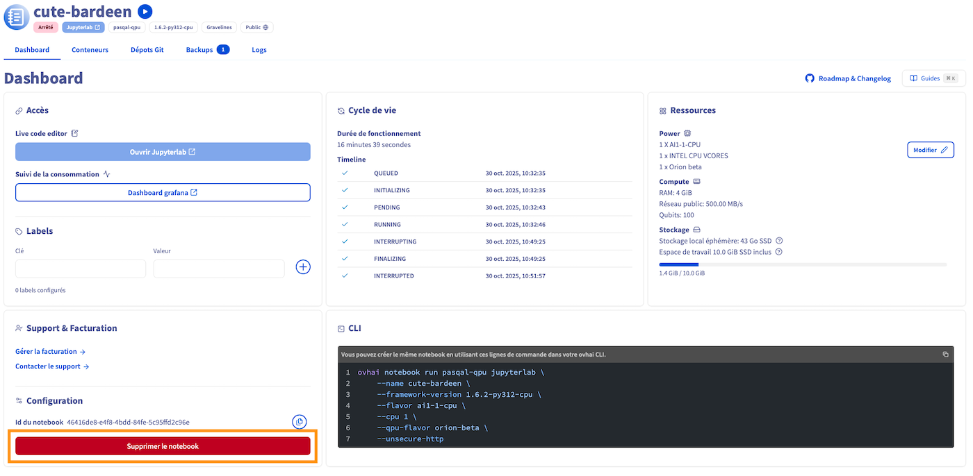

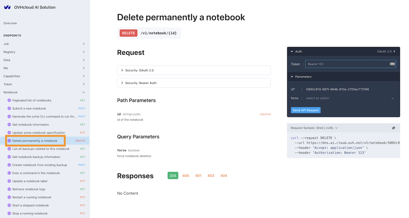

The notebook must be stopped before deleting it. To delete a Notebook, follow these steps:
Using ovhai CLI
Go to the Quantum Notebooks board and click on the ... button next to the Notebook you want to delete. Click the Delete button to stop the Notebook. Or, on the notebook board, you can click on the Delete notebook button at the bottom of the page.
Delete a Notebook Control Panel manager
