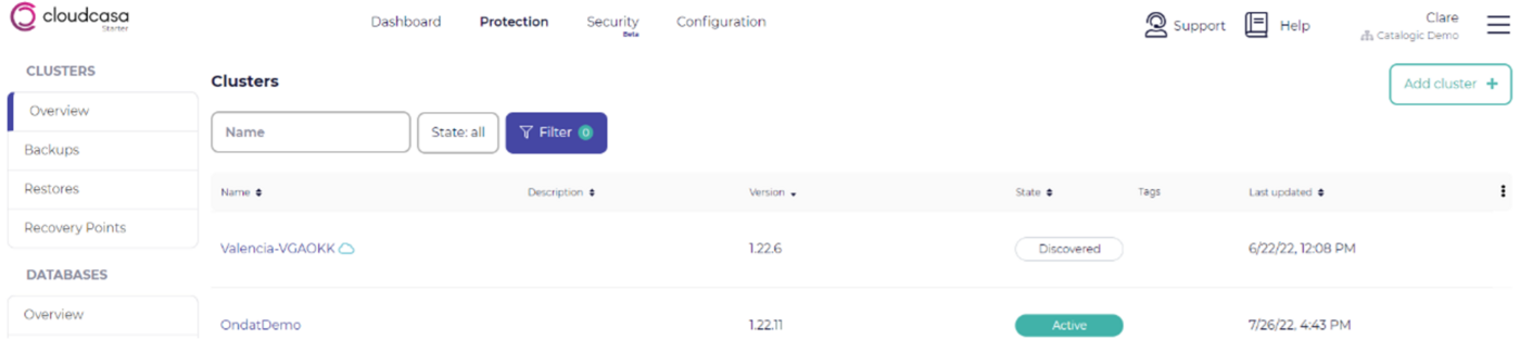

After logging in to CloudCasa, navigate to Protection tab > Clusters > Overview and click on the Add cluster button at the top right.
Cluster overview

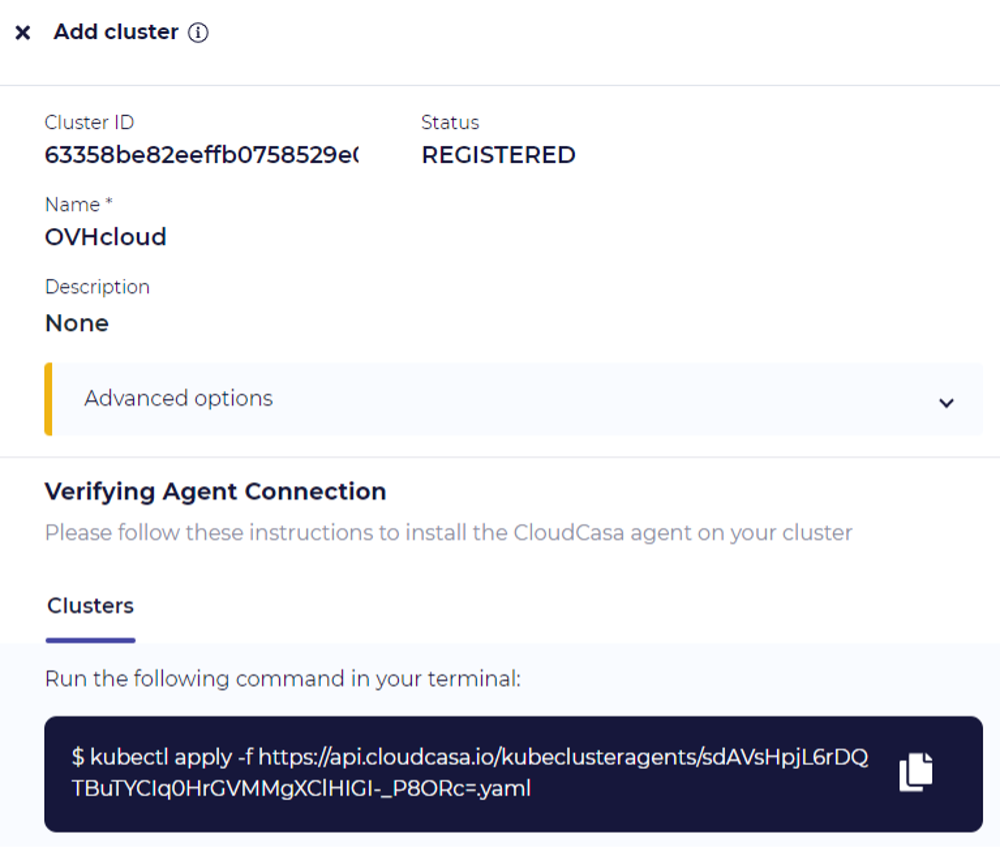

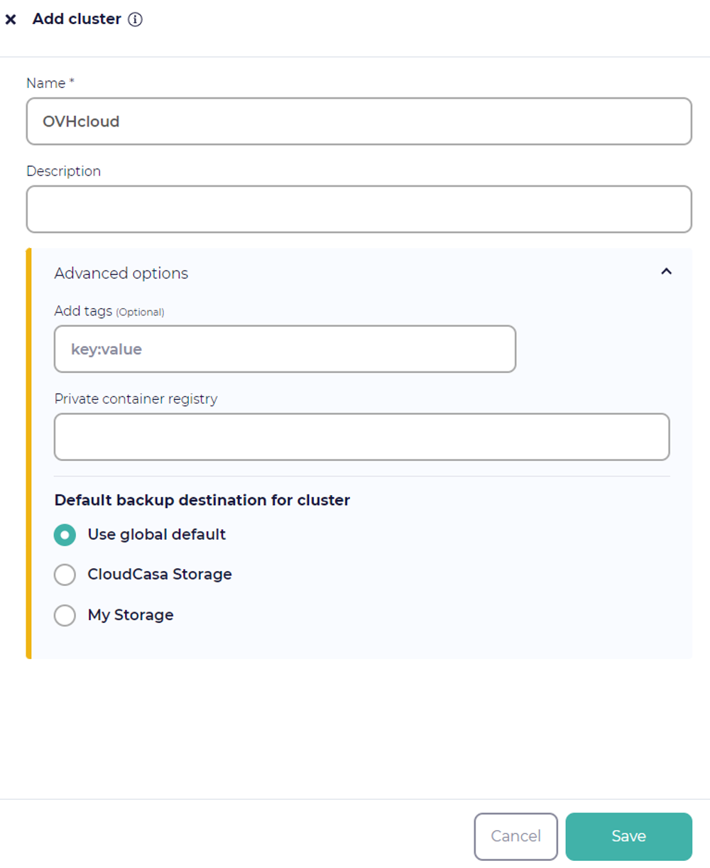

Provide the cluster name and description, then click on the Save button.
Add a cluster
This will display a kubectl command to run to install the CloudCasa agent.
Kubectl

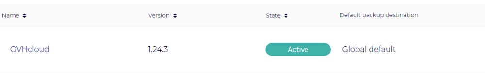

Run the kubectl command on your cluster and confirm that the registered Kubernetes cluster moves into the Active state in the CloudCasa UI. This should take no more than a couple of minutes. Your CloudCasa agent has now successfully been deployed.
Cluster active

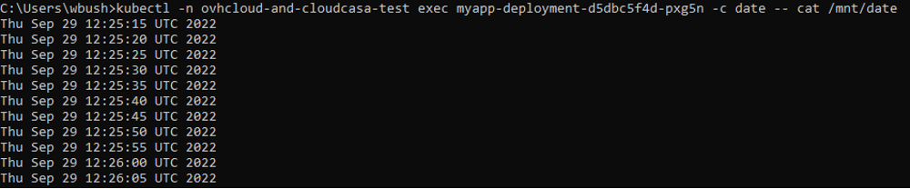

This deployment creates a pod with 2 containers. The date container will simply append the date to stdout and /mnt/date every 5 seconds:
kubectl -n ovhcloud-and-cloudcasa-test exec myapp-deployment-<pod-name> -c date -- cat /mnt/date

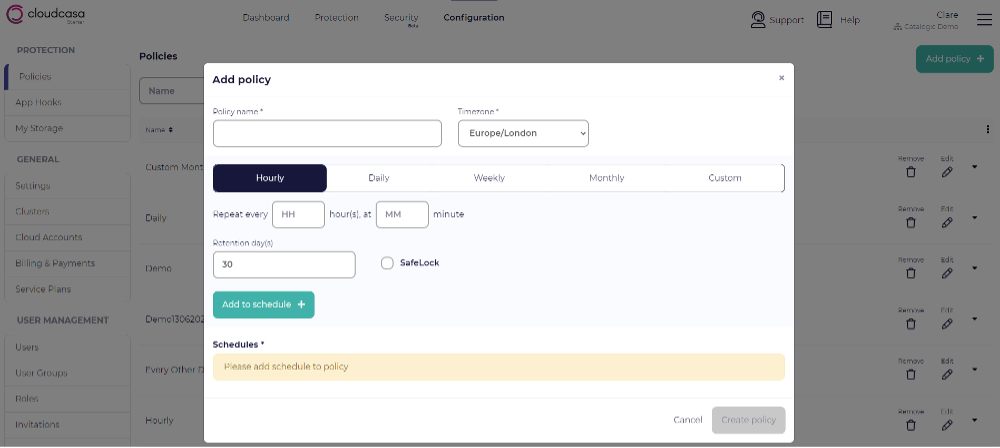

A backup policy allows you to define when backups that use it will run and for how long they will be retained. You can have multiple schedules with different retention times in one policy. For example, a policy may specify the creation of hourly backups that are retained for 7 days, and daily backups that are retained for 30 days.
Navigate to the Policies tab via Configuration > Protection > Policies. Create a Policy by clicking on the Add policy button. Provide the required information, then click on the Create policy button.

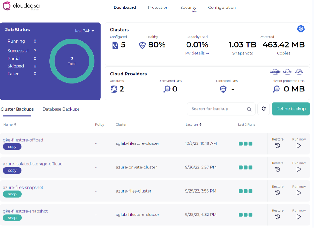

Navigate to the Dashboard tab. Click on Define backup. Provide Backup Name and select the Cluster for which you are defining a backup.

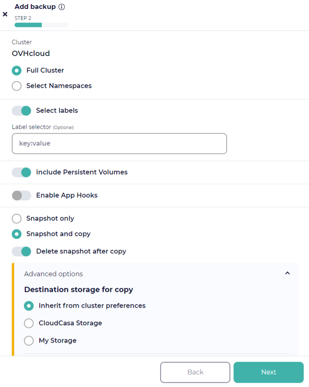

Select either Full Cluster, a Specific Namespace, or provide a Label selector (Optional). If backing up a specific namespace, enter the name of the namespace you want to protect.
Add backup
For the backup operation, choose whether to snapshot your PVs. Then select one of the two available options:
  • Snapshot only
  • Snapshot and copy
The “Snapshot and copy” option is only available with a paid subscription.
If you want to run pre- and post-backup commands to enable application consistent backups, select Enable App Hooks and enter the appropriate pre- and post-backup app hook definitions. You will need to have defined custom hooks under Configuration/App Hooks to quiesce the application and filesystem. This isn’t necessary for all applications. If you need assistance with these, use the in-product chat or get in contact with casa@cloudcasa.io.

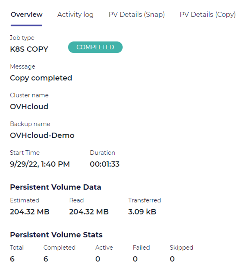

On the next page, enable Run now to run the Backup operation immediately and provide Retention days (the retention period is just for this ad-hoc run). Click on the Create button. This will create a Backup definition.
Navigate to the Dashboard tab and find the Clusters > Backups that you want to run. Click the Run now button on its line. You will see the job running in the dashboard’s Activity tab. Verify that it completes successfully.

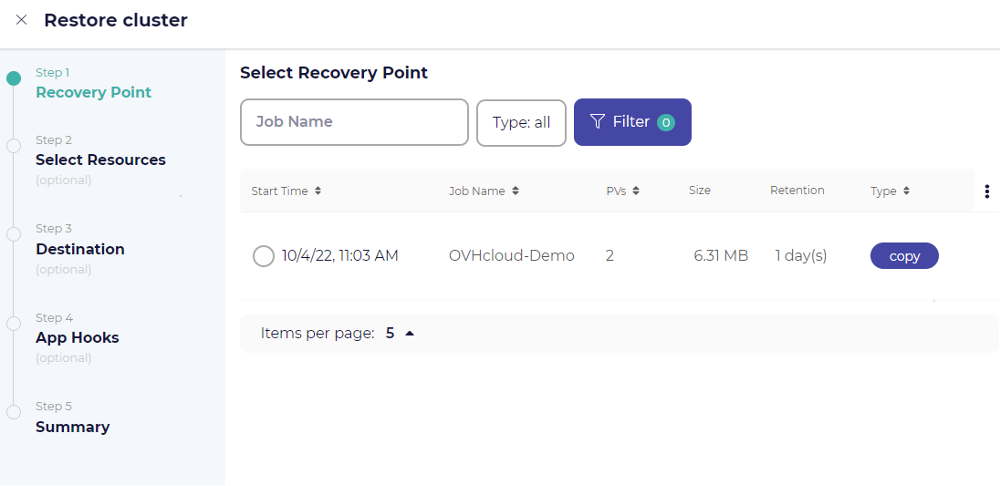

Now let’s recover our dummy application. Go back to the Clusters > Backups on the Dashboard and click the Restore icon next to your backup definition in the list.
When the restore page opens, select a specific recovery point by choosing it from the list of available recovery points. Then click the Next button.

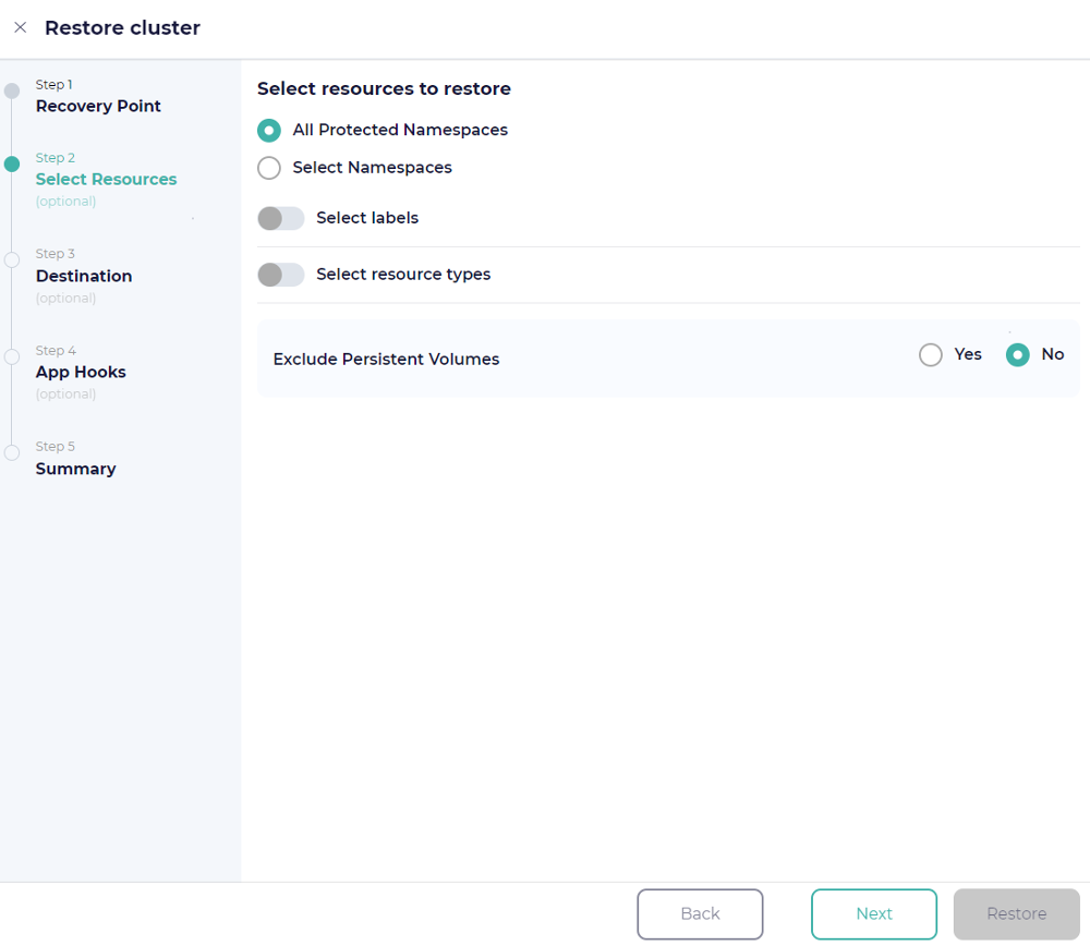

On the next page you can choose whether to restore all namespaces in the backup, or only selected namespaces. If you choose the latter, a list of namespaces will be displayed from which you can select the namespace(s) for which the restore operation will be performed. Remember that only namespaces included in the backup will be shown.
For the demo, we will recover the full ovhcloud-and-cloudcasa-test namespace. We also support the recovery of specific resource types, and utilising post-restore scripts for the recovery via enabling app hooks.
Select resources
Note that existing namespaces cannot be over-written, so if you want to restore an existing namespace to a cluster, you need to delete the old one first. You can also rename namespaces when restoring (later).
You can add labels to be used to select resources for restore as well. These are key: value pairs, and will not be validated by the UI. We can add them one at a time or add multiple pairs at once, separated by spaces.
Finally, we need to choose whether or not to restore PV snapshots. If you toggle off the "Exclude persistent volumes" option, PVs will be restored using the snapshots or copies associated with the recovery point you’ve selected.
Remember that if you have selected specific namespaces or labels for restore, only PVs in the namespaces or with the labels you’ve selected will be restored.

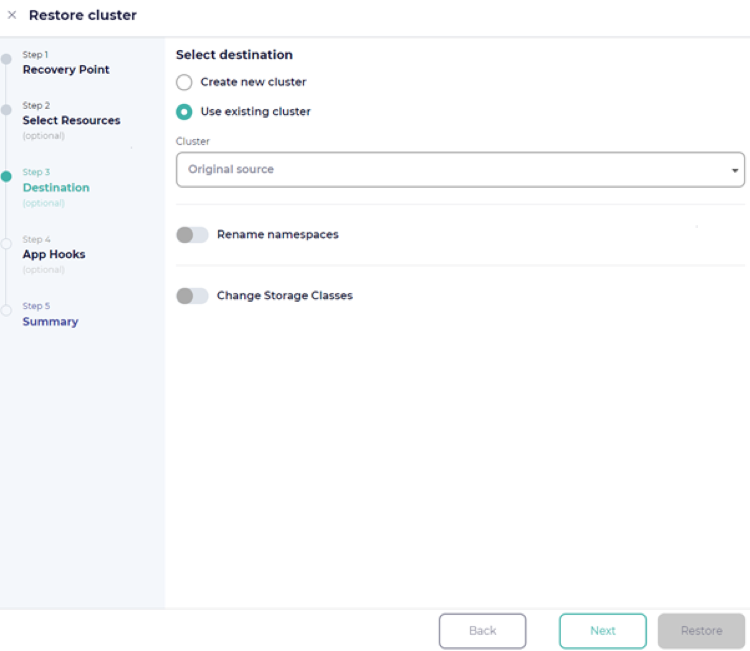

On the next page, you will be presented with destination options.
Destination cluster
The system will also save the job under its name so that you can modify and re-run it later.
On the next step, you can choose an alternate cluster to restore to. By default, the restore will go to the original cluster. You can choose to rename restored namespaces by adding a prefix and/or suffix and change the storage classes if desired.
Remember that all the restored namespaces will have these prefixes or suffixes added, so if you want to rename only specific namespaces, you should run multiple restores and select those namespaces explicitly.

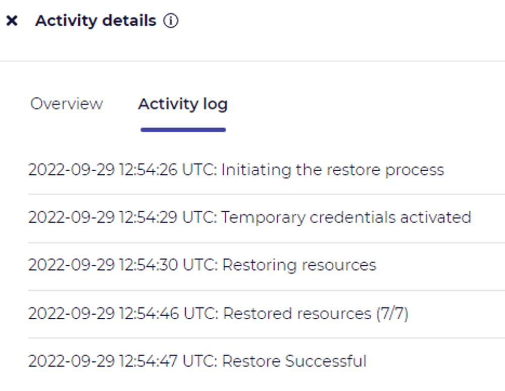

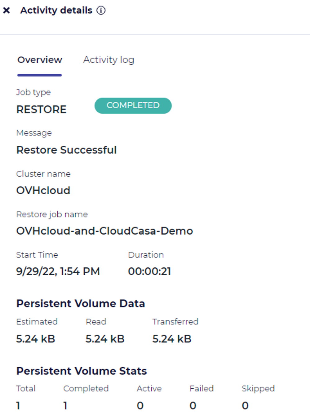

Finally, provide the restore job with a name. Click the Restore button and CloudCasa will do the rest! You can watch the progress of the restore job in the progress pane. You can also edit and re-run it, if you wish, under the cluster’s Restore tab.
Activity Details Activity Logs

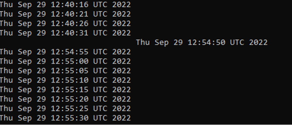

Finally let’s view the contents of the /mnt/date in the application’s pod. You can see the 14 minutes gap here which aligns with the snapshot time of 12:40 and the restore time of 12:54.
