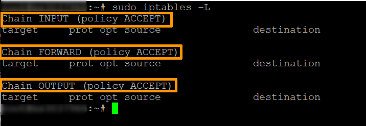

Step 3: Check the current status of iptables
To display all of the current rules on your server, enter the following command in the terminal window:
sudo iptables -L
The system displays the status of your chains.
The output will list three chains:
Output of sudo iptables -L showing the INPUT, FORWARD and OUTPUT chains

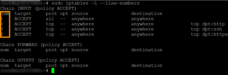

Step 8: Delete a rule
To delete a rule, use its line number.
First, list all rules by entering the following:
sudo iptables -L --line-numbers
Output of sudo iptables -L --line-numbers with the rule numbers
Locate the line for the firewall rule you want to remove and run this command:
sudo iptables -D INPUT <Number>
Replace Number with the rule line number you want to delete.
