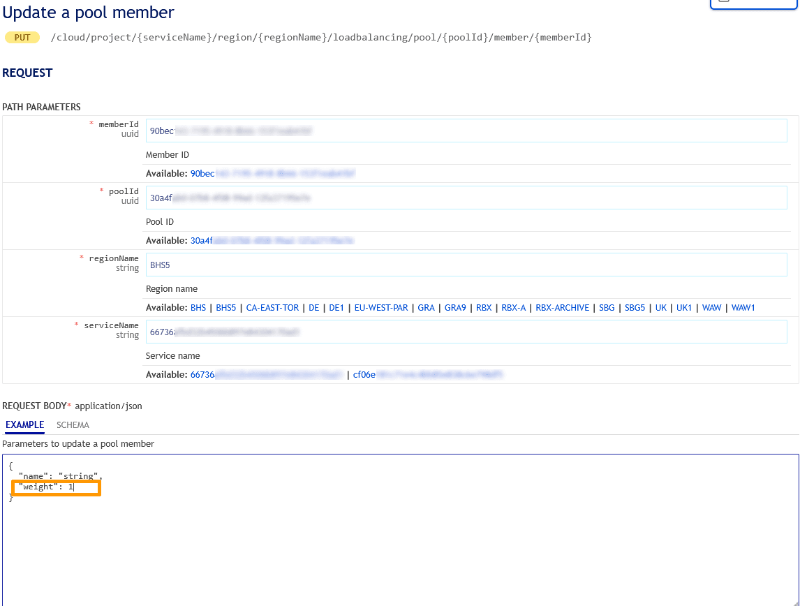

Fill in the fields with the previously obtained information:
serviceName: The Public Cloud project ID in the form of a 32-character string.
regionName: The name of your region.
poolId: The Pool ID in the form of a 32-character string.
memberId: The Member ID in the form of a 32-character string.
weight: Set the weight to 0.
Click on Execute.
