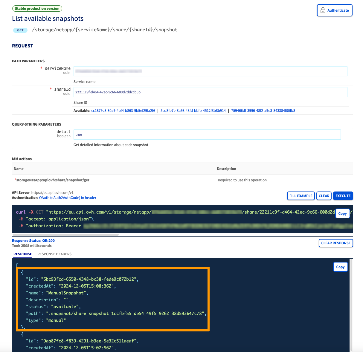

1. Identify the id of the snapshot that will be used with the following API call:
Parameters:
  • serviceName: is the service unique ID
  • shareId: is the share to clone from
CloneVolume

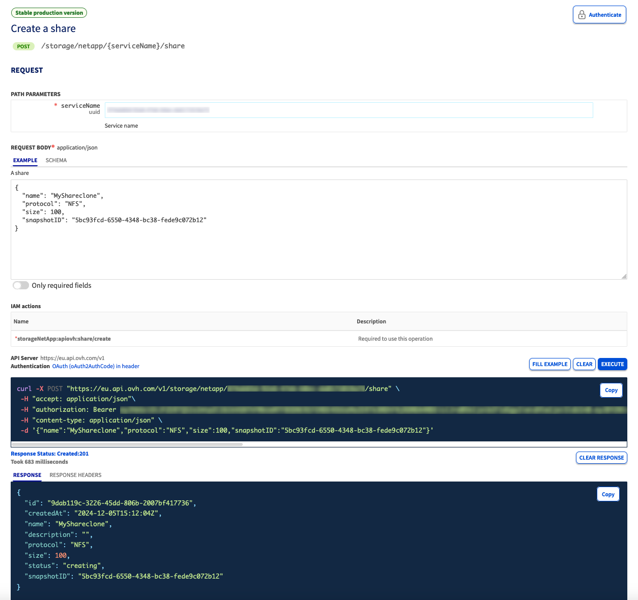

2. Clone the volume from the snapshot by using the /share API route:
Parameters:
  • size: is the share size. It should be equal or greater than the snapshot size.
  • protocol: is the share protocol. Only NFS is allowed.
  • snapshotID: is the snapshot ID to use when creating the share
  • name: (Optional) is the share name
  • description: (Optional) is the share description
CloneVolume
The OVHcloud API will return an HTTP 201 (Created) code along with volume information.
The volume status will be set to creating_from_snapshot and then will change to available once the volume creation is complete.
