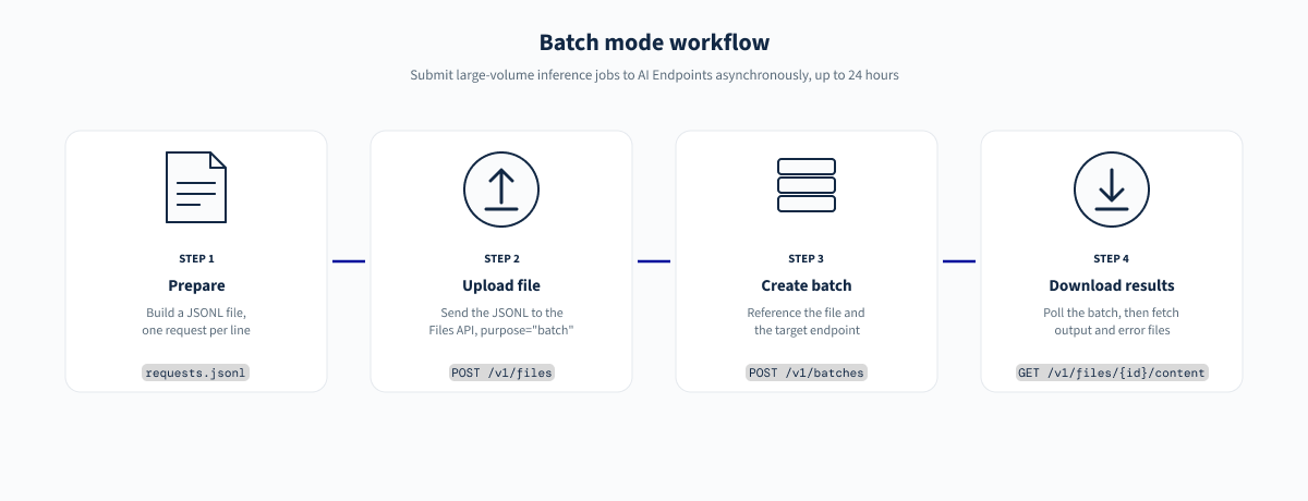

How batch mode works
A batch job is processed in four stages:
  1. Prepare a JSONL file where each line describes a single request (model, endpoint, body).
  2. Upload this file to AI Endpoints through the Files API (/v1/files) with purpose="batch".
  3. Create a batch (/v1/batches) referencing the uploaded file and the target endpoint.
  4. Poll the batch status until it is completed, then download the output file (and the error file, if any).
Diagram of the four batch job lifecycle stages
Each line of the input file is processed independently. Successful responses are written to the output file, failed ones to the error file. Both files are retrieved through the Files API.

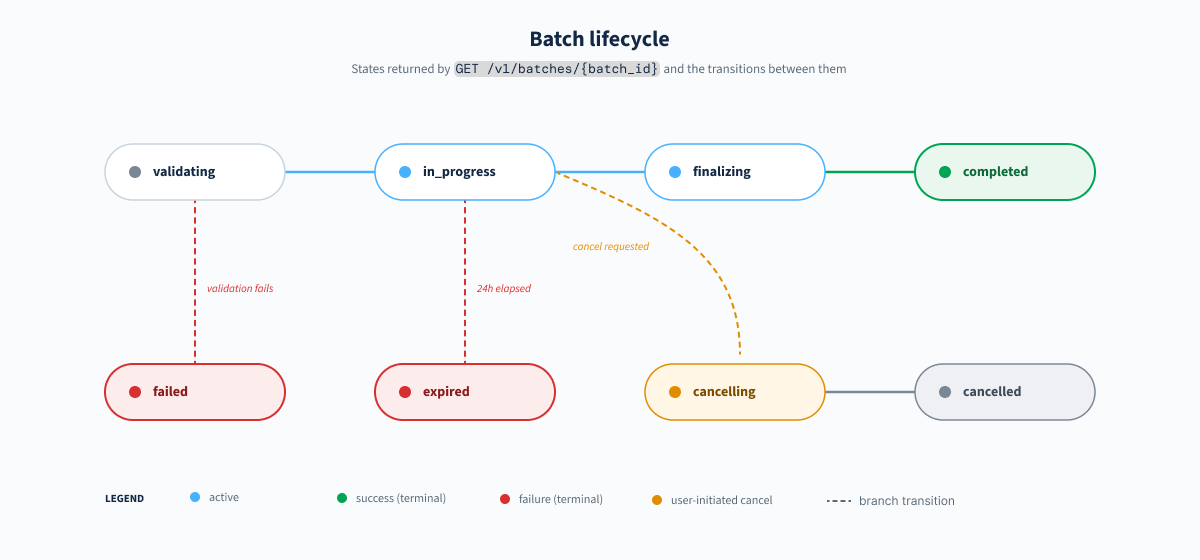

A batch object progresses through the following states:
StatusMeaning
validatingThe input file is being validated before processing starts.
failedThe input file did not pass validation.
in_progressThe batch is currently being processed.
finalizingProcessing is done. The results are being compiled into the output file.
completedThe batch finished successfully. Output file (and error file if any) are ready.
expiredThe batch could not be completed within the requested completion window.
cancellingA cancellation has been requested and is being applied.
cancelledThe batch has been cancelled by the user.
The request_counts field reports the total, completed, and failed counts for individual requests. It is the easiest way to monitor progress.
