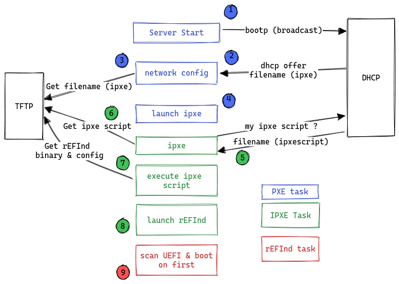

Here is a (logical) Netboot boot schema:
Netboot in action
Description/Details
1. Sending a discover request to DHCP from the client machine (in broadcast)
2. DHCP assigns an IP address to the client machine (offer/request/ack). iPXE binary recovery request
3. iPXE binary TFTP recovery
4. Loading iPXE binary as firmware
5. iPXE firmware recovery request
6. Retrieving the associated iPXE script in TFTP
7. Running the iPXE script. Retrieving rEFInd resources: required binary and configuration file
8. Running and loading the rEFInd binary
9. rEFInd launches its scan task to identify boot sectors for local disks

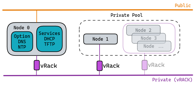

Below is an example of a basic private infrastructure (layer 2 diagram):
Schema
Example:
  • Services hosted/shared on Node 0.
  • Only one Node 1 client machine with active OLA.
