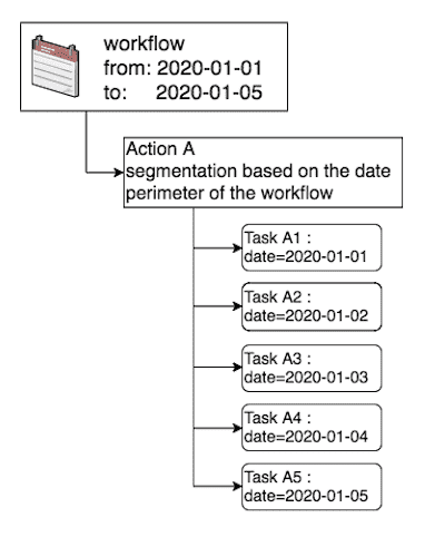

1. Based on the date perimeter of the workflow
If your source data contains a date attribute, it is possible to split the action in separate processes which will individually address a specific date or a group of dates (bucket). In this case, each task will apply a filter on the date that it needs to extract.
1. Based on the date perimeter of the workflow — Dates nochunk
Compatibility
This segmentation option is only compatible with the following actions and sources:
Action TypesSource Types
Load; Aggregate; Diff; Delete_Diff; Delete; CustomDatabases: MySQL, PostgreSQL, SQLServer, Impala, Hive, BiqQuery, ElasticSearch, Cassandra, Redshift, Oracle; API: Facebook, Twitter, Google Analytics, YouTube Private, YouTube Public
Bucket Size
If your source contains a significant number of dates, it might lead to generating a multitude of small tasks and not be particularly beneficial to your action run time. This is particularly common when dealing with datetime type attributes that can record time information up to the milli-second unit.
To avoid generating too many tasks, you can make each task manage several dates at once by using the “bucket size” option. Simply set a size for your bucket to decide how many dates at a time you want your task to manage. The default “bucket size” value is 1, that is:
  • If you do not set the bucket size, each task will handle 1 date
  • If you set the bucket size to 2, each task will handle 2 dates
  • If you set the bucket size to 10, each task will handle 10 dates
  • And so on...
If you’re still unclear about what the “bucket size” does, find out more in the bucket size reference.

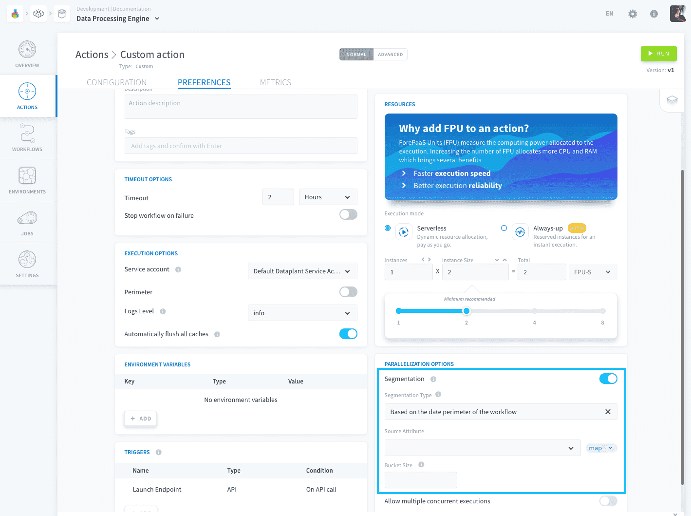

Configuration
To configure this segmentation option select Based on the date perimeter of the workflow in the "Segmentation Type" dropdown, and select the attribute.
Configuration — Based on perimeter dates
If you are using the expert mode interface, you will need to add the following fields to your action JSON configuration:
      "segmentation": {
        "active": true,
        "type": "workflow_dates",
        "var_name": "id2",
        "chunksize": 1

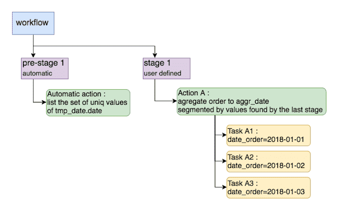

2. Based on an attribute of a Project table
This option lets you segment an action using a list of values contained in the column of a given table (usually a Reference Table) from your data model. For instance, let’s consider the following case where we’re trying to set the segmentation options for an action which loads the data from the Source Table “orders” to the Destination Table “aggr_date”:
Reference TableSource TableDestination Table
2. Based on an attribute of a Project table — Tmpdate2. Based on an attribute of a Project table — Orders2. Based on an attribute of a Project table — Aggr
Assuming, you want to aggregate “income” data per the date of orders “date_order”. Let's say that the “tmp_date” table serves as the reference table of all dates during which there was ever an order made, e.g. it contains a list of dates from 2019-01-01 to 2019-01-03.
By activating this segmentation mode, it will automatically generate a pre-stage to your main stage which contains your action, which will list the unique list of dates available in order to split your action in separate tasks as describe in the diagram below:
2. Based on an attribute of a Project table — Workflow
By doing so, the data from your Source Table “orders” will therefore be loaded to the Destination Table “aggr_date” on day at a time.
