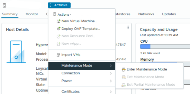

Step 2 : Enable Maintenance Mode (Zerto)
If you are using the Zerto option (Disaster Recovery Plan):
You must first switch the hosts in your cluster to Maintenance Mode before starting the update with vLCM:
Maintenance Mode

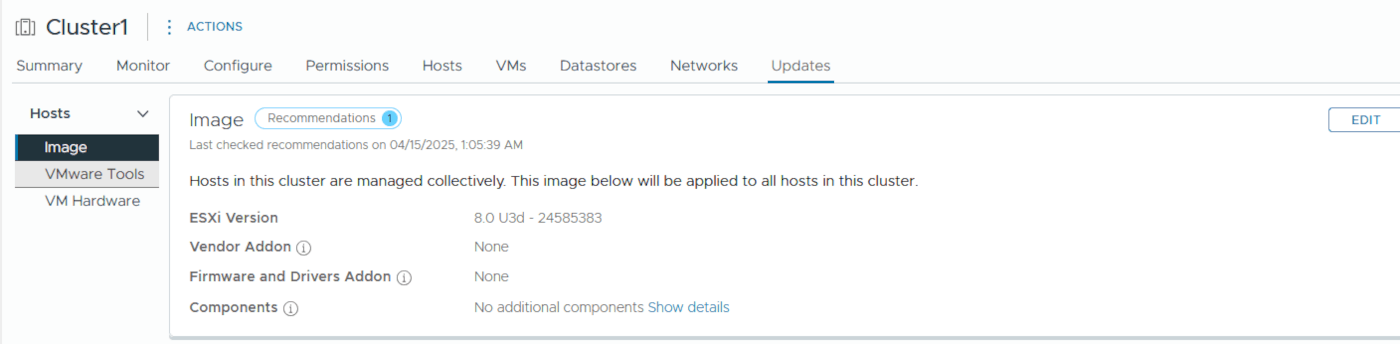

Go to Updates > Hosts > Image to view the current image.
Viewing the current image in vLCM
Click Edit to modify the image.

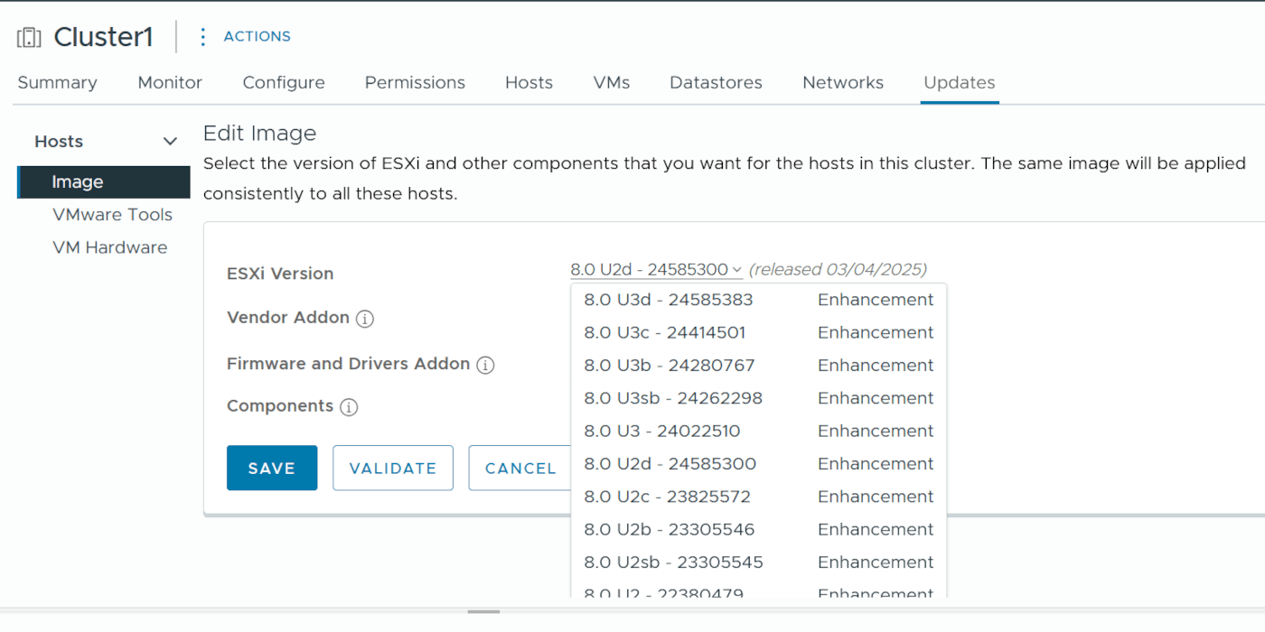

From the dropdown list, select the desired ESXi version. The first option usually corresponds to the latest version published by Broadcom.
Click Save to confirm and save the selected image.
Selecting a new ESXi version
OVHcloud recommends always using the suggested version. Avoid downgrading to a previous version.

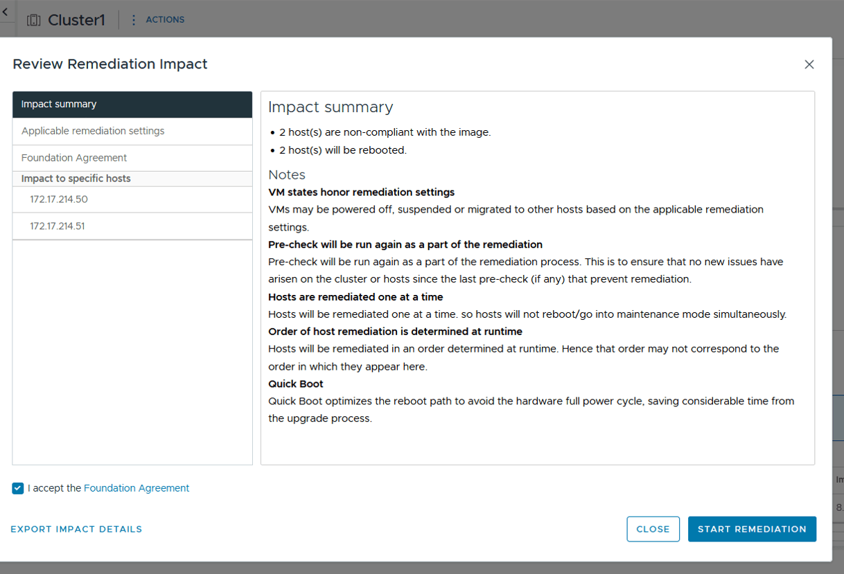

Click Remediate All to apply the image to all hosts in the cluster.
Launching with Remediate All
This action triggers the maintenance mode for the affected hosts. Virtual machines will be automatically moved using vMotion.
Before launching the update, make sure that:
  • The DRS feature is enabled in automatic mode.
  • No anti-affinity rules are preventing virtual machine relocation.
  • No .iso or .vmdk files are stored locally on the hosts.
Click Start Remediation to begin the process.
Start Remediation
The update process is now running. It may take several minutes per host.
