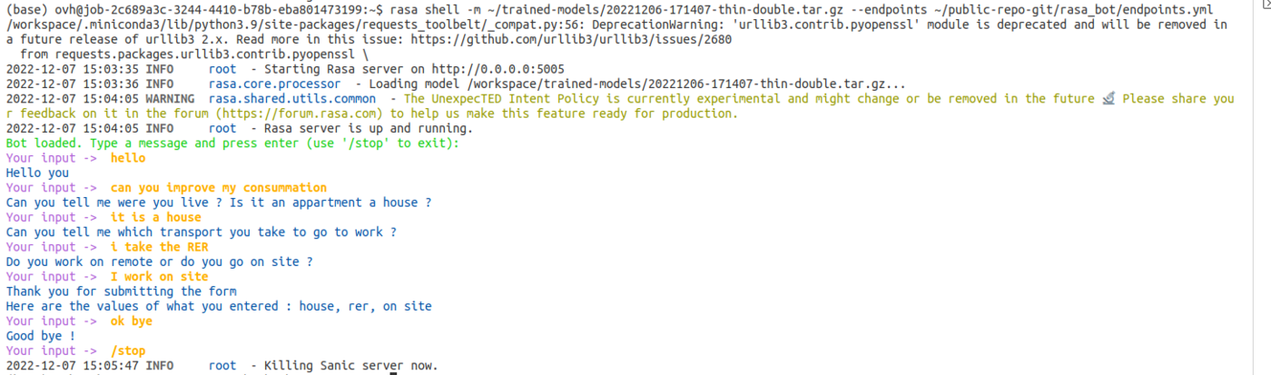

This is a small example of a discussion with the bot :
Terminal session showing a sample discussion with the trained Rasa model
Congrats! You can test your first Rasa model and speak with it. If you have several models in your folder trained-models, you can specify the folder after the option -m and add the specific model you want to train.
