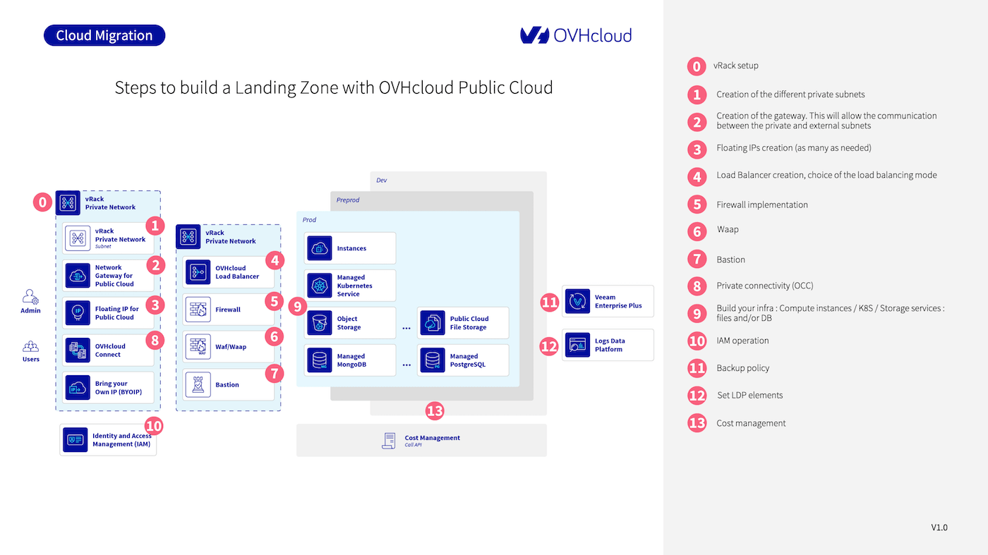

To help you design a secure, scalable, and production-ready cloud foundation, the following diagram illustrates the key steps in building a Landing Zone on the OVHcloud Public Cloud:
Landing zone architecture diagram
Each numbered step corresponds to a component or action in the setup process. Below are detailed explanations for each:
