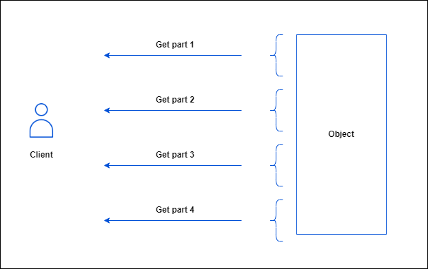

Using byte range fetch
OVHcloud Object Storage supports byte range fetch. This retrieves an object chunk by chunk, with each chunk defined by a byte range. The main advantage is that you can parallelise GET requests to download an object, with each GET requesting a specific range of bytes: typical sizes for byte range requests are 8 MB or 16 MB, but you can specify any size.
Schema 1
To download part of an object, you must use additional parameters to specify which part of the object you want to retrieve. The following example downloads the first part, between 0 and 500 bytes, of an object named <object_key> stored in the <bucket_name> bucket and writes the output to a file named object_part:
aws s3api get-object --bucket <bucket_name> --key <object_key> --range bytes=0-500 object_part

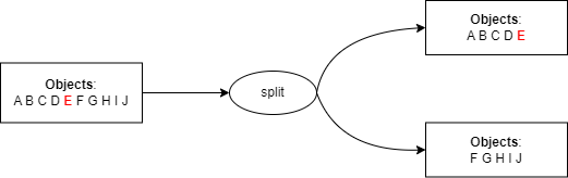

We use the object keys (prefix/name) to determine which objects are pushed into which sub-container using the following logic:
  • Create 2 new shards.
  • Find the median value of an alphabetically sorted list of all object keys.
  • Copy the content of the root container to the shards.
  • In the first shard, keep only the first half of the objects (from the object with the first key in the list to the object with a key equal to the median value) and clean up the second half.
  • In the second shard, keep only the second half of the objects and clean up the first half.
  • The root container then only lists references to the shards i.e which range of objects in which shard.
This logic can be summed up as follows:

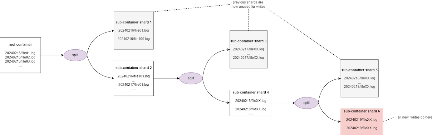

Scenario 1: Bad practice by using the date as prefix
List of objects:
  • 20240216/file01.log
  • 20240216/file02.log
  • 20240216/file03.log
  • 20240217/file01.log
  • 20240217/file02.log
Assuming a threshold of 100, after the 100th object is uploaded, the sharding is triggered to divide the objects into two shards:
  • from 20240216/file01.log to 20240216/file100.log in the first shard
  • from 20240216/file101.log and beyond to a second shard
This solution is not optimal because, since dates are incremental by nature, all new downloads will always be carried out on the second shard, which will be split again when it reaches a critical size. Thus, all future write operations will always be performed on the latest shard created and the previous shards will get rarely accessed. Furthermore, you may experience some throttling during the sharding process.

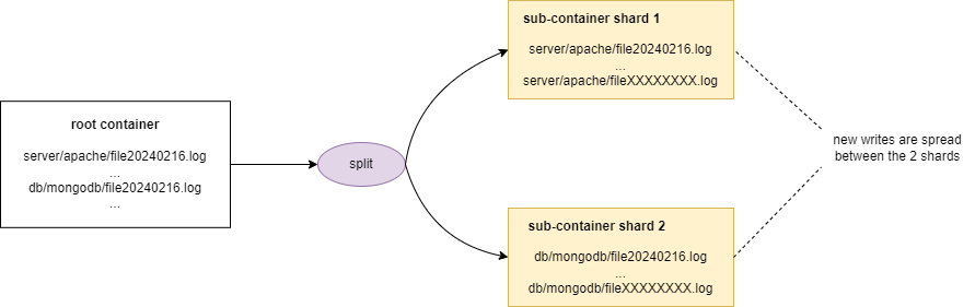

Scenario 2: Good practice by keeping the cardinality to the right
List of objects:
  • server/apache/file20240216.log
  • server/apache/file20240217.log
  • server/apache/file20240218.log
  • db/mongodb/file20240216.log
  • db/mongodb/file20240217.log
Assuming a threshold of 100, after the 100th object is uploaded, the sharding is triggered to split the objects in 2 shards. This 2nd scenario is optimal because all new uploads will be spread on the 2 shards.
