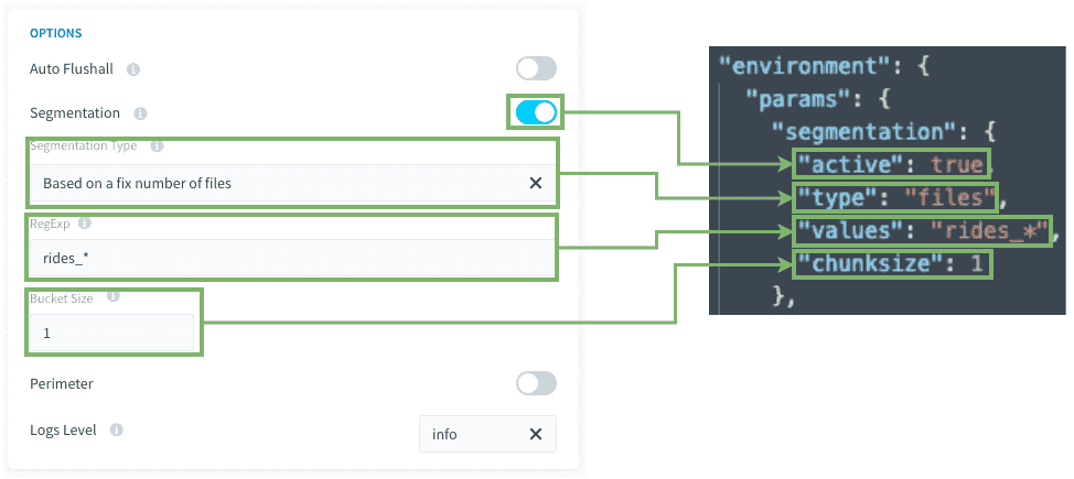

To configure this segmentation option select Based on files in the "Segmentation Type" dropdown.
RegExp / Values: You can set a regexp to identify the filenames you want to get. the star (*) character permit to search for any characters (it will be replaced in the regexp by: .* ). It can be a list of RegExps as well. or a hard-coded list of precise filenames.
Bucket size / Chunksize: Set how many files will be absorbed for each task. it is recommended to set this value to 1, unless you have hundreds of files, you will want to put a higher number of files for each task to keep the number of tasks reasonable (under 100 tasks).
