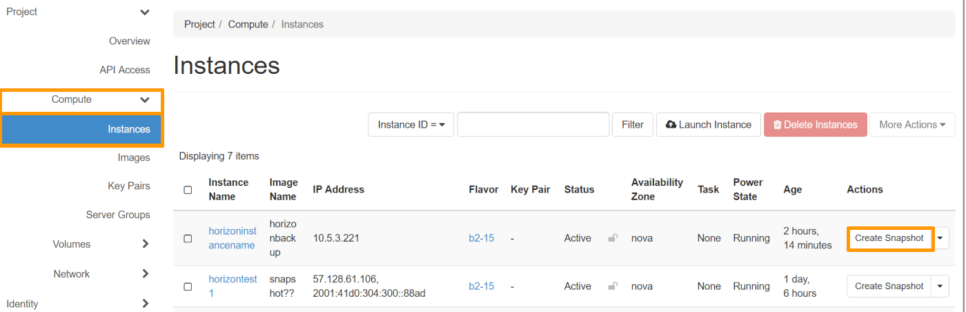

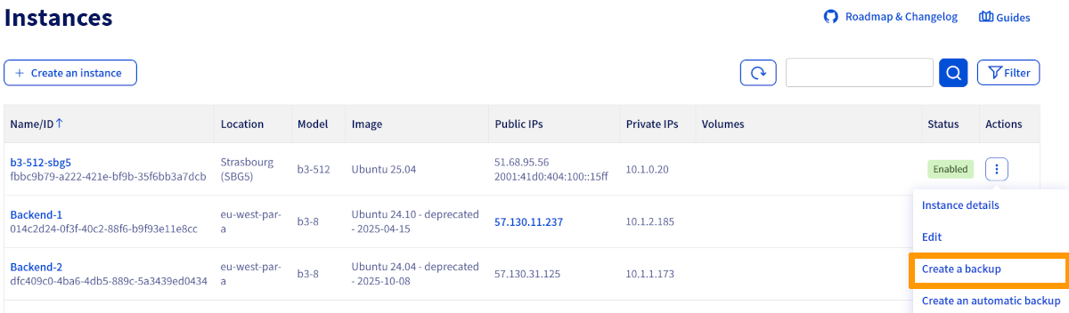

In the left-hand menu of your Public Cloud project, click Instances under Compute.
Click on the ... button to the right of the instance and select Create a snapshot. The snapshot creation page opens with the instance preselected in the Select an instance section.

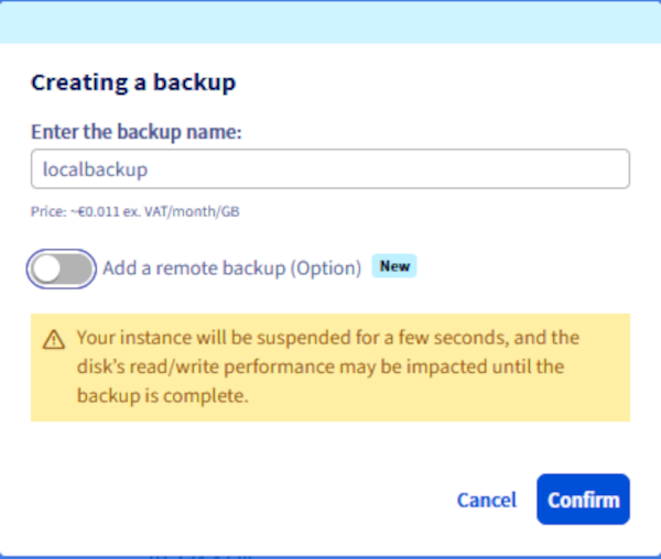

Local snapshot

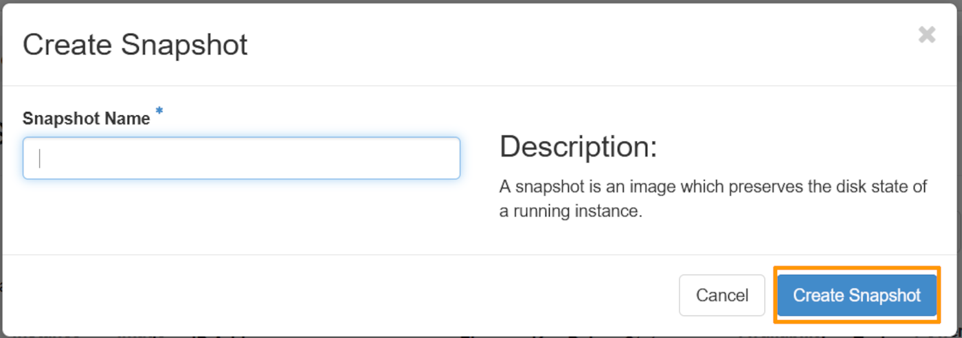

In the Name your snapshot section, enter a name for the snapshot. Review the pricing information and click Create.

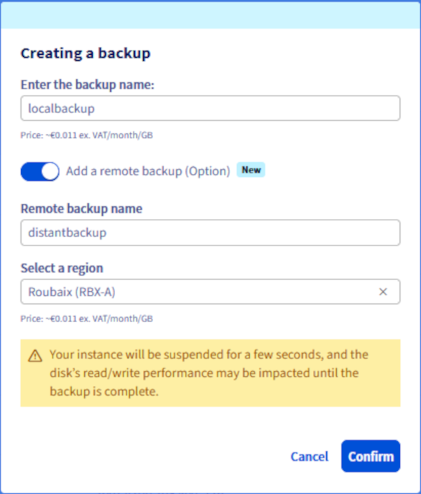

Remote snapshot
In the Name your snapshot section, enter a name for the snapshot. Review the pricing information. Enable Add a remote snapshot (Option), enter a name in the Remote snapshot name field, select a region and click Create.

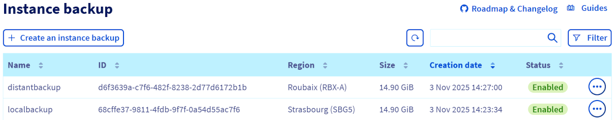

The instance is suspended for a few seconds while the snapshot is taken. It is not possible to monitor the snapshot progress in real time. However, in the Instance snapshots page (Instance Snapshot under Compute in the left-hand menu), the status of the snapshot is displayed during the process.
Once the snapshot is complete, it will be available on the Instance snapshots page and in the Snapshots tab of the instance.

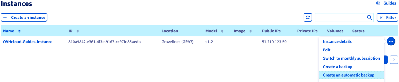

In the left-hand menu of your Public Cloud project, click Instances under Compute. Click on the ... button to the right of the instance and select Create an automatic snapshot.

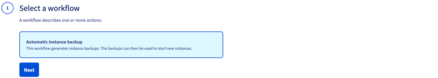

The workflow
The schedule creates an automatic snapshot of the instance and its primary volume. There is no workflow type to choose.

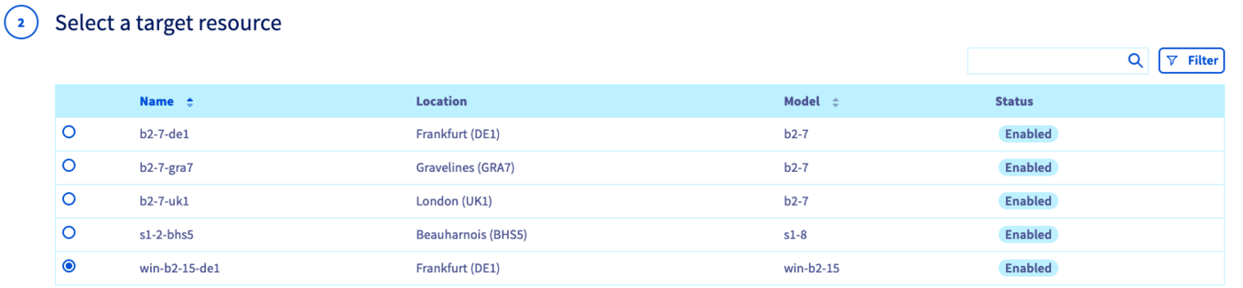

The resource
In the Select a target resource section, you can select the instance to snapshot.

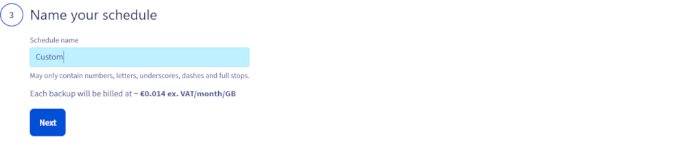

The name
In the Name your schedule section, enter a name for the automatic snapshot schedule. Take note of the pricing information in the summary on the right, then create the schedule with Create.

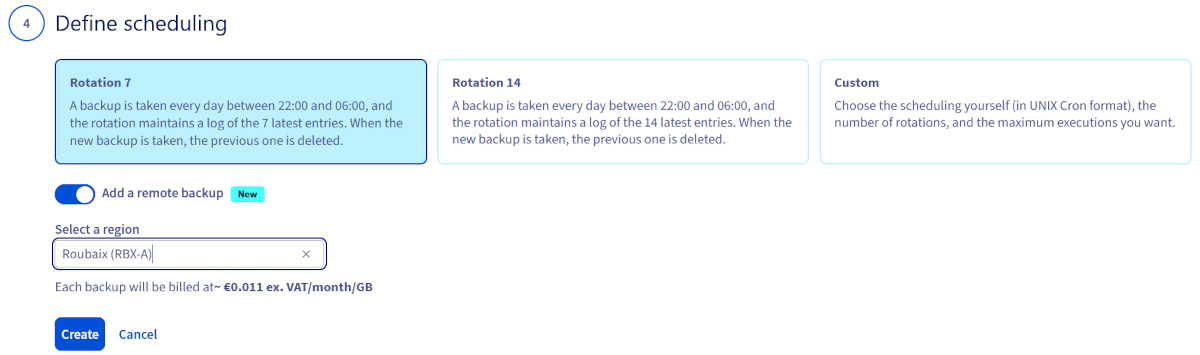

The schedule
In the Define scheduling section, you can set up a custom schedule (Custom, in UNIX cron format, UTC) or choose one of the default frequencies:
- Rotation 7: daily snapshot with retention of the last 7 snapshots
- Rotation 14: daily snapshot with retention of the last 14 snapshots
Adding a remote snapshot
Enable Add a remote snapshot, select a location, review the pricing information, and click the Create button.

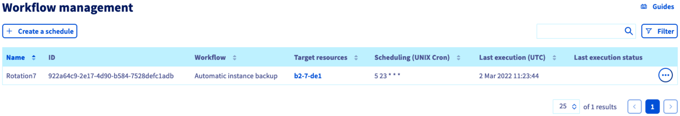

Schedules are listed and deleted on the Workflow management page: click Workflow under Compute in the left-hand menu.

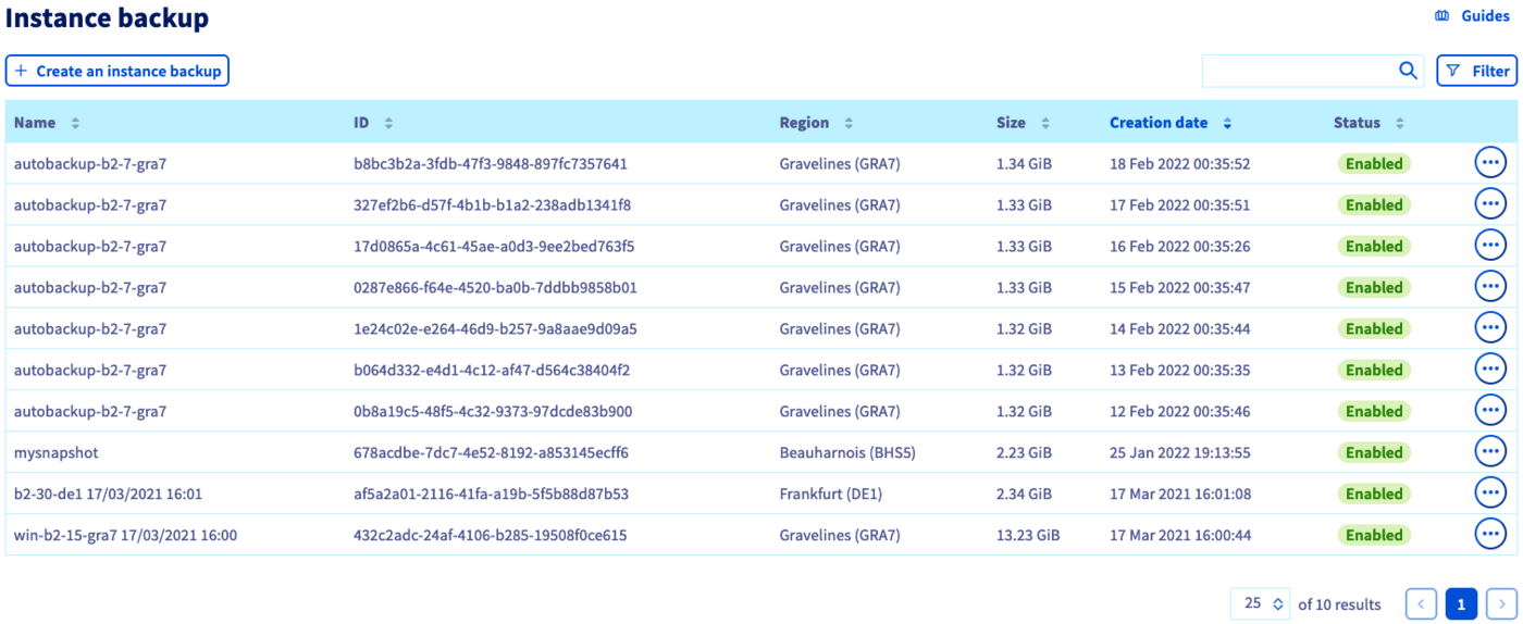

Your instance snapshots are managed on the Instance snapshots page: click Instance Snapshot under Compute in the left-hand menu.
The instance snapshot option must be deleted separately if you no longer wish to be billed for it. Deleting an instance does not delete the options attached to it.
Note that you cannot delete an instance snapshot if an instance that has been spawned from this snapshot is running at the time of the delete action.
