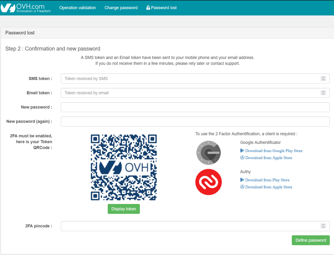

Within the interface, you will then need to:
  • Enter the code received via SMS.
  • Enter the code received by email.
  • Enter a new password.
  • Confirm it.
  • Scan the QRcode with your preferred authentication application.
  • Enter the code you have retrieved.
Finally, click the Define password button.
User information
