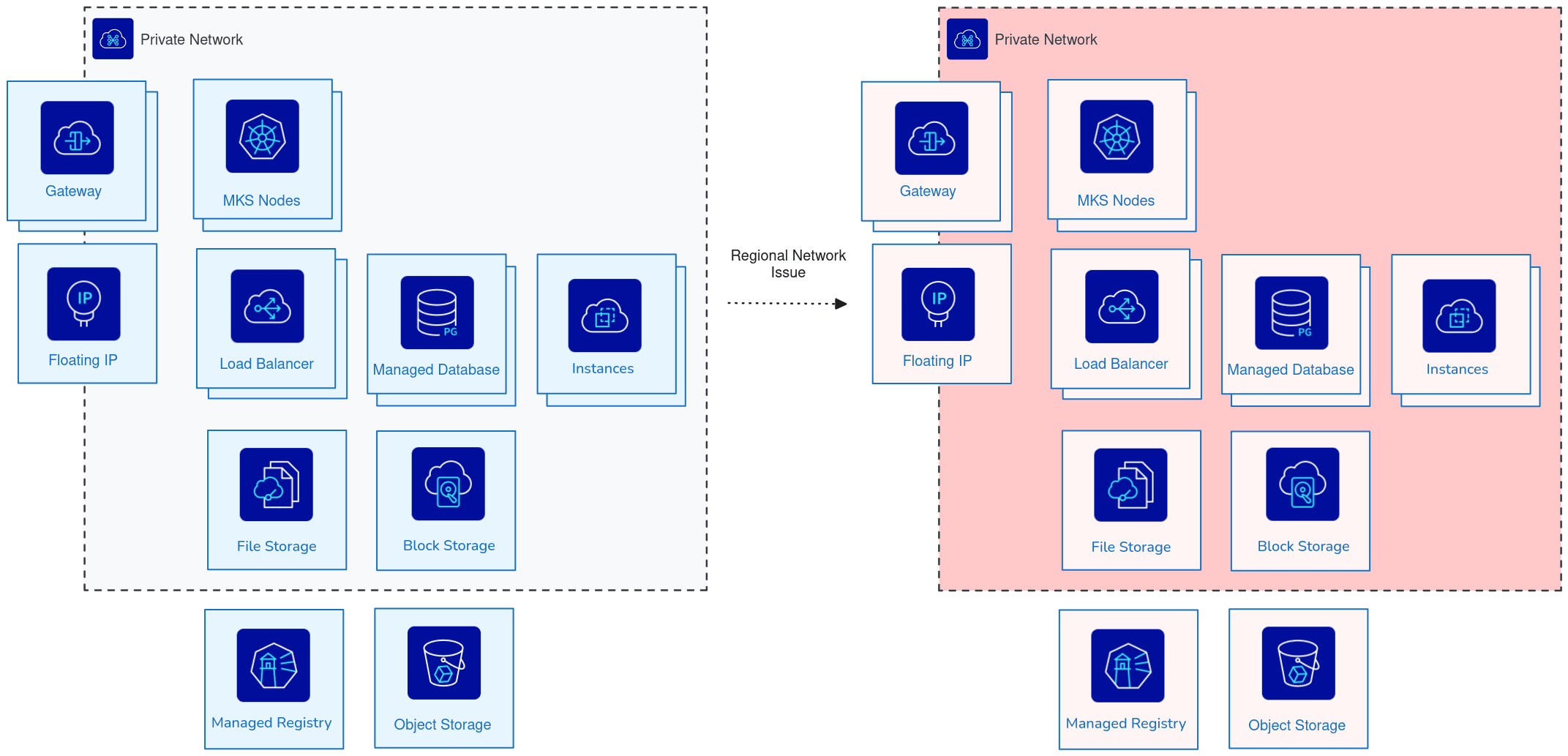

The diagram below shows a typical Public Cloud deployment, and what becomes of it when the region suffers a major network outage:
Regional failure on a Public Cloud region
Every component loses network connectivity at once: instances, Managed Kubernetes Service nodes, gateway, Floating IP, Load Balancer, Managed Databases, Block Storage, File Storage, Managed Private Registry and Object Storage. However much resilience you build inside a single region, the outcome is the same: your service is down.

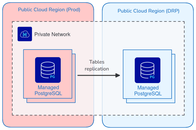

PostgreSQL: tables replication
Public Cloud Databases for PostgreSQL provides a built-in tables replication mechanism, which keeps two databases hosted in two different regions in sync:
PostgreSQL tables replication between two regions
Advantages:
  • The data is already present on the DRP site.
  • Data loss is minimal.
  • The DRP database endpoint is known in advance, since the database already exists.
Drawbacks:
  • Both sides must share the same table schema.
  • Replication is configured table by table, so you have to make sure none is left behind.
  • Cost: you pay for two running databases.

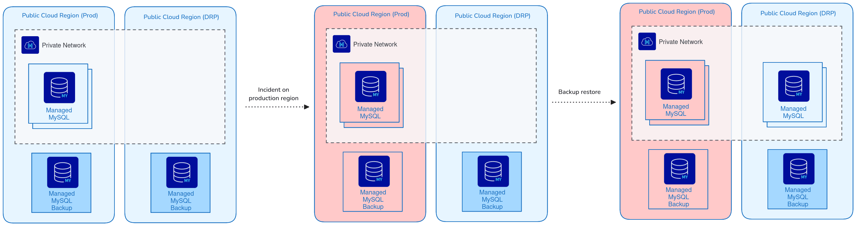

Other database engines: backup/restore
You can also use backup/restore with Public Cloud Databases for PostgreSQL, for instance if you would rather run a single database.
When the engine offers no replication mechanism, backup/restore is the only option. Public Cloud Databases lets you store your backups in two locations, which you set through the OVHcloud API. Choose the region hosting the database, and the region where the DRP database will be created:
Managed database backup and restore in a second region
Advantage:
  • Cost: you only pay for one running database.
Drawbacks:
  • The endpoint of the new DRP database cannot be known in advance.
  • The restore can take a long time, and that time is hard to predict.
To learn more about how your backups are handled, read Automated Backups for Public Cloud Databases and Restore a backup of Public Cloud Databases.

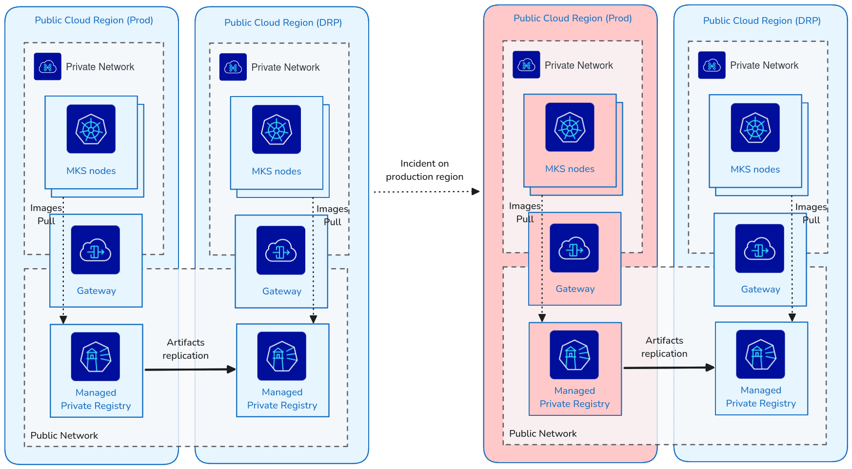

The OVHcloud Managed Private Registry is built on the open source project Harbor. Like Object Storage, it offers built-in asynchronous replication that fits a DRP use case: artifacts pushed to the production registry are replicated to the registry in the DRP region, so the Managed Kubernetes Service clusters of both regions pull the same images.
Artifacts replication between two Managed Private Registries
To create the replication rules, refer to the Harbor replication documentation.
The two registries have different FQDNs. Make sure each site pulls from the right one when you deploy your application.
