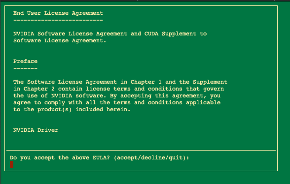

Accepts the process
cuda step 1

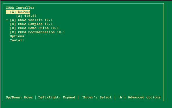

And then select all the components to install
cuda step 2
