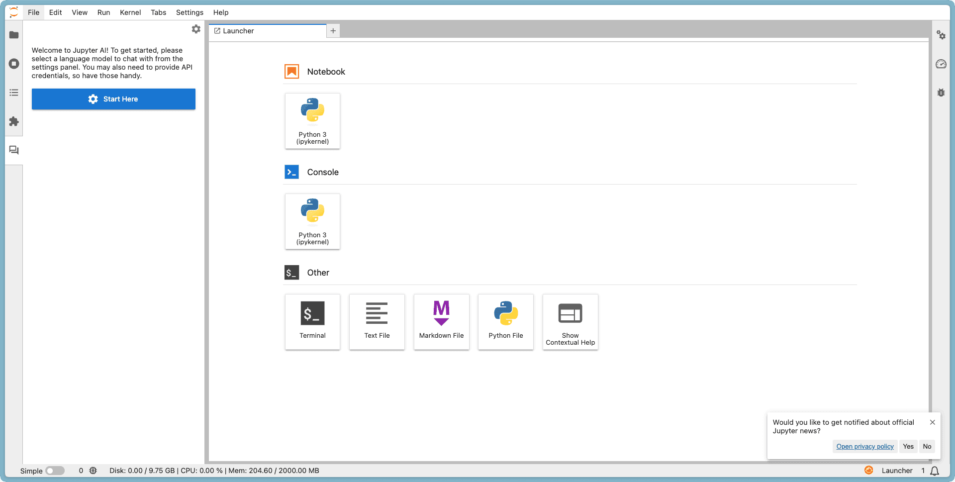

  1. Access Jupyter AI Panel: In your JupyterLab interface, locate and click the "Chat" icon on the left sidebar.
    Jupyter AI
  2. Start Configuration: Click on ⚙️ Start Here within the chat panel to begin the configuration process.

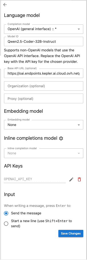

  3. Define Completion Model:
    • 3.1 Completion Model: Select OpenAI (General Interface). This will reveal further configuration settings for the model ID, base URL, and API key.
    • 3.2 Model ID: Enter the ID of your desired model from the AI Endpoints Catalog. For example, let's use Qwen2.5-Coder-32B-Instruct.
    • 3.3 Base API URL: Enter the base URL for your OVH AI Endpoints, such as https://oai.endpoints.kepler.ai.cloud.ovh.net/v1/.
    • 3.4 API Keys: Enter your OVH AI Endpoints API Key in the designated field.
    Jupyter AI
  4. Save and Return: Click Save Changes, and then click the back arrow to return to the Jupyter AI Chat panel. Your Jupyter AI extension is now configured and ready for use.

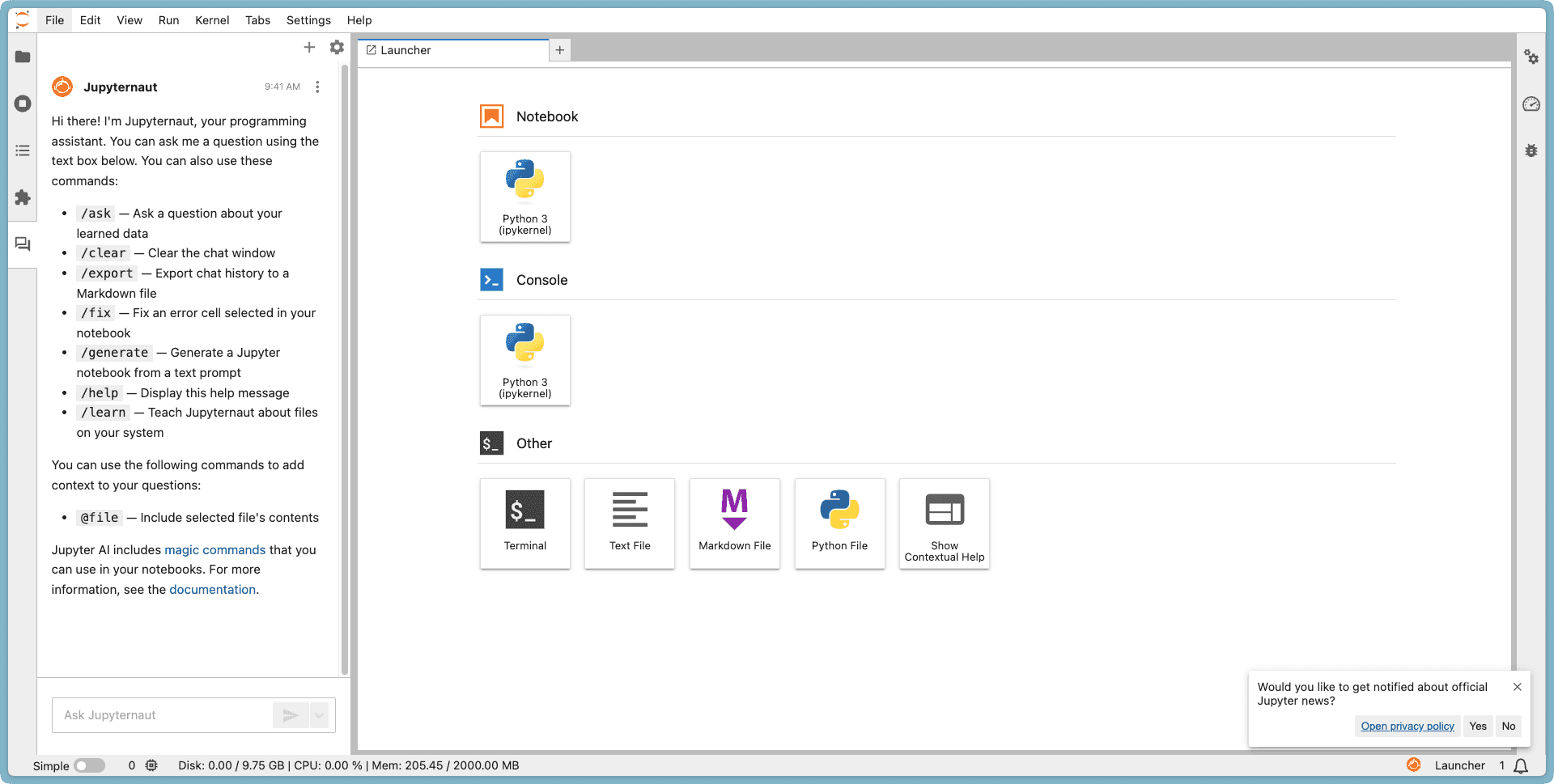

Once your OVH AI Endpoint is configured with Jupyter AI, you can interact with it directly within your notebook environment using the Jupyter AI Chat Panel.

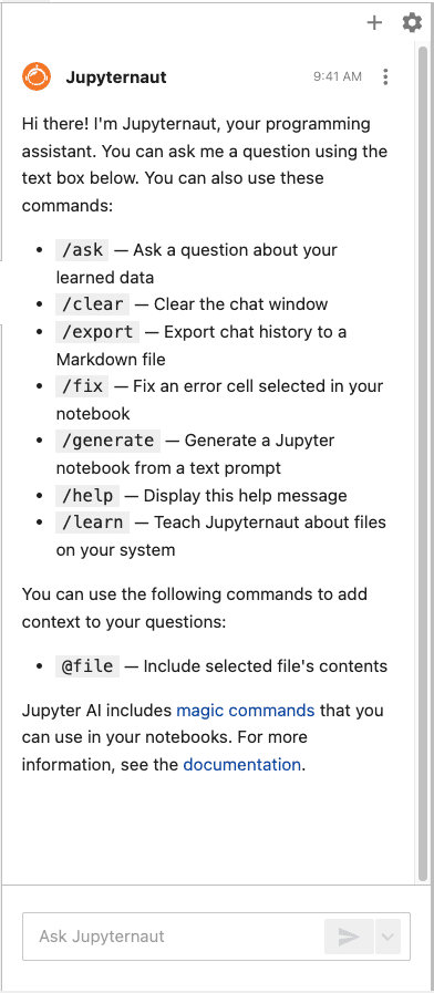

The Jupyter AI chat panel, powered by Jupyternaut, enables conversational interaction directly within JupyterLab. This is your primary interface for interacting with your configured OVH AI Endpoint. You can use it to get programming help, generate notebooks, and much more with ease.
You can:
  • Ask questions about your data or code using the chat box.
  • Generate new Jupyter notebooks from text prompts using the /generate command.
  • Fix errors in selected notebook cells using the /fix command.
  • Export chat history to a Markdown file using the /export command.
  • Teach Jupyternaut about files on your system using the /learn command.
  • Use @file to include selected file contents in your question for more accurate responses, providing context to the AI directly from your files.
For more detailed information on all capabilities, explore the Jupyter AI documentation.

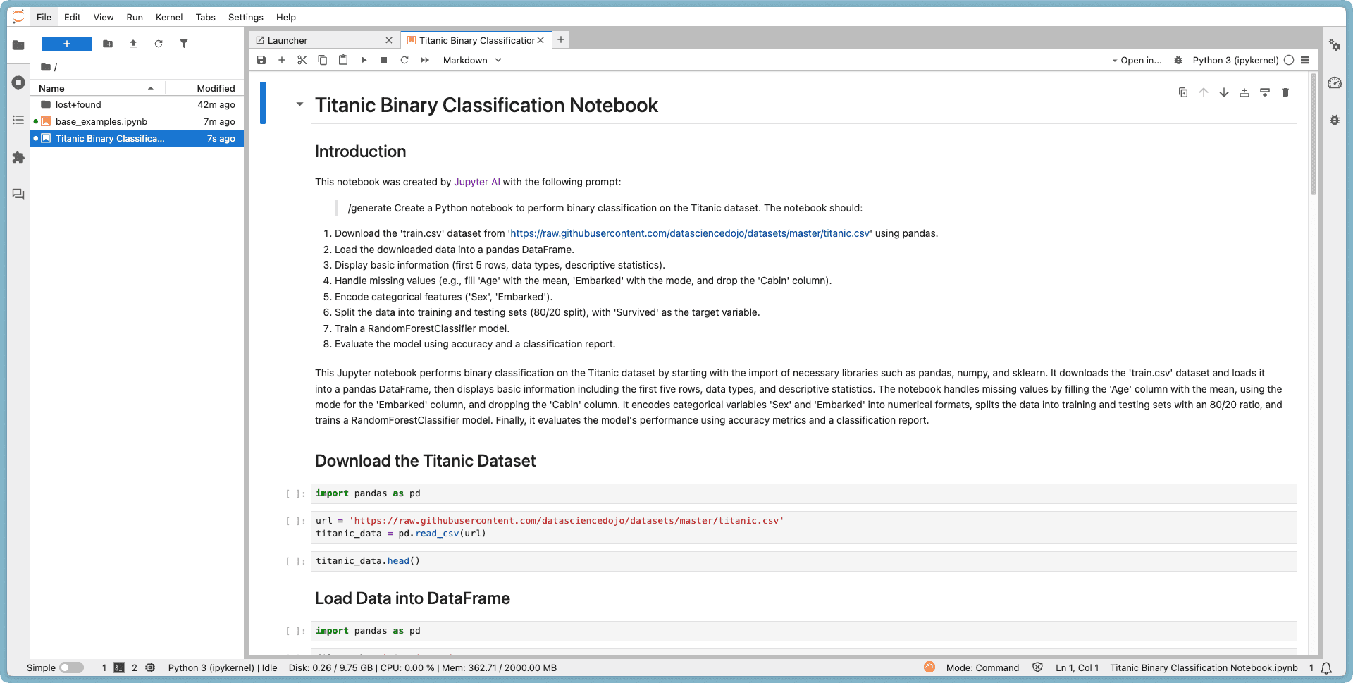

Example Workflow: Generating a Machine Learning Notebook from Kaggle Hub Data
Let's demonstrate a powerful feature: using the /generate command to create a new notebook that fetches data, performs data exploration, and builds a basic machine learning model. For this example, we'll use a commonly available version of the Kaggle Titanic dataset, accessible via a direct URL.
  1. Ensure your Jupyter AI is configured as described in the "Configure Jupyter AI with OVH AI Endpoints" section, using your chosen model (e.g., Qwen2.5-Coder-32B-Instruct).
  2. Open the AI Chat Panel (if not already open) by clicking the "Chat" icon on the left sidebar.
  3. Type the /generate command followed by your detailed prompt into the chat input field:
    /generate Create a Python notebook to perform binary classification on the Titanic dataset. The notebook should:
    1. Download the 'train.csv' dataset from 'https://raw.githubusercontent.com/datasciencedojo/datasets/master/titanic.csv' using pandas.
    2. Load the downloaded data into a pandas DataFrame.
    3. Display basic information (first 5 rows, data types, descriptive statistics).
    4. Handle missing values (e.g., fill 'Age' with the mean, 'Embarked' with the mode, and drop the 'Cabin' column).
    5. Encode categorical features ('Sex', 'Embarked').
    6. Split the data into training and testing sets (80/20 split), with 'Survived' as the target variable.
    7. Train a RandomForestClassifier model.
    8. Evaluate the model using accuracy and a classification report.
  4. Press Enter to send your prompt. Jupyter AI will process your request using the configured OVH AI Endpoint. After a short time, it will generate a new .ipynb file in your current directory (e.g., Titanic Binary Classification Notebook.ipynb), pre-populated with Python code cells performing the requested steps.
  5. Open the generated notebook and run the cells. You can then modify, expand, or debug the code as needed, using the Jupyter AI chat panel for further assistance. This significantly accelerates your data science workflow.
