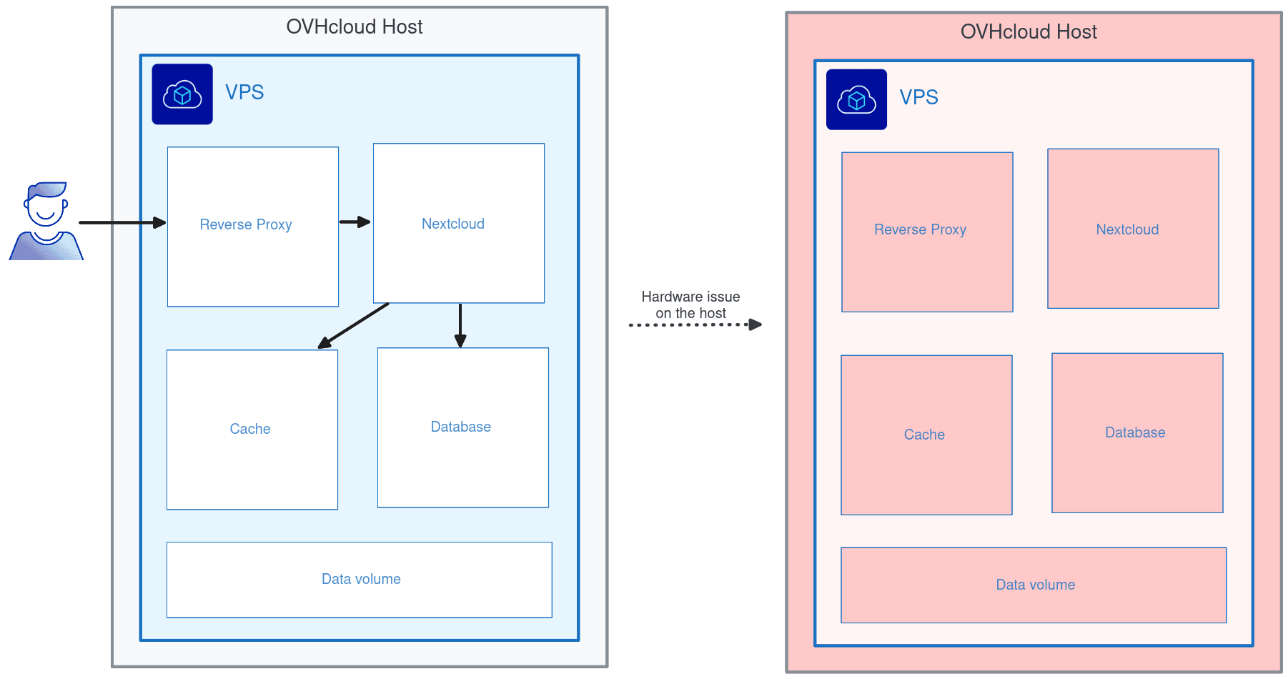

A single-instance deployment fails with its host
The quickest way to deploy Nextcloud is to run every component (reverse proxy, application, cache, database and data volume) on a single Public Cloud instance or VPS. If that instance, or the host running it, fails, Nextcloud goes down with it:
Nextcloud on a single VPS, unavailable after a host failure
The instance stays unavailable until the host is repaired or the instance is restarted on another host. For the whole of that time, your end users have no access to the service.

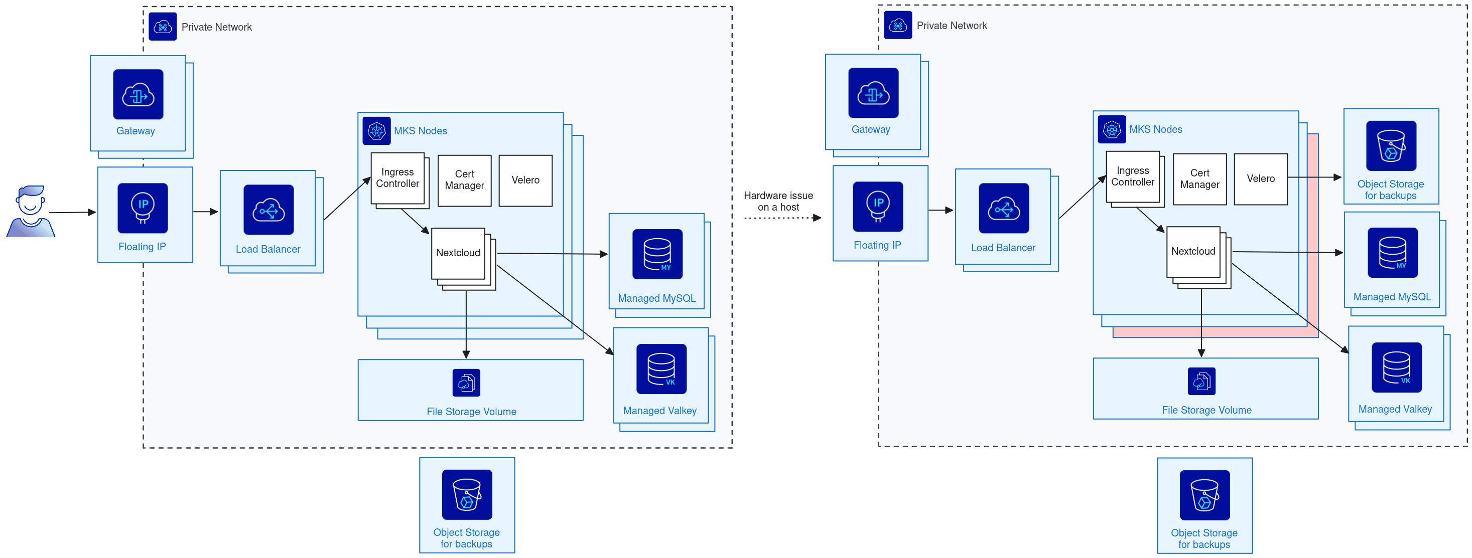

A resilient deployment survives the loss of a node
Nextcloud can be deployed in a far more resilient way: by making each application component highly available (database, cache, Nextcloud itself), and by making the underlying infrastructure redundant as well (several instances spread over different hosts, redundant ingress).
The following Public Cloud products cover these needs:
  • A Managed Kubernetes Service (MKS) cluster to run Nextcloud
  • A Managed Databases cluster for PostgreSQL or MySQL
  • A Public Cloud File Storage volume, shared between the Nextcloud replicas
  • A Public Cloud Load Balancer for the ingress traffic
  • A Public Cloud Gateway to expose the load balancer publicly
The resulting infrastructure looks like this:
Resilient Nextcloud deployment surviving the loss of an MKS node
Here the host running one of the MKS nodes crashes. Because the infrastructure was designed for that risk, Nextcloud keeps running and end users keep working.

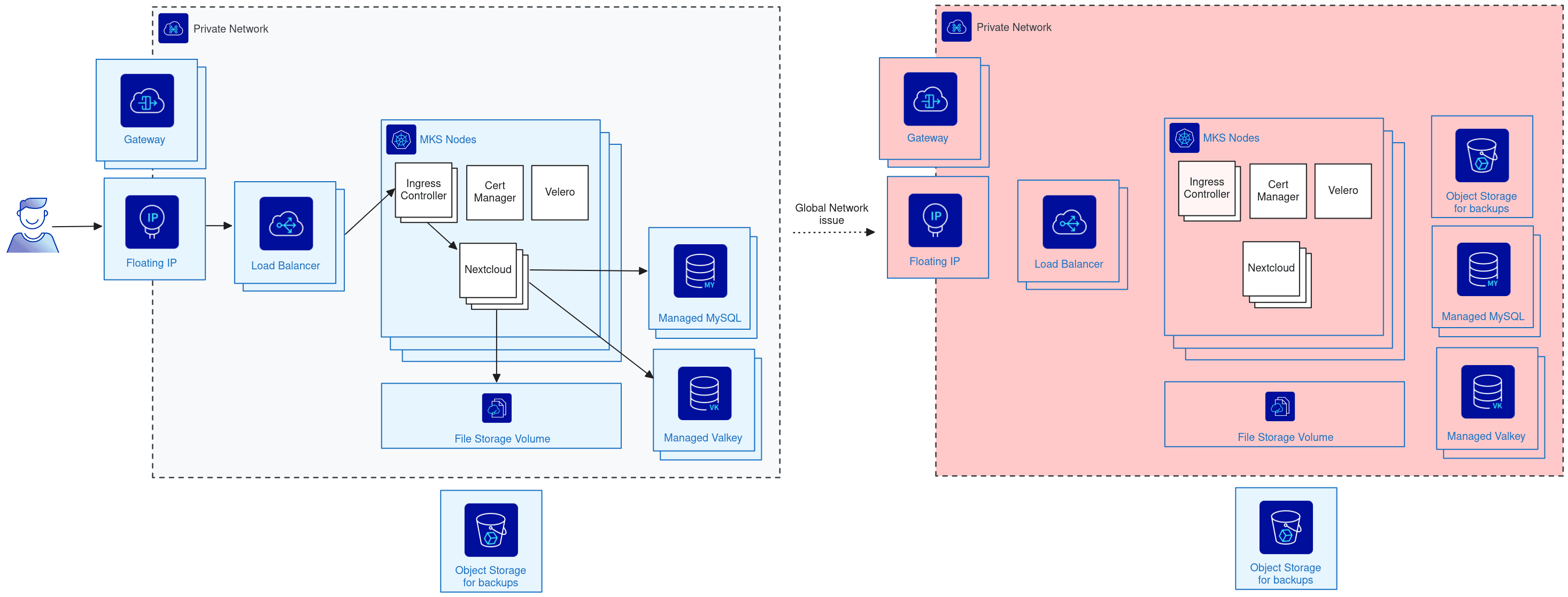

Surviving the loss of a region
A resilient deployment still lives in a single location, and that location can fail as a whole, during a major Public Cloud network outage, for example:
Regional network outage taking down the whole deployment
Every component loses network connectivity at once and Nextcloud becomes unreachable. This is what a disaster recovery site protects against. Building one raises three questions, each answered below: how to handle ingress on two sites, how to keep the database in sync, and how to replicate the end-user files.

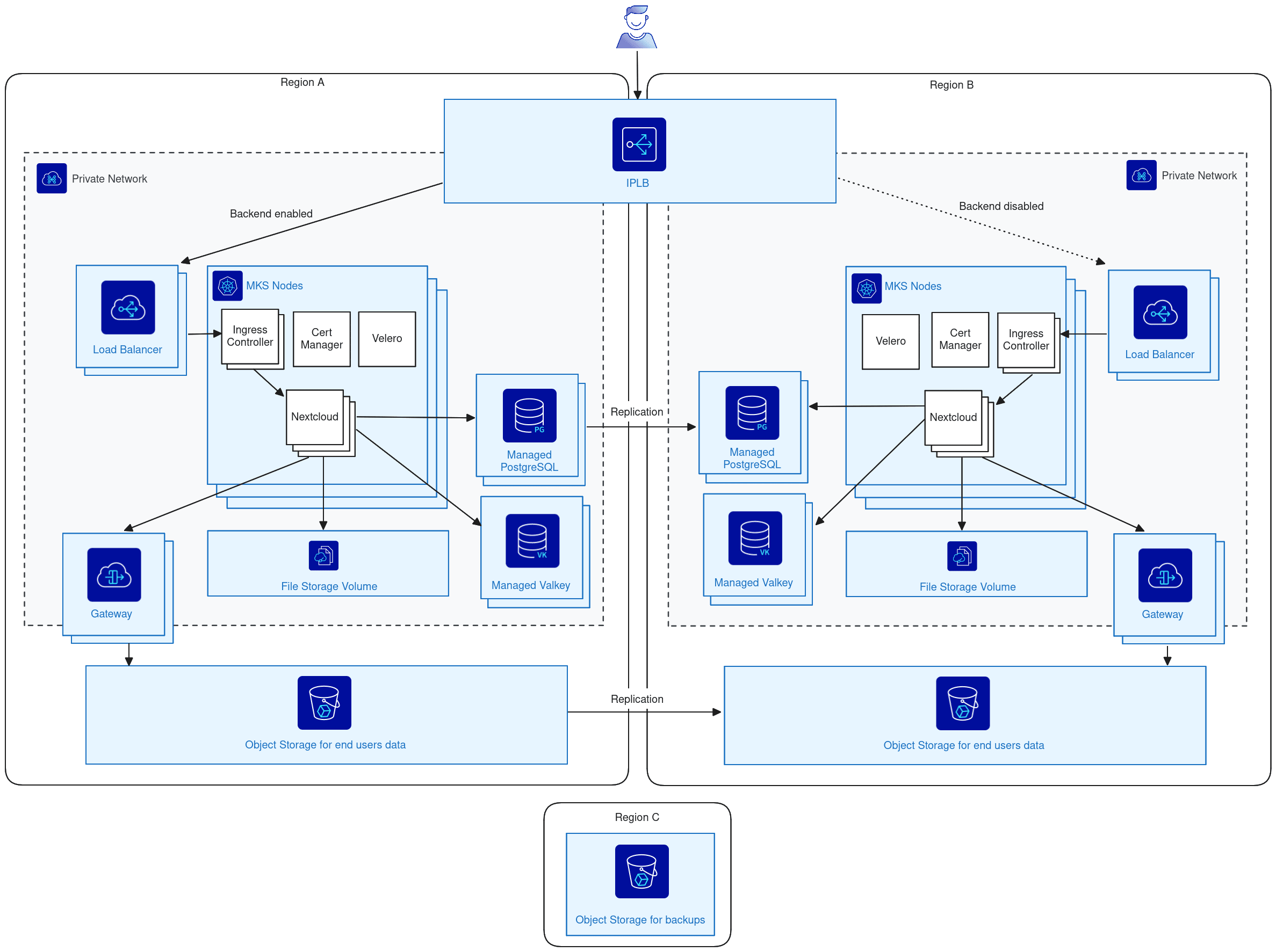

Target architecture
Putting it together gives the following two-region architecture. Region A serves the traffic, region B holds a fully provisioned standby, and a third region hosts the backup bucket:
Two-region Nextcloud architecture with an IP Load Balancer

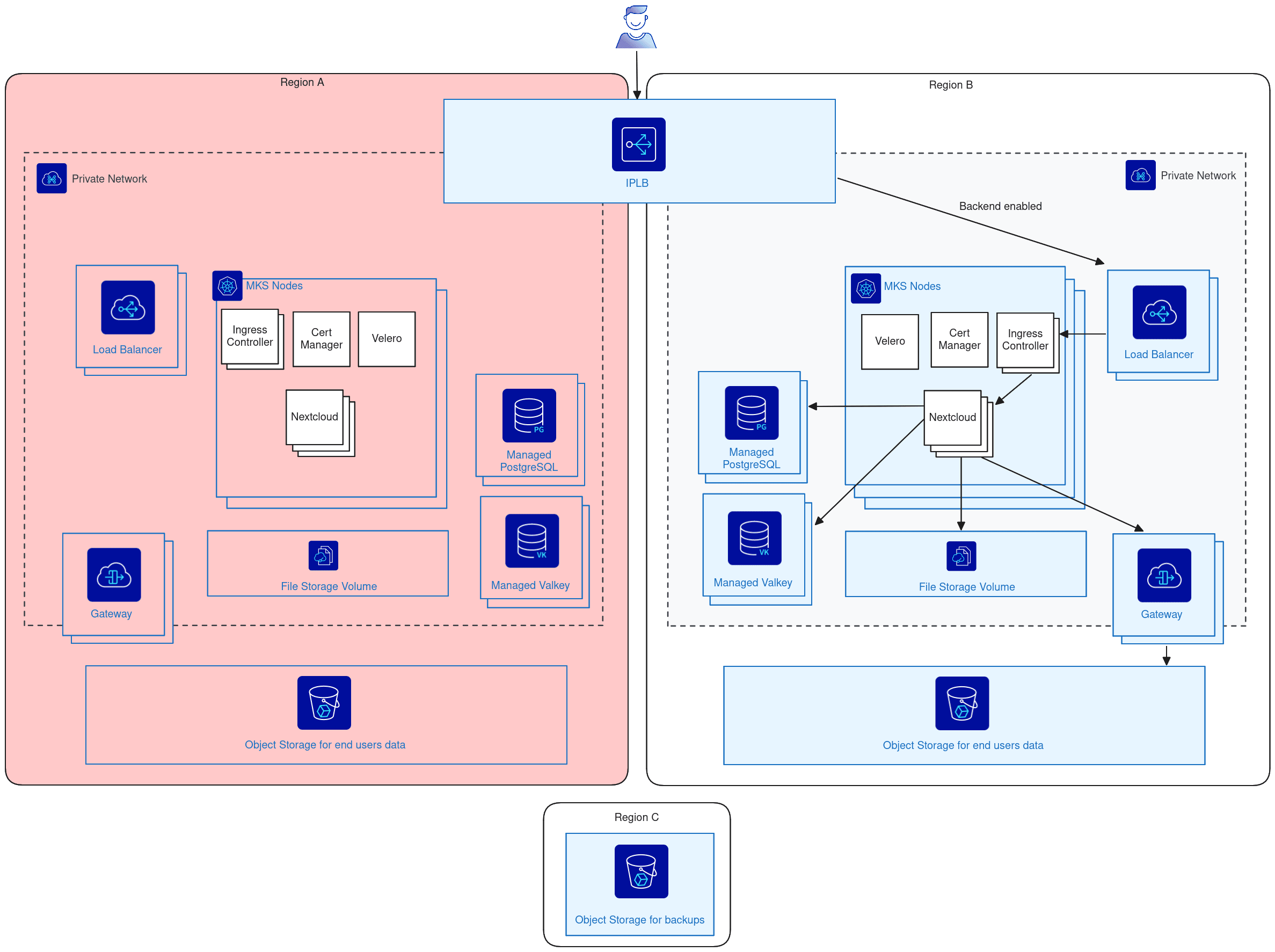

If region A fails, traffic is redirected to the infrastructure already provisioned in region B:
Failover to the disaster recovery region

IP Load Balancer
Order an IP Load Balancer Pack 2, then configure it from the OVHcloud Console.
Serving backends located in two regions relies on a multi-zone configuration, described in How to configure the OVHcloud Load Balancer in multiple zones.
vRack configuration
Place the IP Load Balancer in the same vRack as your Public Cloud project, as described in Configuring the vRack on the load balancer, then configure its private network:
  1. In the OVHcloud Console, open Bare Metal Cloud, then Load Balancer, and click the name of your IP Load Balancer.
  2. Click the Network tab.
  3. In the Private Networks section, click Add Private Network.
  4. Fill in the fields with the following values. The Display name field is optional.
    ParameterValue
    VLAN1
    Subnet (CIDR)10.1.0.0/16
    NAT IP10.1.254.0/24
  5. Click Add Private Network.
Server farm
In the Server farms tab of the IP Load Balancer, click Create farm and use the following parameters, then click Create Farm:
ParameterValue
ProtocolTCP
Port443
ZoneALL
Private NetworkID of your private network
Retrieve the external IP address of the Public Cloud Load Balancer of each cluster:
kubectl --kubeconfig $KUBECONFIG_PROD get svc -n haproxy-controller \
  -o jsonpath='{.items[0].status.loadBalancer.ingress[0].ip}'
kubectl --kubeconfig $KUBECONFIG_DRP get svc -n haproxy-controller \
Add both as servers of the farm, replacing <EXTERNAL_IP_PUBLIC_CLOUD_LB_PROD> and <EXTERNAL_IP_PUBLIC_CLOUD_LB_DRP> with the two addresses returned above. For each server, in the Server farms tab, click Add server on the farm you created, fill in the fields, then click Add Server:
Display nameAddressPort
prod<EXTERNAL_IP_PUBLIC_CLOUD_LB_PROD>443
drp<EXTERNAL_IP_PUBLIC_CLOUD_LB_DRP>443
Then disable the drp server, so that only the production site receives traffic:
  1. In the Server farms tab, open the Servers list of the farm.
  2. In the drp row, open the menu in the Actions column and click Edit.
  3. In the Traffic section, set Status to Inactive.
  4. Click Save Changes.
Frontend
In the Frontends tab of the IP Load Balancer, click Create frontend and use the following parameters, then click Create Frontend:
ParameterValue
ProtocolTCP
Port443
ZoneALL
Routing > Default route > Route to farmThe farm created above, selected in the farm list
Apply the IP Load Balancer configuration to make it effective: in the Overview tab, click Apply in the Deployment field. The button label carries the number of pending changes, for example Apply 3 changes.
DNS record
Create a nextcloud A record in your DNS zone, pointing to the public IP address of the IP Load Balancer.

Failing over from GRA11 to SBG5
The recovery site is now fully provisioned and kept in sync. Failing over means reversing the direction of the two replications and switching the IP Load Balancer backend.
Failover
Simulate an incident by scaling the production deployment down to zero:
kubectl --kubeconfig $KUBECONFIG_PROD scale deploy/nextcloud --replicas=0 -n nextcloud
Stop the replication from the production database to the recovery database, through the recovery bastion:
ssh ubuntu@$BASTION_IP_DRP "PGPASSWORD=$PG_PASS_DRP psql -h $PG_HOST_DRP -p $PG_PORT_DRP -U avnadmin -d nextcloud -c \"SELECT * FROM aiven_extras.pg_drop_subscription('dest_subscription', FALSE);\""
Start the replication in the opposite direction, from the recovery database to the production one:
ssh ubuntu@$BASTION_IP_DRP "PGPASSWORD='$PG_PASS_PROD' psql -h '$PG_HOST_PROD' -p '$PG_PORT_PROD' -U avnadmin -d nextcloud -c \"SELECT * FROM aiven_extras.pg_create_subscription('dest_subscription', 'host=$PG_HOST_DRP password=$PG_PASS_DRP port=$PG_PORT_DRP dbname=nextcloud user=avnadmin', 'pub_source_tables', 'dest_slot', TRUE, TRUE);\""
Then, in the OVHcloud Console:
  1. Disable the replication rule on the production Object Storage bucket.
  2. Enable the replication rule on the DRP Object Storage bucket.
  3. Disable the prod backend server in the IP Load Balancer.
  4. Enable the drp backend server in the IP Load Balancer.
To change the status of a replication rule (steps 1 and 2):
  1. In your Public Cloud project, open Storage, then Object Storage, and click the bucket name.
  2. Click the Replication tab, then click the rule name.
  3. In the Edit replication rule panel, set Status to Disabled or Enabled.
  4. Click Save.
To change the status of a backend server (steps 3 and 4):
  1. In the Server farms tab of the IP Load Balancer, open the Servers list of the farm.
  2. In the server row, open the menu in the Actions column and click Edit.
  3. In the Traffic section, set Status to Inactive or Active.
  5. Once both servers are changed, click Apply in the Deployment field of the Overview tab. The button label carries the number of pending changes, for example Apply 2 changes.
Nextcloud is now served from SBG5, on the same URL.
