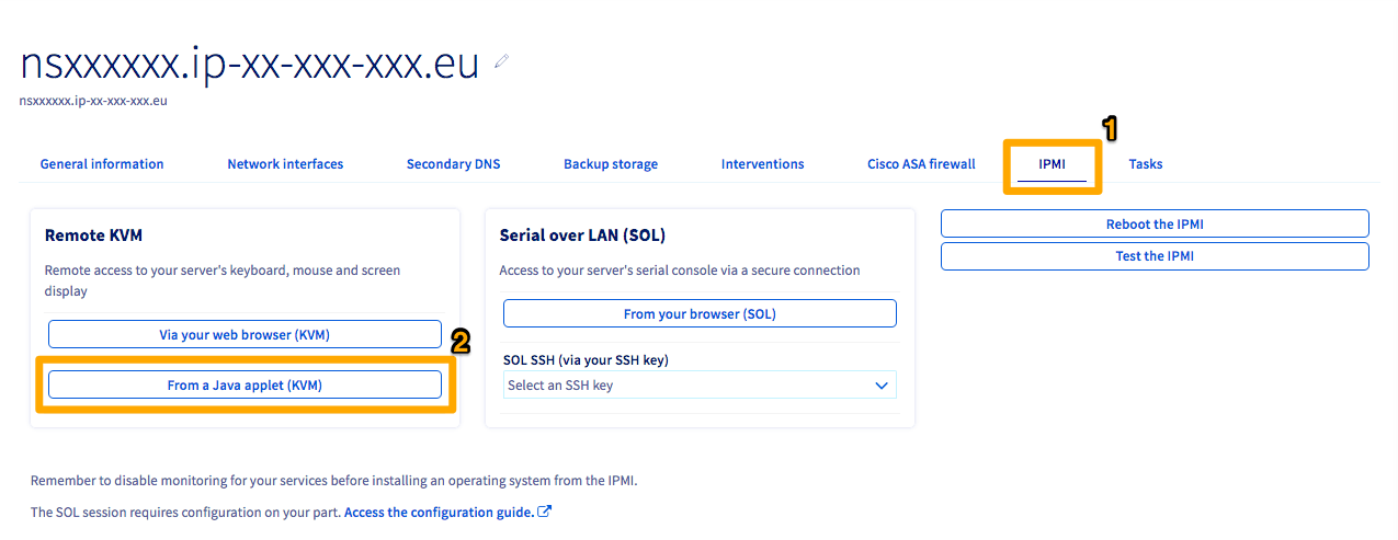

If you are configuring a fully-private aggregation (OLA), the server will no longer have public connectivity and you will be unable to SSH into it. In any case, your connection may drop while the bond is being configured, so we recommend using the IPMI/KVM console to access the server.
Click the IPMI tab (1).
Next, click the From a Java applet (KVM) button (2).
remote kvm
A JNLP program will download. Open the program to enter the IPMI. Log in using valid credentials for the server.
