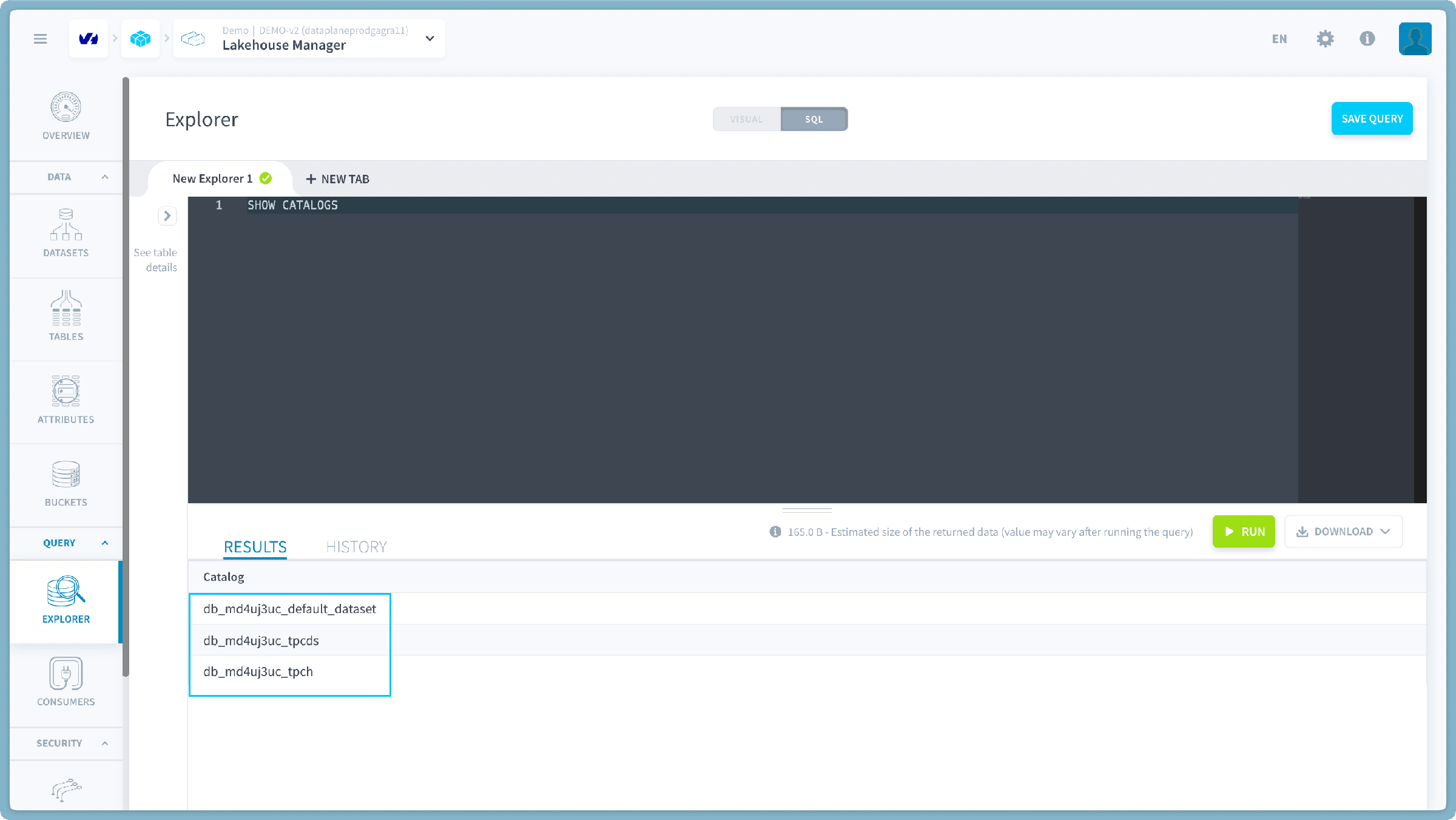

  1. Identify Source Catalog and Schema: Find the catalog and schema you intend to connect to in Lakehouse Manager Explorer
    Execute the following SQL commands to retrieve the available catalogs and schemas:
    SHOW CATALOGS
    Copy and save the desired catalog name as CATALOG_NAME.

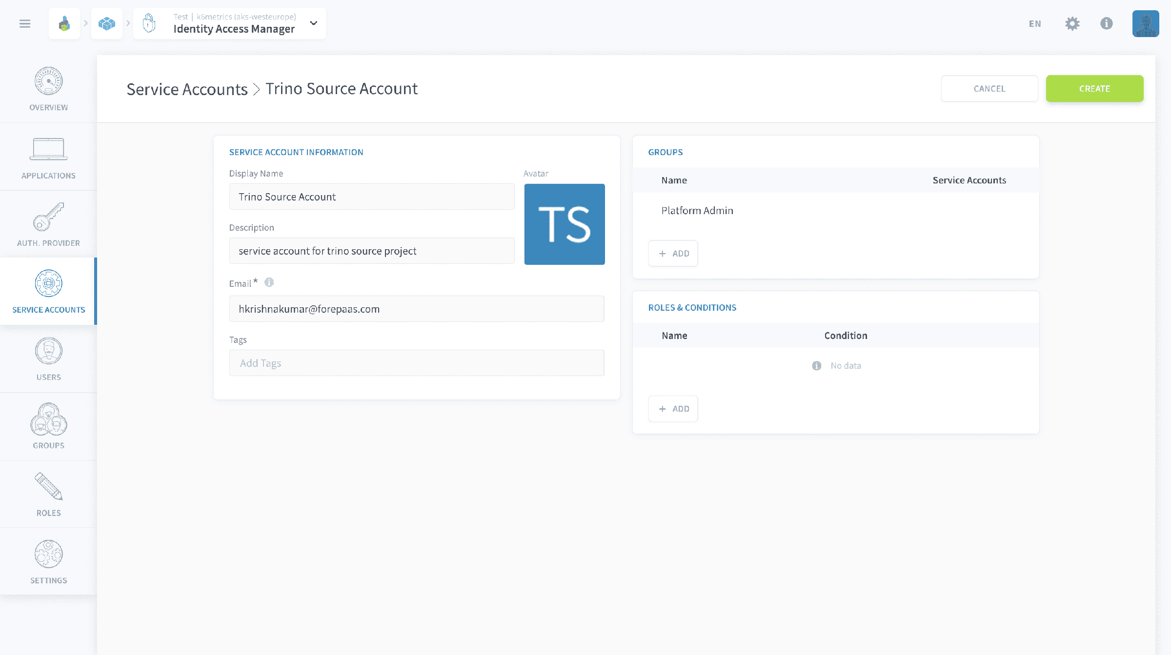

  1. Open the Identity Access Manager and create a new service account for the purpose of this transfer.
    Steps to Follow at the Source Project — Trino connector service account
Make sure to add Platform Admin as the group for this service account

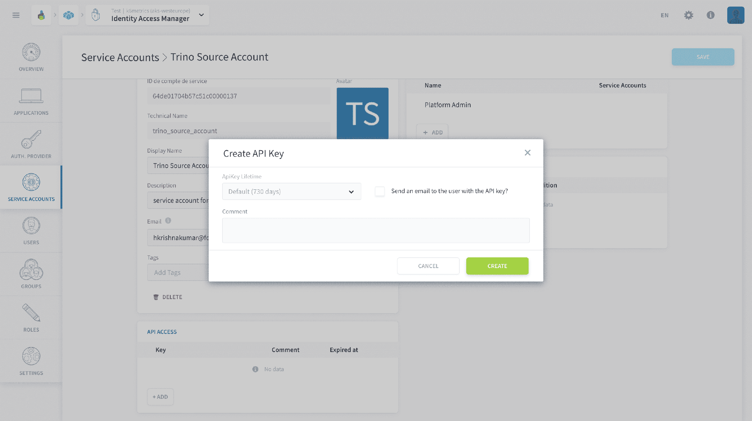

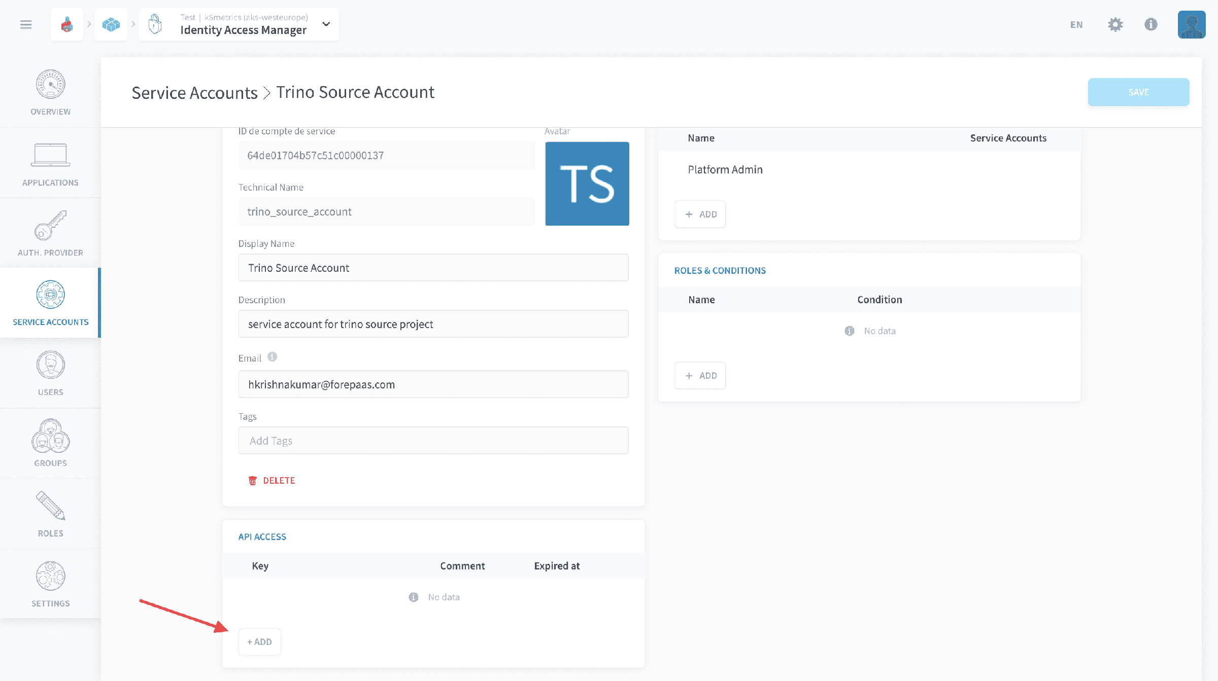

Once the service account has been successfully create, you need to generate a key for the API Access. Click on the add button as shown in the picture below, followed by create.
Steps to Follow at the Source Project — Trino connector service account (2) Steps to Follow at the Source Project — Trino connector create api key

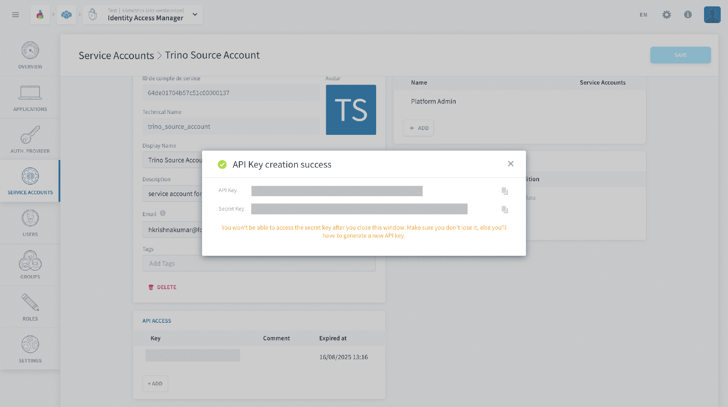

You will be provided with the API Key and the Secret Key. Make sure to copy and save them securely as you wont be able to access the Secret Key once you leave this page.
Steps to Follow at the Source Project — Trino connector created api key

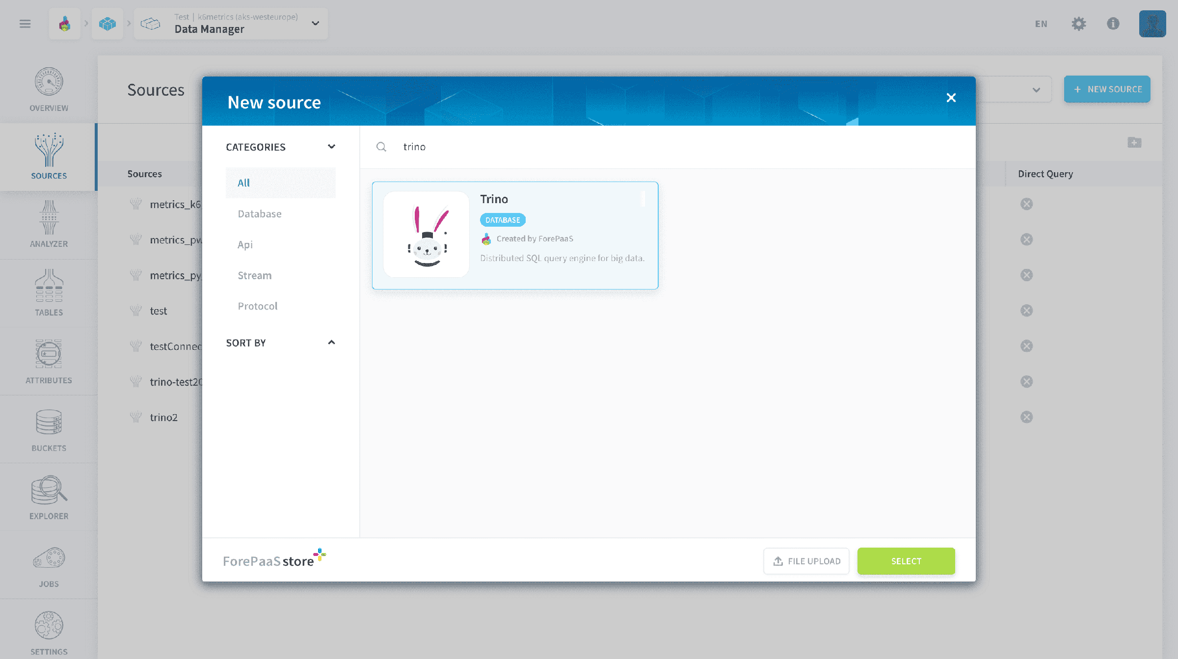

  1. Proceed to the Connectors and add a new Trino Source.
Steps to follow at destination project — Trino connector add source

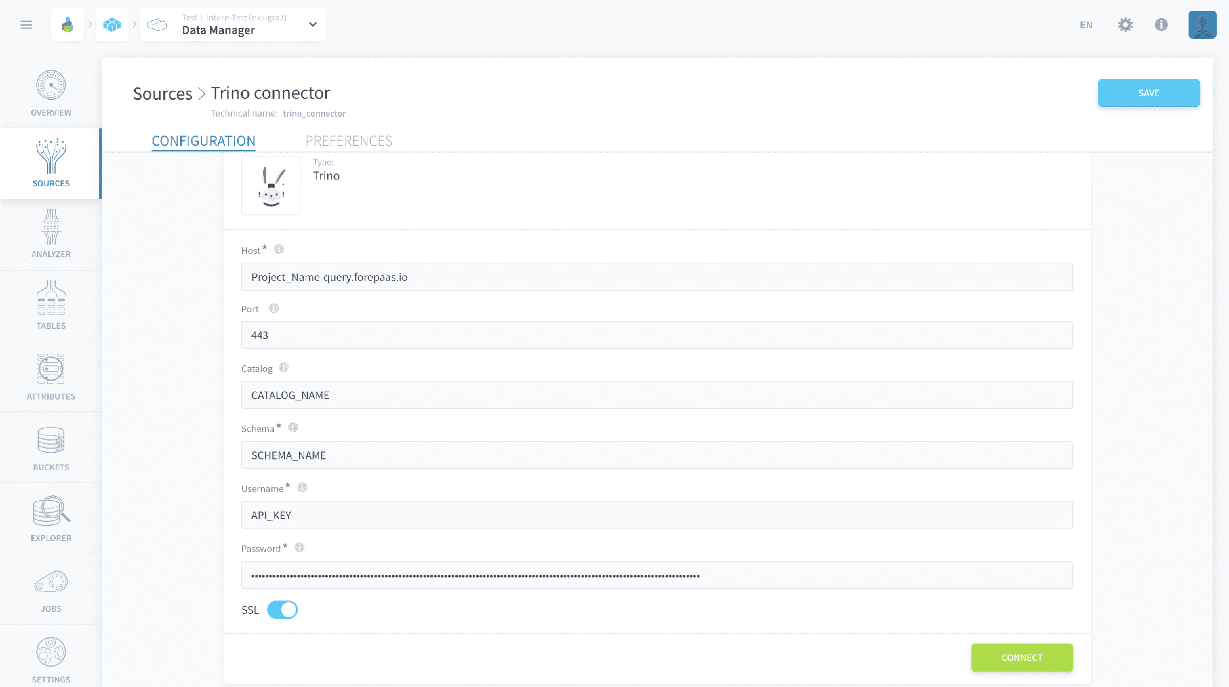

  1. Fill in the details as given below and click on connect
  • Host: replace by your source Project_Name + -query.eu.dataplatform.ovh.net
  • Port: 443
  • Catalog: replace with your CATALOG_NAME
  • Schema: replace with your SCHEMA_NAME
  • Username: replace with API_KEY
  • Password: replace with SECRET_KEY
  • SSL: activated
Steps to follow at destination project — Trino connector source settings

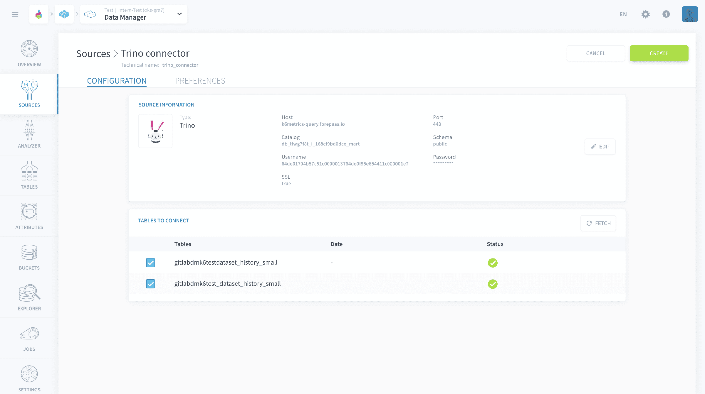

  1. Once the Trino Connection has been successfully established, the list of available tables will be populated. Click on the box next to table name you desire to extract from the source and click create.
Steps to follow at destination project — Trino connector source connected
