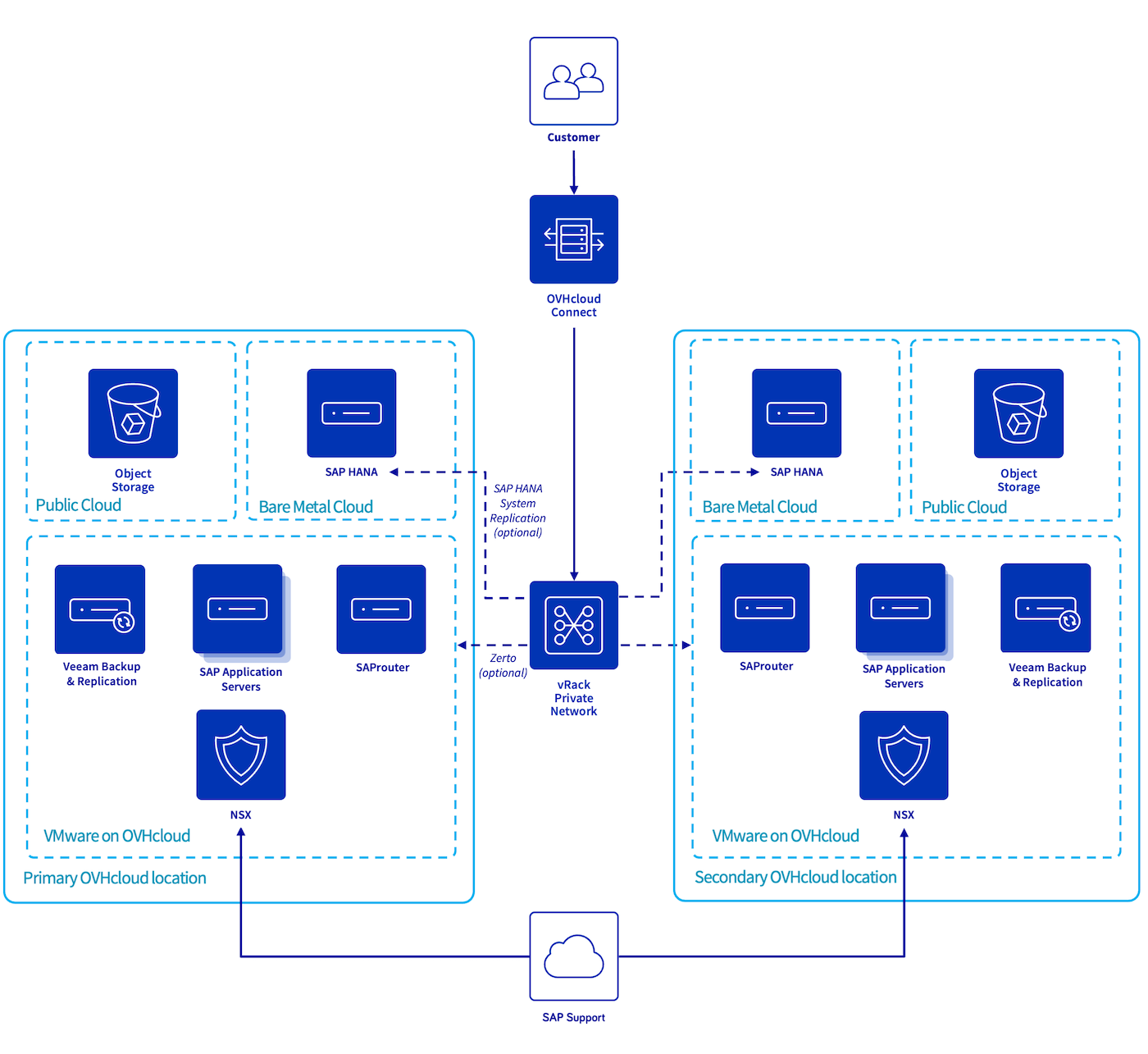

This concept page demonstrates a hybrid architecture using a HGR-SAP dedicated server and VMware on OVHcloud
The following concept allows you to build an architecture with a SAP HANA database up to 1.5 TB, and takes advantage of all VMware on OVHcloud features (OVA templates, Zerto, NSX, DRS, Fault Tolerance, High Availability) for your SAP Application Servers in a single OVHcloud location or multiple OVHcloud locations.
schema
ObjectiveDescription
Objective #1Building a cost-effective SAP infrastructure based on existing VMware on OVHcloud for application servers and dedicated servers to host SAP HANA databases.
Objective #2No compliance requirements with any SecNumCloud qualification or PCI DSS certification.
Objective #3An infrastructure Recovery Point Objective (RPO) of 15 minutes.
Objective #4 (optional)An SAP infrastructure available in a secondary OVHcloud location which can be activated in the event of a major issue impacting the primary OVHcloud location. This secondary OVHcloud location offers an infrastructure RPO near to zero.

7 - Dual OVHcloud location (optional)
To eliminate the risk of losing a single OVHcloud location deployment, consider adding a secondary OVHcloud location.
7.1 - Network connectivity
As with the primary OVHcloud location, we recommend using OVHcloud Connect. If this solution is not suitable for you, a point-to-point VPN can be deployed with NSX for the second OVHcloud location.
7.2 - SAP HANA database
The SAP HANA System Replication called SAP HSR is used to replicate the data and configuration of OVHcloud location 1 (primary OVHcloud location) to OVHcloud location 2 (secondary OVHcloud location). This replication allows you to secure your data in another SAP HANA database and thus achieve the lowest RPO possible.
To configure a SAP HANA replication, please refer to the official SAP documentation which is available on the SAP Help Portal. However, within the scope of this concept with two OVHcloud locations, we advise you to enable the data and log compression and use the ASYNC replication mode. Find more information on the SAP Help Portal.
If you trigger a takeover to another OVHcloud location, you should switch the SAP Application Servers too, to guarantee the performance between the SAP Application Servers and the SAP HANA database.
It is also possible to add another SAP HANA database in the primary OVHcloud location on a second dedicated server and thus minimise the RPO and RTO in the event of a hardware incident in the primary OVHcloud location.
An n-tier replication is structured as follows:
SAP HANA1(OVHcloud location 1) -> SAP HANA2(OVHcloud location 1) -> SAP HANA3(OVHcloud location 2).
To learn how to configure this replication, please refer to the SAP Help Portal.
7.3 - SAP Application Servers
To secure your infrastructure in the event of a major incident in your primary OVHcloud location, we advise you to enable the feature named Zerto for your VMware on OVHcloud solution, allowing you to replicate your virtual machines to another OVHcloud location of another VMware on OVHcloud service. With this feature, you secure your SAP Application Servers in another OVHcloud location with a synchronous replication, and you reduce the RTO and the RPO if you have to switch to your secondary OVHcloud location.
To know how to enable this feature, please refer to the OVHcloud documentation.
If you trigger a switch to the secondary OVHcloud location through Zerto, the SAP HANA database has to be switched too, to ensure the performance between the SAP Application Servers and the SAP HANA database.
7.4 - Backup infrastructure
As mentioned previously, we recommend using an Object Storage bucket on a different OVHcloud location from the one on which your workload runs, to avoid a major outage on the primary location. A cross backup is safer for your business data.
7.5 - SAP Support connection
To guarantee the connection continuity with the SAP Support, we recommend configuring a second SAProuter with a different public IP address in the second OVHcloud location. If your Disaster Recovery Plan is triggered, and if the SAP Support has to connect to your SAP systems, only the public IP address in the SAP Support LaunchPad should be updated to recover the connection.
