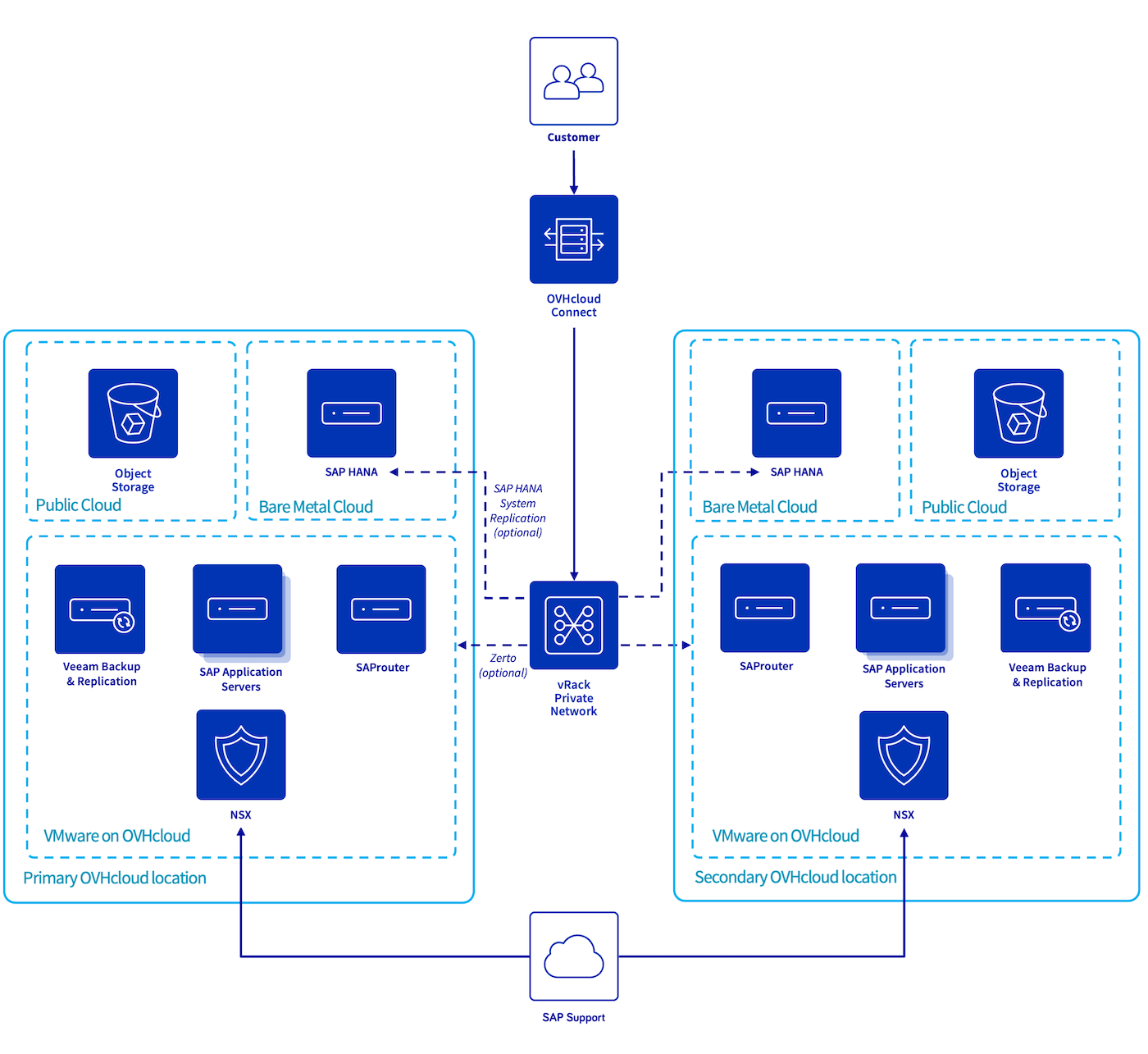

This concept page demonstrates a hybrid architecture using a HGR-SAP dedicated server and VMware on OVHcloud
The following concept allows you to build an architecture with a SAP HANA database up to 1.5 TB, and takes advantage of all VMware on OVHcloud features (OVA templates, Zerto, NSX, DRS, Fault Tolerance, High Availability) for your SAP Application Servers in a single OVHcloud location or multiple OVHcloud locations.
schema
ObjectiveDescription
Objective #1Building a cost-effective SAP infrastructure based on existing VMware on OVHcloud for application servers and dedicated servers to host SAP HANA databases.
Objective #2No compliance requirements with any SecNumCloud qualification or PCI DSS certification.
Objective #3An infrastructure Recovery Point Objective (RPO) of 15 minutes.
Objective #4 (optional)An SAP infrastructure available in a secondary OVHcloud location which can be activated in the event of a major issue impacting the primary OVHcloud location. This secondary OVHcloud location offers an infrastructure RPO near to zero.

1 - Network connectivity
To guarantee the quality of communication between your local site and your SAP infrastructure hosted at OVHcloud, we recommend using OVHcloud Connect. This solution provides you with a secure and high-performance link between your offices and OVHcloud. To get more information, please refer to the OVHcloud Connect documentation.
2 - SAP HANA database
The SAP HANA database is hosted on a dedicated server of the SAP HANA on Bare Metal server range (references HGR-SAP-1/2/3). To know how to deploy a SAP HANA database on an OVHcloud dedicated server, please refer to our documentation.
Deploying a SAP HANA database on a dedicated server offers a cost-effective infrastructure that meets compliance and regulatory requirements.
In order to reduce the RPO and the RTO in a single OVHcloud location, you can add another SAP HANA database on a second dedicated server and configure SAP HANA System Replication between these databases. To discover all supported replication modes by SAP HAHA, please refer to the SAP official documentation available on the SAP Help Portal. In this context, you could use a replication SYNC mode.
This architecture prevents outages caused by hardware incidents on your SAP HANA database hosted in a single OVHcloud location.
3 - SAP Application Servers
The SAP Application Servers infrastructure is hosted on VMware on OVHcloud. We advise to take into consideration the SAP Note 2161991, especially chapter 2 and 3, and the SAP Note 2015392, to set a compliant configuration between SAP and virtual machines.
The Fault Tolerance feature1 provided by VMware guarantees the availability of your SAP Application Servers in case of ESXi host failures. Your virtual machine is automatically activated on another member of your VMware cluster. We advise enabling it on your virtual machines which host the SAP Central Services (SCS), if you do not manage an SAP cluster for this service in another way. The Fault Tolerance could also be enabled on your SAP Application Servers which host a critical service.
However, to be able to enable the Fault Tolerance, the virtual machine cannot exceed 8 vCPU and 128 GB of memory.
For SAP Application Servers which do not host a critical service, we recommend ensuring that the vSphere HA feature is enabled in your VMware cluster. It monitors the health of each ESXi host in the cluster, and automatically restarts the virtual machines hosted on the impacted ESXi host.
The vSphere Distributed Resource Scheduler can also be activated with VM/Host rules to avoid running all SAP Application Servers on the same ESXi host.
1 The Fault Tolerance feature is currently incompatible if your virtual machine uses a port group created and managed by NSX (Article 317806).

About the connection from SAP Support to your SAP landscape on OVHcloud, we advise you to deploy a virtual machine within your VMware on OVHcloud solution, configure an Additional IP and attach it to NSX. Then install the SAProuter service on this virtual machine, according to the official SAProuter documentation by SAP Support.
Configure your NSX to route the ingress traffic to your SAProuter.
As this virtual machine is exposed to the Internet, adapt ingress firewall rules to only allow the connection from the SAP IP public range to your SAProuter server. Allow communication from your new SAProuter to your SAP infrastructure for only the needed ports/protocols. All of this information is available on the SAP Support pages.
We propose you a guide to set a SAProuter with VMware on OVHcloud and NSX.

To eliminate the risk of losing a single OVHcloud location deployment, consider adding a secondary OVHcloud location.
7.1 - Network connectivity
As with the primary OVHcloud location, we recommend using OVHcloud Connect. If this solution is not suitable for you, a point-to-point VPN can be deployed with NSX for the second OVHcloud location.
7.2 - SAP HANA database
The SAP HANA System Replication called SAP HSR is used to replicate the data and configuration of OVHcloud location 1 (primary OVHcloud location) to OVHcloud location 2 (secondary OVHcloud location). This replication allows you to secure your data in another SAP HANA database and thus achieve the lowest RPO possible.
To configure a SAP HANA replication, please refer to the official SAP documentation which is available on the SAP Help Portal. However, within the scope of this concept with two OVHcloud locations, we advise you to enable the data and log compression and use the ASYNC replication mode. Find more information on the SAP Help Portal.
If you trigger a takeover to another OVHcloud location, you should switch the SAP Application Servers too, to guarantee the performance between the SAP Application Servers and the SAP HANA database.
It is also possible to add another SAP HANA database in the primary OVHcloud location on a second dedicated server and thus minimise the RPO and RTO in the event of a hardware incident in the primary OVHcloud location.
An n-tier replication is structured as follows:
SAP HANA1(OVHcloud location 1) -> SAP HANA2(OVHcloud location 1) -> SAP HANA3(OVHcloud location 2).
To learn how to configure this replication, please refer to the SAP Help Portal.
7.3 - SAP Application Servers
To secure your infrastructure in the event of a major incident in your primary OVHcloud location, we advise you to enable the feature named Zerto for your VMware on OVHcloud solution, allowing you to replicate your virtual machines to another OVHcloud location of another VMware on OVHcloud service. With this feature, you secure your SAP Application Servers in another OVHcloud location with a synchronous replication, and you reduce the RTO and the RPO if you have to switch to your secondary OVHcloud location.
To know how to enable this feature, please refer to the OVHcloud documentation.
If you trigger a switch to the secondary OVHcloud location through Zerto, the SAP HANA database has to be switched too, to ensure the performance between the SAP Application Servers and the SAP HANA database.
