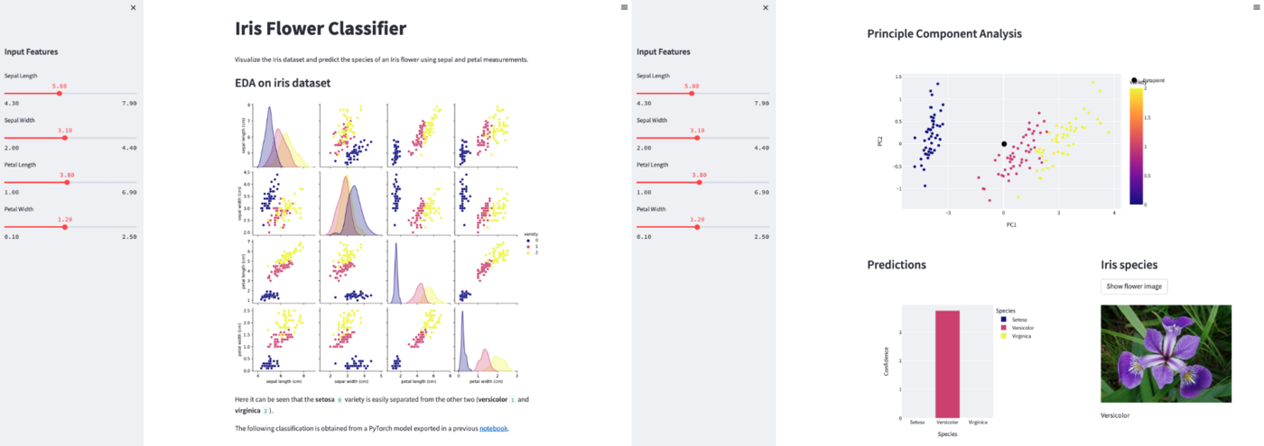

How to deploy a Streamlit app for interactive data visualization and prediction
The objective of this tutorial is to deploy an application for Exploratory Data Analysis (EDA) and interactive prediction.
The use case is the IRIS dataset. It is a collection of data containing information on 50 observations of four different variables: petal length, petal width, sepal length and sepal width.
Overview
The first objective is to perform data mining on the source data from the Iris dataset.
Then, the goal is to make predictions using a trained model. We will therefore use a neural network and weights from this notebook to classify iris flowers between different species (Setosa, Versicolor and Virginica). The four features are sent as input to the neural network.
The PyTorch model will be loaded and run, and the prediction probabilities for each class will be extracted. Depending on the input data, it will be possible to visualize the corresponding iris on a PCA plot to compare the input to other data points in our Iris dataset.
In order to do this, you will use Streamlit, a Python framework that turns scripts into a shareable web application. You will also learn how to build and use a custom Docker image for a Streamlit application.

Create the Streamlit application
Two Python files are created for the purpose of loading the PyTorch model and building the Streamlit app.
Define the utils.py file
This Python file is dedicated to load the PyTorch model. You can find the full code here.
First, we have to define the Model class with neural network architecture.

Write the app.py file
Load the IRIS dataset for EDA.
@st.cache
def load_data():
    # load the iris dataset with sklearn
    dataset_iris = load_iris()
    # define inputs and output
    df_inputs = pd.DataFrame(dataset_iris.data, columns=dataset_iris.feature_names)
    df_output = pd.DataFrame(dataset_iris.target, columns=['variety'])
    return df_inputs, df_output
Display EDA figure based on source dataset.
@st.cache(allow_output_mutation=True)
def data_visualization(df_inputs, df_output):
    df = pd.concat([df_inputs, df_output['variety']], axis=1)
    eda = sns.pairplot(data=df, hue="variety", palette=['#0D0888', '#CB4779', '#F0F922'])
    return eda
Create a sidebar with sliders.
def create_slider(df_inputs):
    # slidebars with min, max and mean (by default) values
    sepal_length = st.sidebar.slider(
        label='Sepal Length',
        min_value=float(df_inputs['sepal length (cm)'].min()),
        max_value=float(df_inputs['sepal length (cm)'].max()),
        value=float(round(df_inputs['sepal length (cm)'].mean(), 1)),
        step=0.1)
    sepal_width = st.sidebar.slider(
        label='Sepal Width',
        min_value=float(df_inputs['sepal width (cm)'].min()),
        max_value=float(df_inputs['sepal width (cm)'].max()),
        value=float(round(df_inputs['sepal width (cm)'].mean(), 1)),
        step=0.1)
    petal_length = st.sidebar.slider(
        label='Petal Length',
        min_value=float(df_inputs['petal length (cm)'].min()),
        max_value=float(df_inputs['petal length (cm)'].max()),
        value=float(round(df_inputs['petal length (cm)'].mean(), 1)),
        step=0.1)
    petal_width = st.sidebar.slider(
        label='Petal Width',
        min_value=float(df_inputs['petal width (cm)'].min()),
        max_value=float(df_inputs['petal width (cm)'].max()),
        value=float(round(df_inputs['petal width (cm)'].mean(), 1)),
        step=0.1)
    return sepal_length, sepal_width, petal_length, petal_width
Run a PCA.
@st.cache
def run_pca():
    pca = PCA(2)
    X = df_inputs.iloc[:, :4]
    X_pca = pca.fit_transform(X)
    df_pca = pd.DataFrame(pca.transform(X))
    df_pca.columns = ['PC1', 'PC2']
    df_pca = pd.concat([df_pca, df_output['variety']], axis=1)
    return pca, df_pca
Create a function that filters out negative values from the dataframe. Only positive values in the dataframe are kept. If a value is negative, it is set to zero.
def extract_positive_value(prediction):
    # f(prediction) = max(0, prediction)
    prediction_positive = []
    for p in prediction:
        if p < 0:
            p = 0
        prediction_positive.append(p)
    return pd.DataFrame({'Species': ['Setosa', 'Versicolor', 'Virginica'], 'Confidence': prediction_positive})
Define a Python function to display image according to Iris species.
def display_img(species):
    # define the list of images
    list_img = ['setosa.png', 'versicolor.png', 'virginica.png']
    return Image.open(list_img[species])
All the functions defined above are called in the main Python file app.py to build the Streamlit app. You can find this part of the code as well as the different functions defined previously on the GitHub repository.

Launch the following Docker command to launch your application locally on your computer:
docker run --rm -it -p 8501:8501 --user=42420:42420 streamlit-eda-iris:latest
The -p 8501:8501 argument indicates that you want to execute a port redirection from the port 8501 of your local machine into the port 8501 of the Docker container. The port 8501 is the default port used by Streamlit applications.
Don't forget the --user=42420:42420 argument if you want to simulate the exact same behaviour that will occur on AI Deploy apps. It executes the Docker container as the specific OVHcloud user (user 42420:42420).
Once started, your application should be available on http://localhost:8501.
