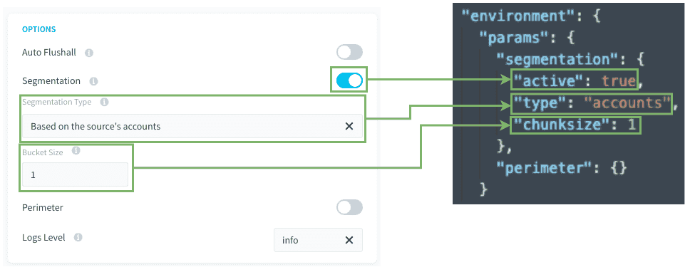

To configure this segmentation option select Based on the source's accounts in the "Segmentation Type" dropdown.
How to use this type of segmentation? — Accounts conf
Bucket size / chunksize: Set how many accounts will be managed for each task. (default = 1)

Make sure that the key params.load_from[0].source indicates the address of the source: dwh/SOURCE_NAME/ENDPOINT_NAME
Please check the previous screenshot for an example of the advanced JSON mode.
