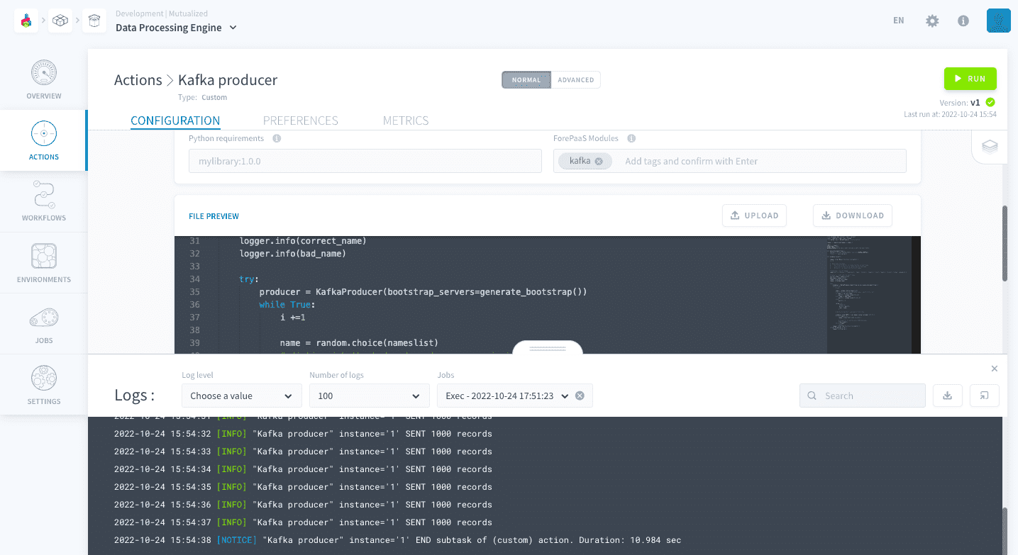

To send messages to your Kafka broker for test purposes, you can configure a Producer in Data Platform using a DPE Custom Action. Create a Custom Action in the Data Processing Engine, select start with a boilerplate and replace the boilerplate code by the one below (a simple name guessing game):

The code above represents a name guessing game, it will simply send a messages representing guesses. Each message contains an index, a name (the guess) and the points gained for the guess. Once 10 0000 messages have been sent, the action will stop and you should have some messages in your Broker.
Do not forget to add the kafka module to the Python dependencies of your Custom action.
Now, run the action to populate your topic with the test data and stop the action running once a few thousand records have been sent.
actions log

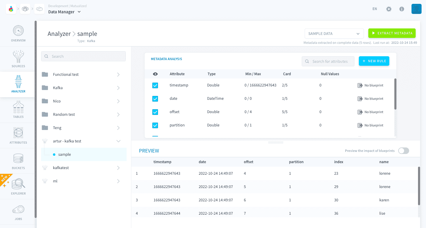

Now that your connection and topic are properly configured, you are ready to access your messages. To do it, you need to go to the Analyzer tab and extract the metadata of the topic in your connection.
The connection will appear on the left sidebar and the topic will be displayed upon clicking on the connection. Select the topic and click on the Extract metadata button.
analyzer screen with metadata extracted
After the metadata extraction, the messages will appear in the preview panel where each line corresponds to a message. Check the boxes on the metadata panel to configure which fields of the message will be included when you use your message in Data Platform.
You may notice that there are additional fields in your message. The timestamp, date as well as the offset are given by the Broker and correspond to your messages arrival timestamp, arrival date and topic offset respectively. They can be useful for some use cases but, if you don't want to include them in your data Project, simply uncheck them in the Metadata panel and they will be ignored by the rest of the platform.

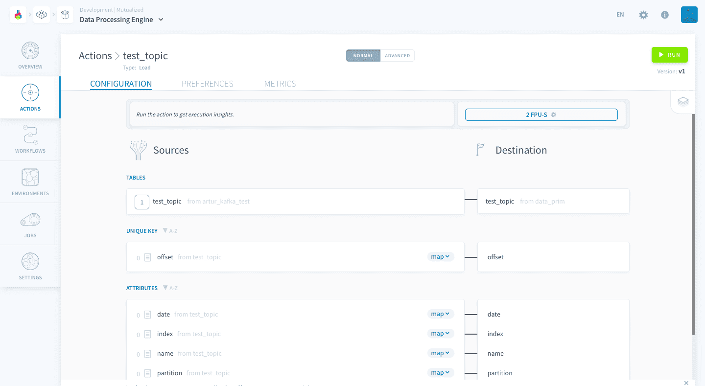

Configuring the Load Action
In comparison to other connectors, there are a few differences when creating a Load Action with a streaming source such as Apache Kafka.
To get started, select the table related to your topic as Source when configuring the action (if you already generated the action while creating the table then you will not need to select the table).
load

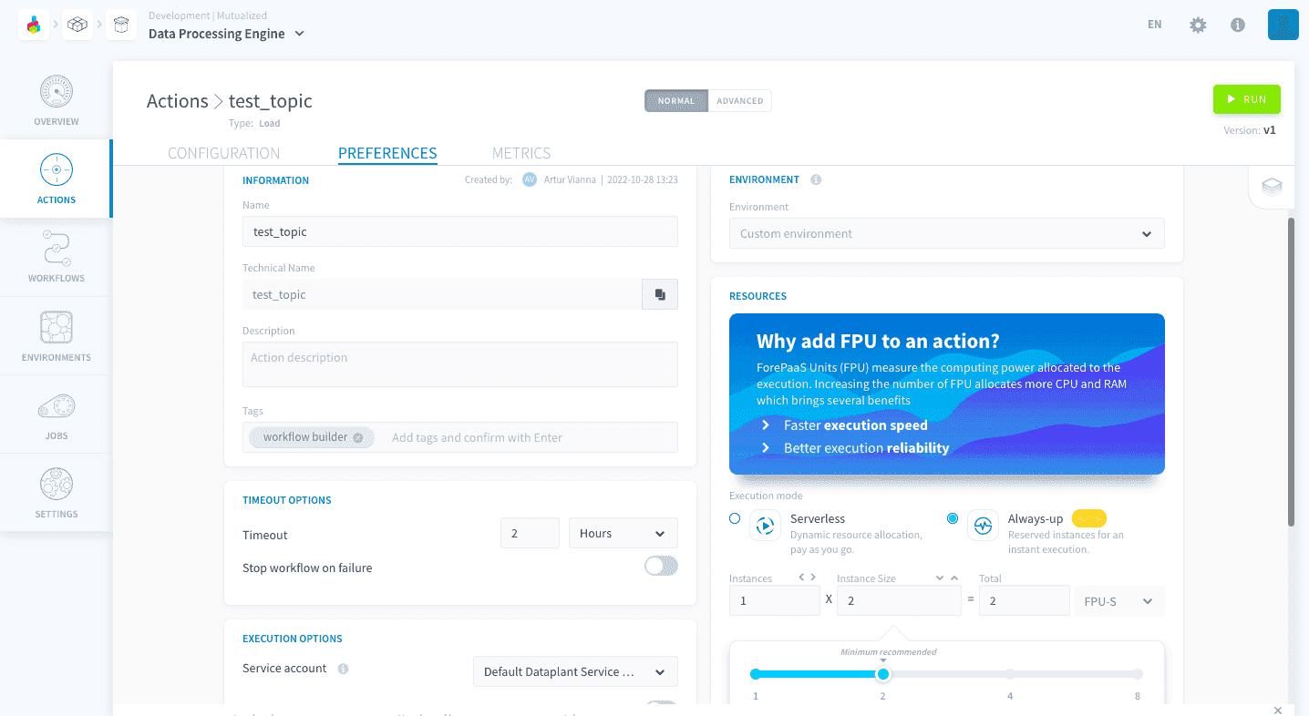

Execution modes
When running a Load Action connected to a Kafka source we strongly recommend you to select the Always-up execution mode.
exec
Regardless of the Execution Mode you use, your action will run until some data arrives. Once it does, it will be loaded into Data Platform.
If you are using the Serverless execution mode, the action will stop running once timeout is reached (by default 2 hours). Given that new data can arrive anytime in your Kafka Broker, this means that you need to re-run this action after it stopped if you want to keep feeding data from your Kafka to Data Platform. That is why we recommend the use of the Always-up execution mode, specially for production environments.
If you don't want to use the Always-up execution mode, you can alternatively set Time-based triggers to automatically run your action according to preset time interval.

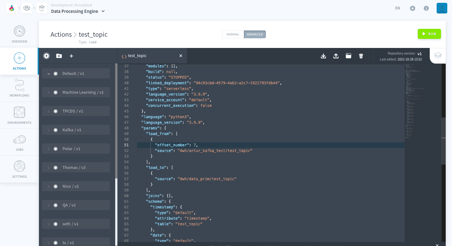

Custom offset
One other option available to you is to start reading your messages from a custom offset instead of configuring your topics to reading from the earliest or latest message.
To override the Latest or Earliest offset policy you configured on your topic and start reading messages from a defined offset you have to use the Actions' Advanced mode. Simply add a field inside the paras.load_from field as the following example (starts reading from offset 7):
"params": {
    "load_from": [
        "offset_number": 7,
offset
Note that this will override the Latest or Earliest offset policy you configured on your topic.
