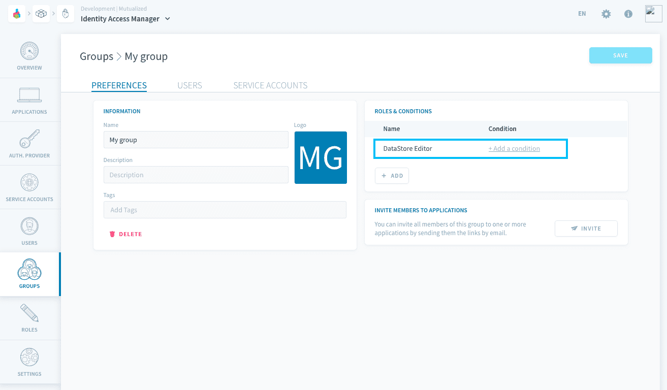

Bind such a role to the group/user of your choice.
Then, add a condition to the role binding.

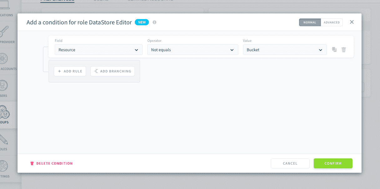

If your initial role grants access to other resources, it is important to start by adding a first rule which will allow access to all resources that are not buckets which are planned by the role.
Through conditions, you cannot give access to resources/actions that were not initially permitted by the role. Conditions can only filter a role further.
  • Field: Resource
  • Operator: Not equals
  • Value: Bucket

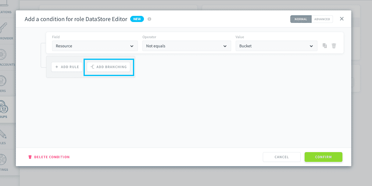

Then, add a branching with an OR operator.

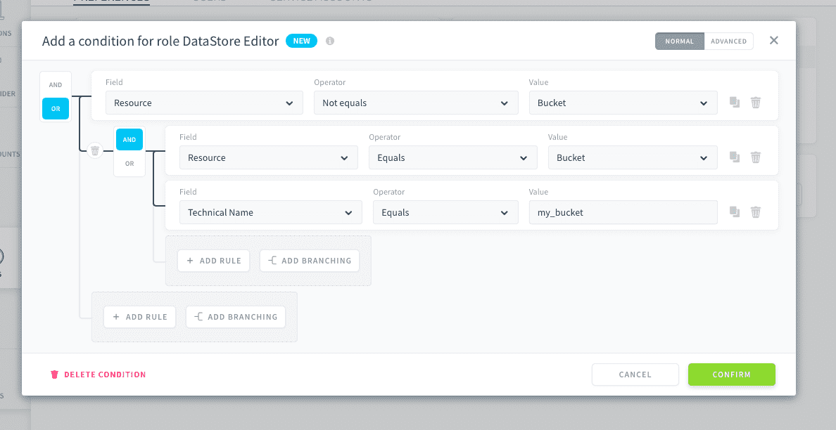

In the branching, add two rules linked by an AND operator.
First rule:
  • Field: Resource
  • Operator: Equals
  • Value: Bucket
Second rule:
  • Field: Technical name
  • Operator: Equals
  • Value: my_bucket
Using the visual builder — Visual condition3
Press Confirm. The user/group will now have access only to the bucket "my_bucket", and access to all other resources contained in the role.

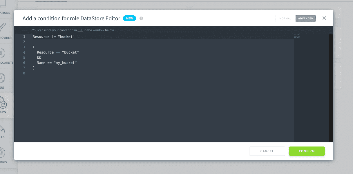

Using the CEL editor
In CEL, the condition would be the following:
Resource != "bucket"
  Resource == "bucket"
  Name == "my_bucket"
