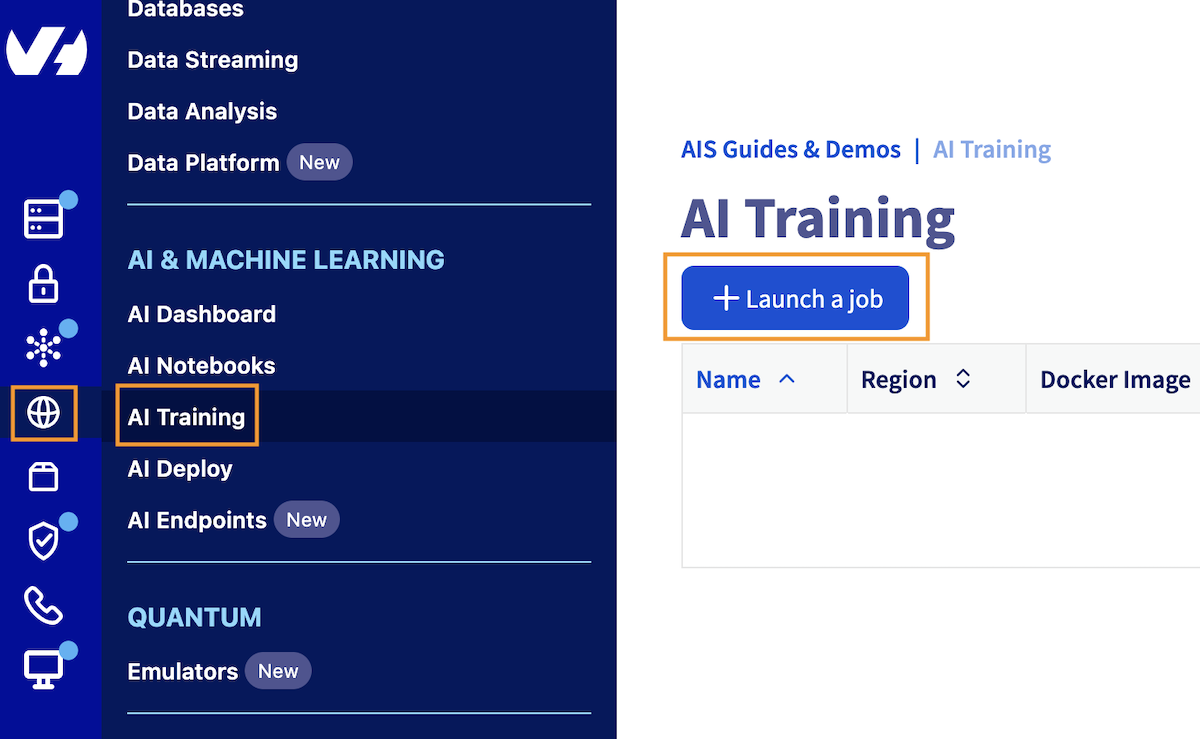

In the left-hand menu of your Public Cloud project, click AI Notebooks or AI Training under AI.
From there, click Create a notebook or Create a job to configure and create your AI Solution.

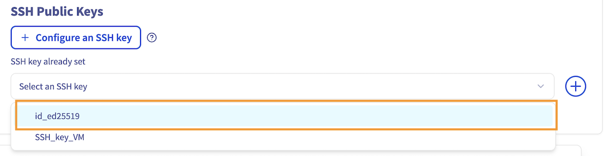

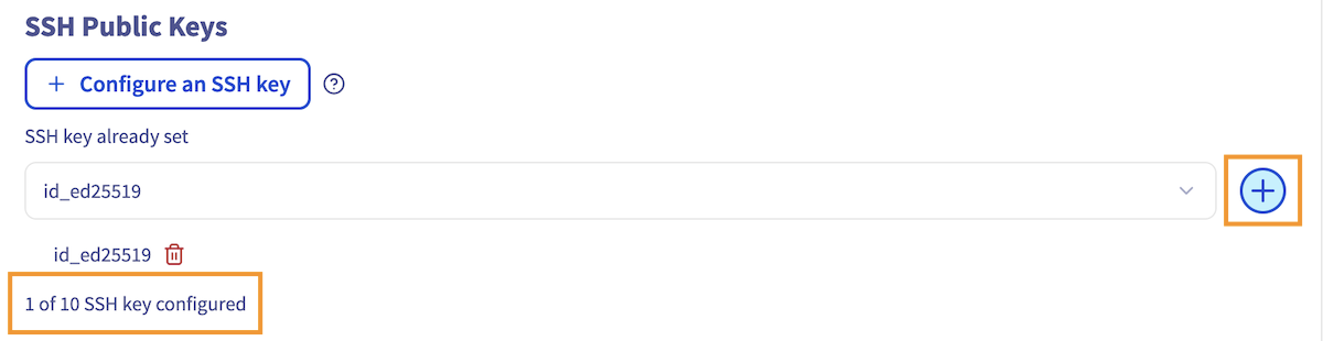

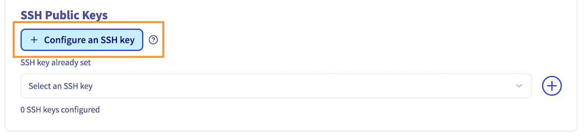

Fill in the various details required until you reach the Advanced configuration section. Turn on the SSH key switch, then click Add an SSH key.

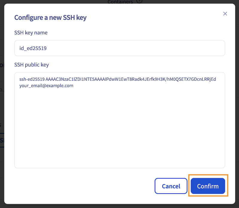

In the dialog that opens, select Existing key to choose one of your project keys, or New key to register a new one: enter a Name and paste the content of your public key file (e.g., id_ed25519.pub) in the Public key field. Then click Add.
The number of configured keys is displayed below the list (for example 1 / 10 keys).

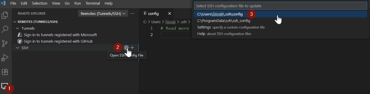

From there, click the gear icon on the SSH feature to access the SSH configuration file for VSCode, typically located at ~/.ssh/config, and open it.
VS Code Remote Explorer opening the SSH config file selection prompt

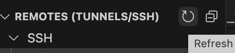

Save the config file. Then refresh remotes by clicking on this icon:
Refresh button of the VS Code SSH remotes list

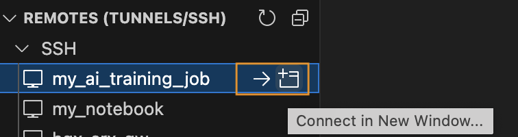

Your resource should now appear in the SSH menu on the left. Connect to it by clicking the arrow next to your resource. VSCode will restart to connect to your remote resource:
SSH remotes list showing my_ai_training_job with the Connect in New Window action

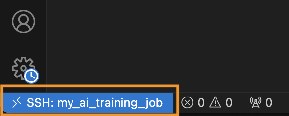

If the connection is well established, you should see this message in the bottom-left corner of VSCode:
VS Code status bar confirming the SSH connection to my_ai_training_job

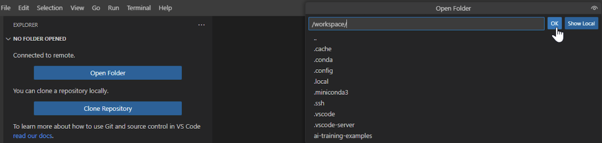

Once connected, you can start developing and running your code in the default /workspace folder, by clicking on the Open folder blue button, and select /workspace.
Open Folder prompt listing the contents of the remote workspace directory

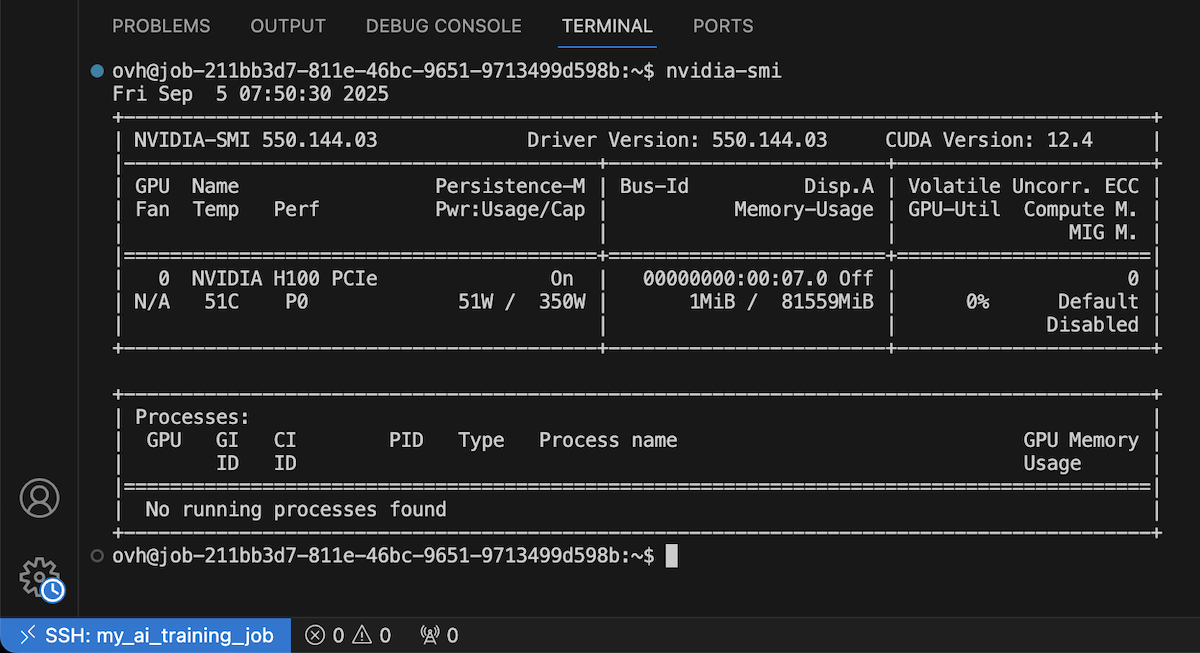

You can also open a terminal and run commands from it. Enjoy!
VS Code terminal running nvidia-smi on the remote job showing an NVIDIA H100 PCIe GPU
