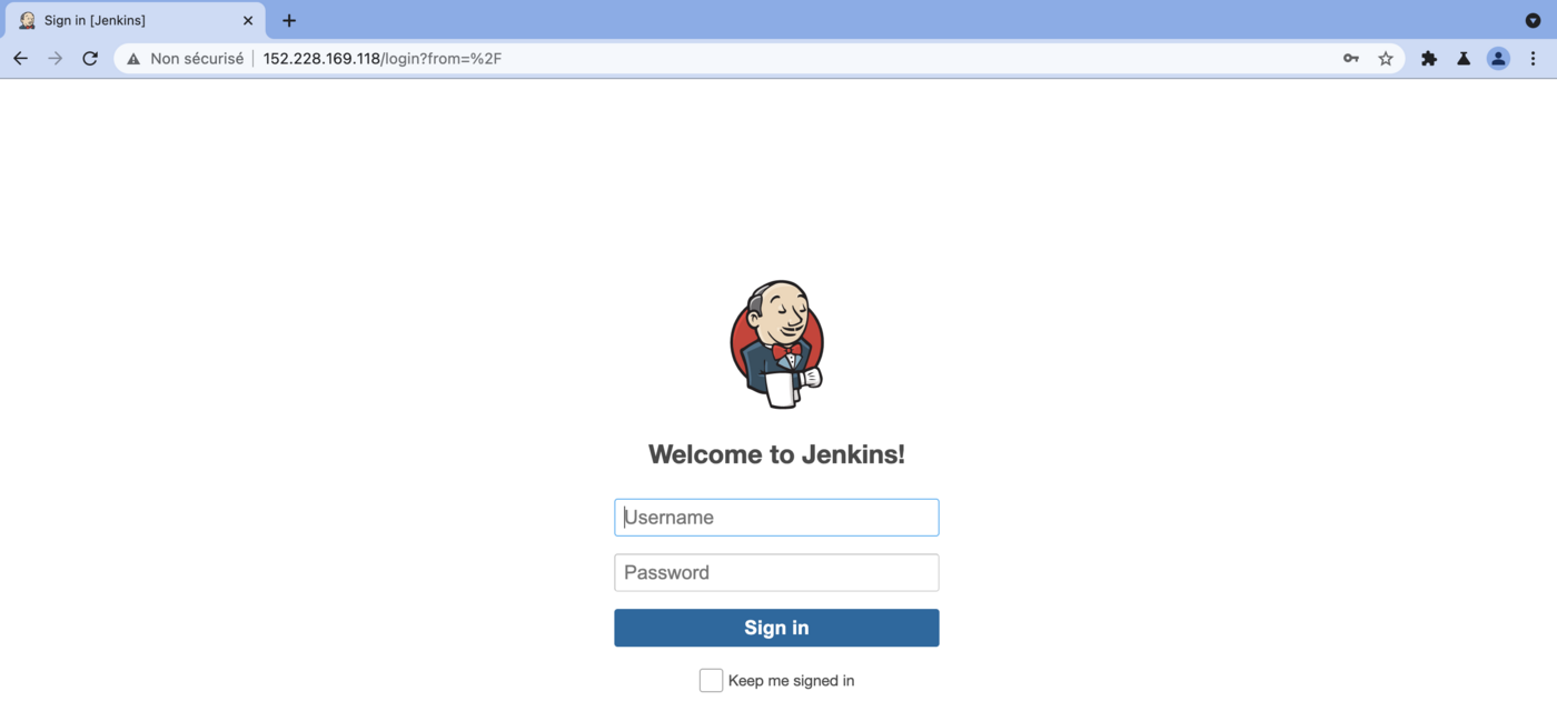

And putting the URL in your browser will take you to the new Jenkins:
Jenkins login

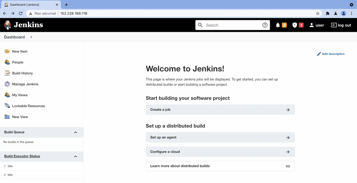

Log in with user admin and the password you got before. And here you have your Jenkins:
Leeeeeeeroy Jenkins!
You have a working Jenkins on your OVHcloud Managed Kubernetes Service, congratulations!
