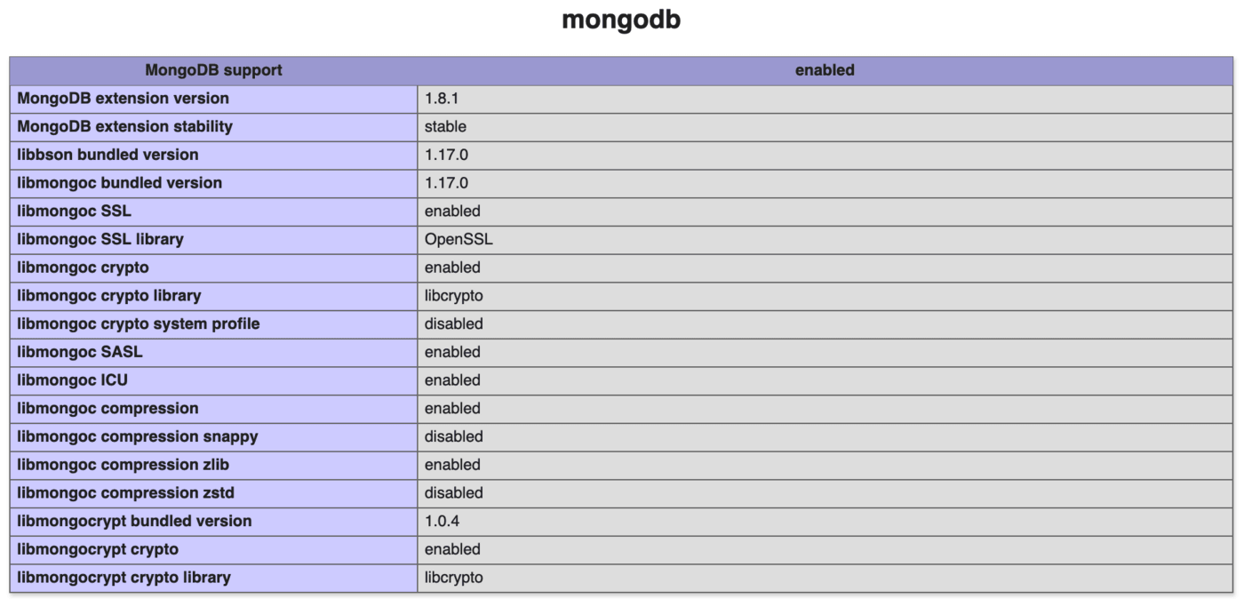

In both cases, when executing a phpinfo() in your PHP environment, you should see information about the MongoDB driver as shown below :
