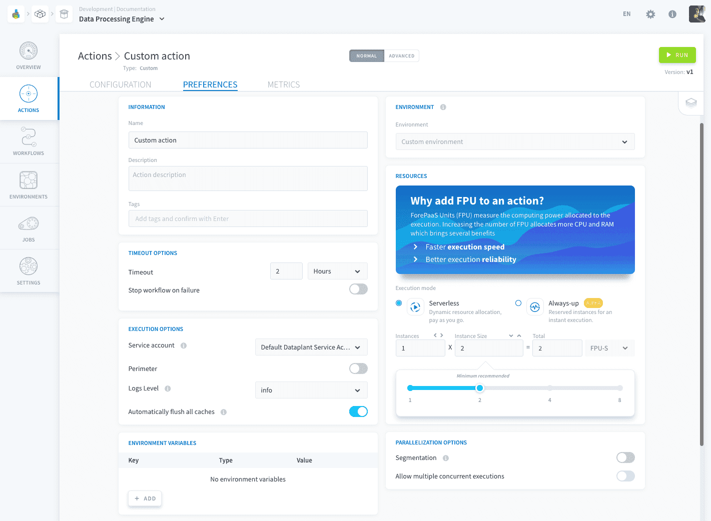

Each action or workflow in the Data Processing Engine has several configuration settings which can be managed via the Preferences tab
Each action or workflow in the Data Processing Engine has several configuration settings which can be managed via the Preferences tab.
Data Processing Engine preferences
When an action is executed, it will use those preferences to run.
When a workflow is executed, its preferences will override the preferences of all the actions it contains. If a certain preference option is deactivated at workflow level (such as segmentation or perimeter) it will fall back to each action's preferences during the workflow's execution.

Timeout options
Timeout options are not templated in an environment, and are to be configured in the preferences in each action/workflow
Timeout
Timeout is an execution runtime duration after which your job is stopped and reported with the TIMEOUT status. Timeout duration includes the resource provisioning time, the build time, and the actual code execution duration.
The maximum timeout duration that you can set is 24 hours, except for the following types of jobs where you can set it at null, meaning infinite (no timeout will be enforced):
If a job execution times out, it is flagged in the jobs list with the TIMEOUT status, which differentiates it from other sources of failure.

Execution options
Service account
Each action, workflow or environment has a service account associated to it, which the action/workflow impersonates as it is executed. This service account acts as the identity of the running job, and controls the access level of the job through the service account's roles.
Even if you launch a job manually, its execution will be authenticated by the associated service account.

Logs level
The logs level defines the list of logs that will be stored during the action's or workflow's execution. The different levels range from debug to critical. All the logs above the one selected (included) will be stored.
For PySpark actions, you set the log level of your own libraries and the Spark log level separately.
Automatically flush all caches
When this parameter is activated, the components' caches will automatically be flushed after each execution of the action/workflow.

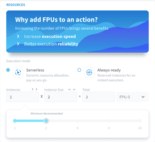

Execution modes
There are two execution modes available in the Preferences page:
  • Serverless: computing resources deployed on the fly.
  • Always-up: dedicated instances always running to swiftly execute your jobs whenever you want. For PySpark actions, this mode is in beta.
Execution modes — Exec modes
Serverless
By default, every job you run on the Platform is executed with the Serverless mode. An execution environment is deployed when you start the job execution and it is undeployed when this execution is done.
You will be billed for:
  • The computing resources used to perform the task.
In the Serverless mode, your execution environment is up only during the task execution because, once the task is done, it is automatically killed.
Always-up
For PySpark actions, the Always-up mode is in beta: instabilities may occur.
When you activate the Always-up mode, a dedicated computing environment is deployed for the respective action/workflow/environment. It will stay deployed until you set the Execution mode back to Serverless so you won't need to wait for its deployment every time you run the respective job.
  • The computing resources used in the time during which the execution environment was up (this includes the time taken to perform the jobs).
With the Always-up mode, your execution environment will NOT be automatically undeployed once job execution is done. You have to set the Execution Mode back to Serverless to kill it.
If you edit the configuration of an action/workflow set in Always-up mode, it will be updated in a full blue-green way: the deployment will wait until all current pending tasks are complete before gracefully shutting down for the update.
It is recommended to use the Always-up execution mode on environments rather than individual actions/workflows, in order to re-use the resources for multiple workloads.
