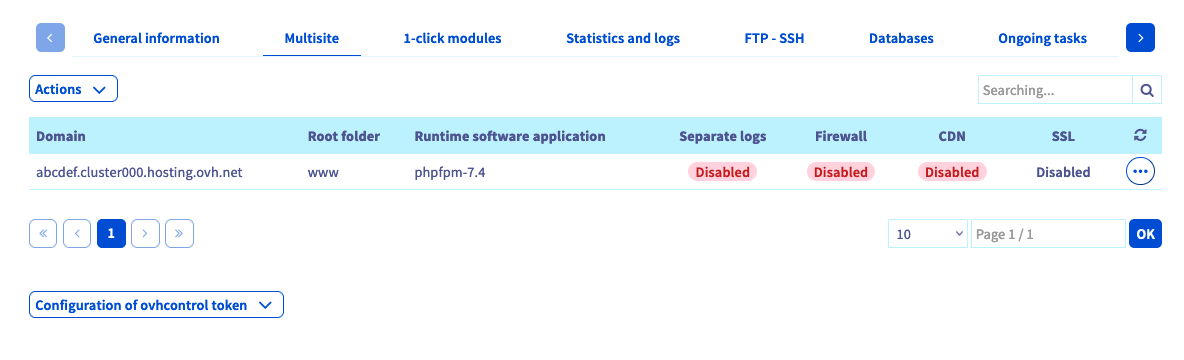

Step 2: associating Ruby with a multisite
Now that Ruby is enabled as a runtime engine, you must associate it with one of your multisites. To do this, go to the Multisite tab. The table that appears contains all the domain names that have been added as a multisite.
Associating Ruby with a multisite
Two columns should draw your attention in the table above. Check that the Ruby runtime engine is properly linked to the relevant domains and that the root folder is correct. Use the information below if needed. If it is, proceed to Step 3 Connecting to your Cloud Web via SSH.
ColumnDescription
Root folderThis is the root folder that must contain the source code of the relevant domain (it corresponds to the "DocumentRoot"). In our example, we choose to specify "camaleon". It must therefore contain our Ruby source code.
Runtime engineThis is the runtime engine associated with the relevant domain. The name displayed corresponds to the Custom name you defined when creating the runtime engine. In our example, you should find Ruby 2.6.
If it is not, add a new multisite or modify the existing one.
  • If you want to add a multisite: click Actions, then Add a domain or subdomain to the right of the table.
  • If you want to modify a multisite: click the ... button to the right of the relevant domain name, then Edit.
In the window that appears, fill in the requested information according to your own situation. The table below shows the values used for this tutorial.
InformationExample value used for this tutorial
Domaincamaleon.demo-cloudweb.ovh
Root foldercamaleon
Runtime engineRuby 2.6
As for the additional options, choose the ones you want to enable. Once the information is filled in, click Next, then finalise the operation. This addition can take up to one hour. However, the change to the DNS configuration can take up to 24 hours to become fully effective. If you would like more information about managing multisites, refer to our guide "Sharing your hosting plan between several websites".
