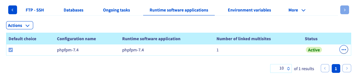

To access the runtime engines of your Cloud Web hosting plan, log in to your . Click Hosting in the services bar on the left, then choose the name of the relevant Cloud Web hosting plan. Finally, go to the Runtime engines tab.
The table that appears displays the runtime engines currently added. Make sure that the Ruby runtime engine is enabled. If it is, proceed to Step 2 Associating Ruby with a multisite.
The Ruby runtime engine must be present
If it is not, add a new one (if your plan allows it) or modify the existing runtime engine.

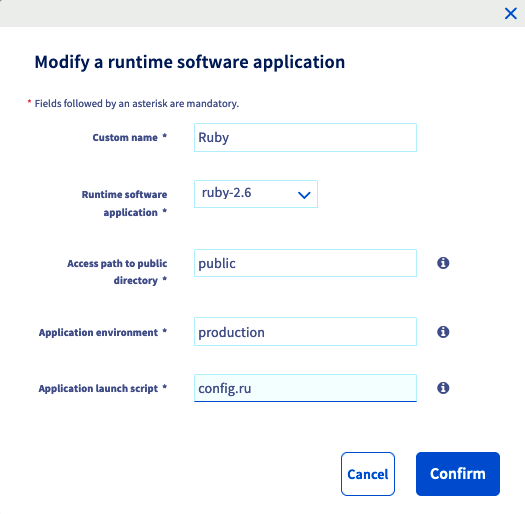

  • If you want to add an engine: click Actions above the table, then Add a runtime engine.
  • If you want to modify an engine: click the ... button to the right of the relevant engine, then Edit.
In the window that appears, fill in the requested information with the following values from our example, or adapt them to your own situation.
InformationValue to enter
Custom nameRuby 2.6
Runtime engineruby-2.6
Path to the public directorypublic
Application environmentproduction
Application launch scriptconfig.ru
Once the information is filled in, click Confirm. If you would like more information about managing runtime engines, refer to our guide Managing the runtime engines of Cloud Web.
Adding the Ruby runtime engine

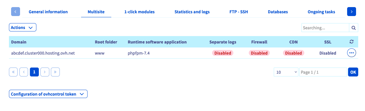

Step 2: associating Ruby with a multisite
Now that Ruby is enabled as a runtime engine, you must associate it with one of your multisites. To do this, go to the Multisite tab. The table that appears contains all the domain names that have been added as a multisite.
Two columns should draw your attention in the table above. Check that the Ruby runtime engine is properly linked to the relevant domains and that the root folder is correct. Use the information below if needed. If it is, proceed to Step 3 Connecting to your Cloud Web via SSH.
ColumnDescription
Root folderThis is the root folder that must contain the source code of the relevant domain (it corresponds to the "DocumentRoot"). In our example, we choose to specify "camaleon". It must therefore contain our Ruby source code.
Runtime engineThis is the runtime engine associated with the relevant domain. The name displayed corresponds to the Custom name you defined when creating the runtime engine. In our example, you should find Ruby 2.6.
If it is not, add a new multisite or modify the existing one.
  • If you want to add a multisite: click Actions, then Add a domain or subdomain to the right of the table.
  • If you want to modify a multisite: click the ... button to the right of the relevant domain name, then Edit.
In the window that appears, fill in the requested information according to your own situation. The table below shows the values used for this tutorial.
InformationExample value used for this tutorial
Domaincamaleon.demo-cloudweb.ovh
Root foldercamaleon
Runtime engineRuby 2.6
As for the additional options, choose the ones you want to enable. Once the information is filled in, click Next, then finalise the operation. This addition can take up to one hour. However, the change to the DNS configuration can take up to 24 hours to become fully effective. If you would like more information about managing multisites, refer to our guide "Sharing your hosting plan between several websites".
