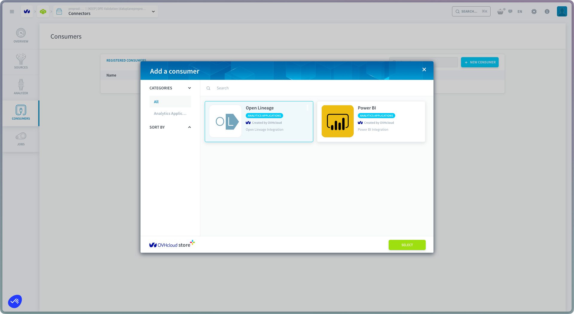

If you haven't done so already, add a new OpenLineage consumer in the Connectors. Else, just edit it.

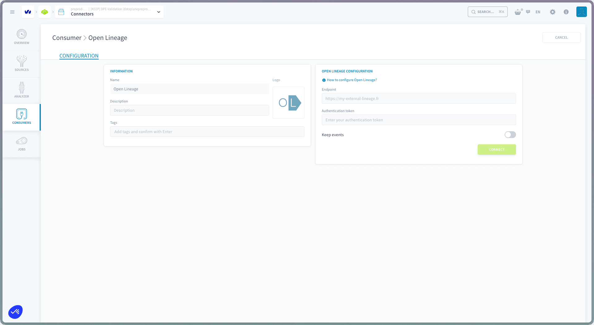

You will need to provide the following values:
FieldRequiredDescription
Endpoint URLYesThe HTTP(S) URL of your lineage solution's OpenLineage API (e.g. https://marquez.example.com/api/v1/lineage)
Auth tokenNoA bearer token used to authenticate requests to your lineage backend. Leave empty if your backend does not require authentication
Keep EventsNoIf true, events are stored in the bucket after being sent for history. Otherwise they are deleted. (Default: false)
Disable Trino eventsNoIf true, lineage events generated by Trino queries (Explorer, Analytics Manager) are not forwarded to your lineage backend. Only events from DPE actions (Load, Aggregate, Custom) are sent. Use this to reduce noise if you only care about batch lineage. (Default: false)
Configure the OpenLineage consumer — Open lineage consumer configure
