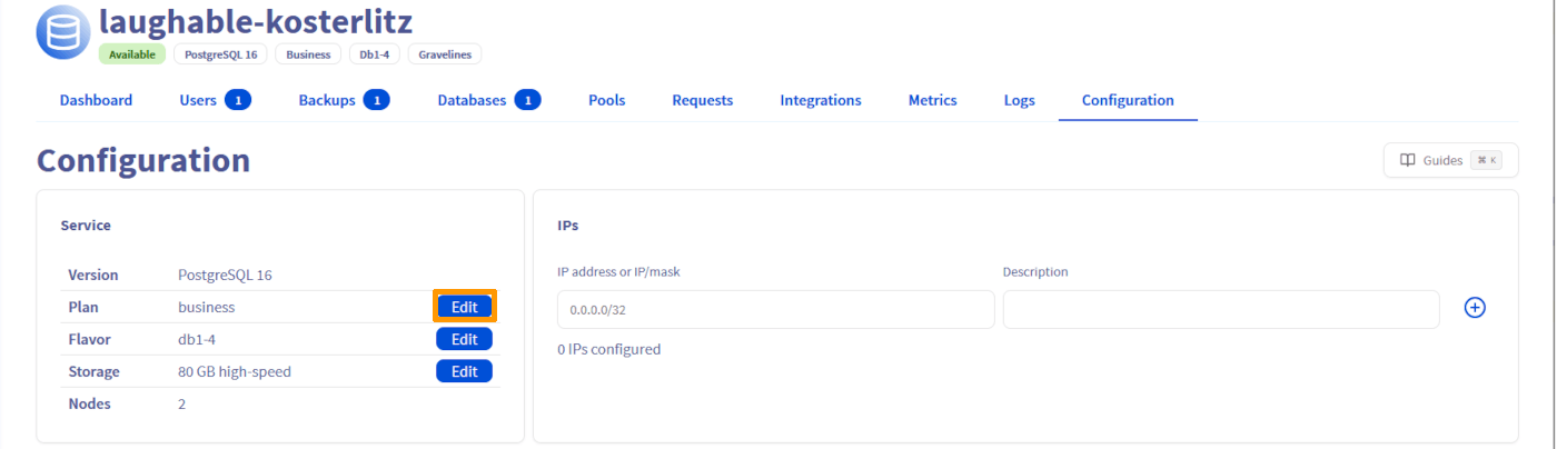

In the left-hand menu of your Public Cloud project, click your engine under Databases, then click the name of your service.
In the General information card of the Overview tab, click Upgrade. In the panel that opens, select the new Plan of your cluster, then click Save.
