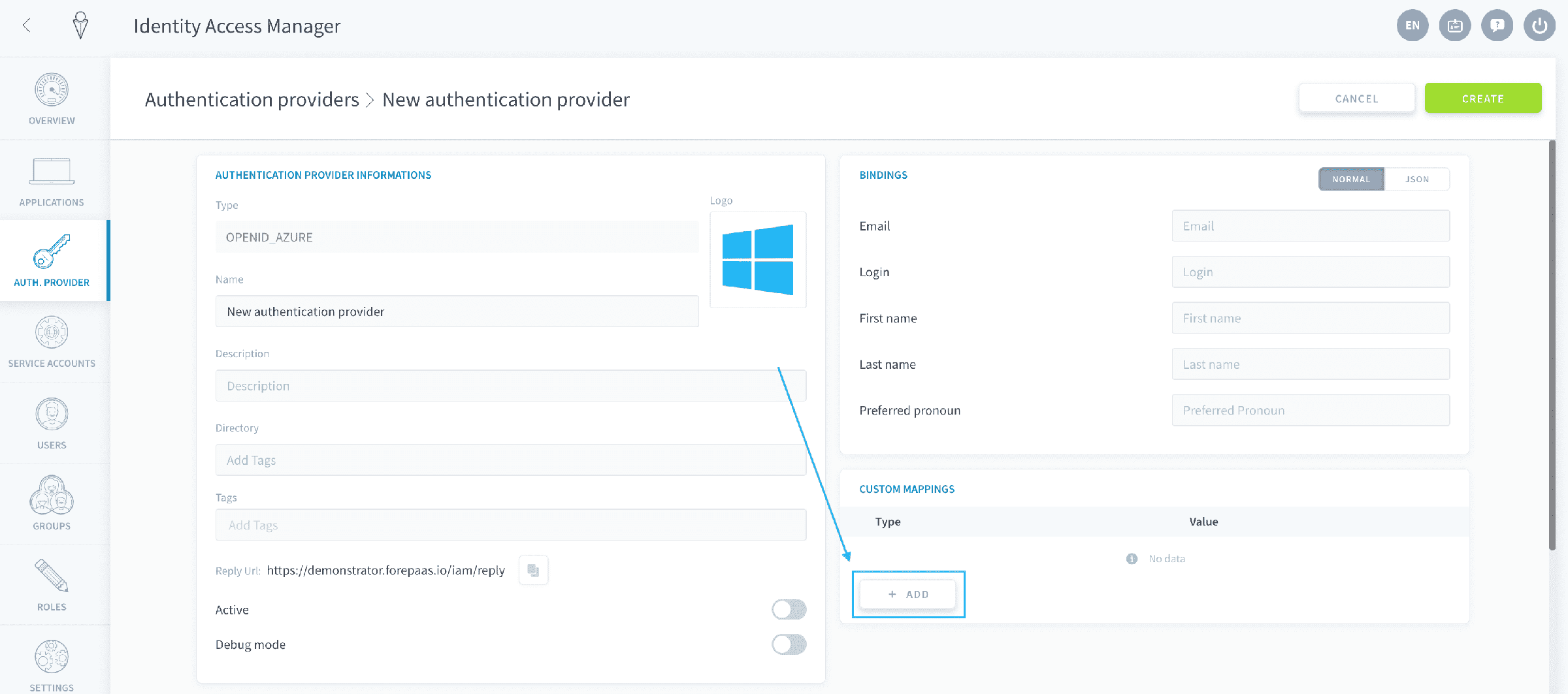

Click on Add in the Custom Mapping panel to set up a new mapping.
mapping

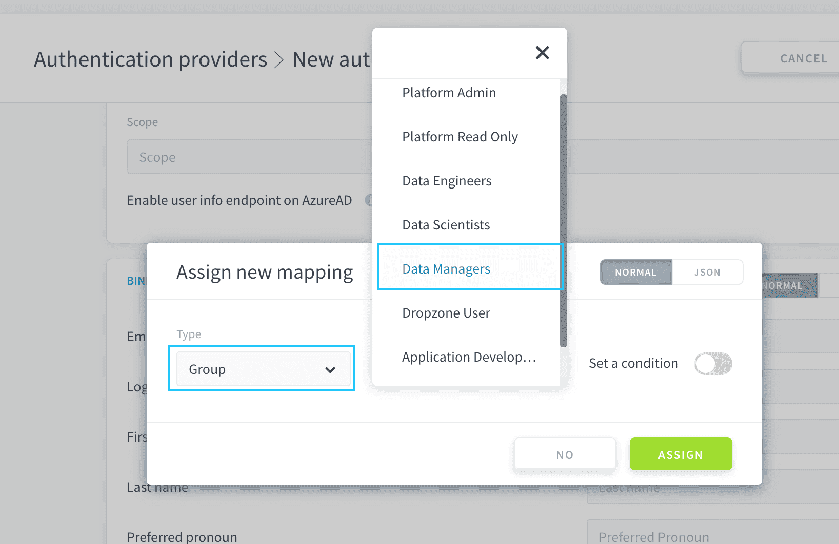

With the normal mode, you can assign existing groups or roles to users signing in from the authentication provider.
To do this, choose between Role and Group, and select the role/group from the selection.
mapping
By default, it will assign the role/group to all new users imported from the authentication provider, but you can set a condition on the binding.
simple mapping
