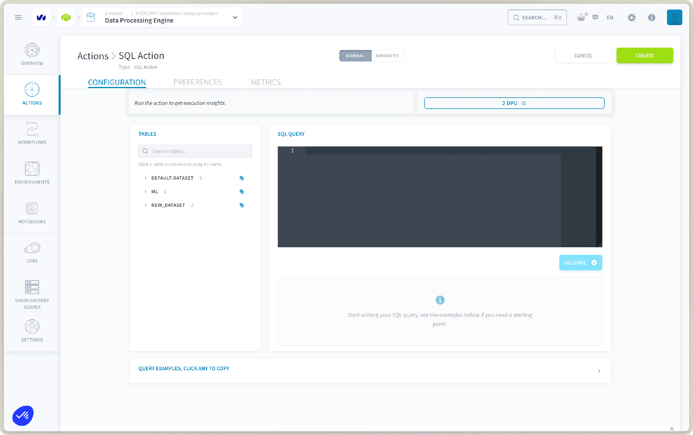

Configure a SQL action
The configuration screen has two panels: the Tables browser on the left to help you find and reference assets, and the SQL query editor on the right where you write and validate your statement.

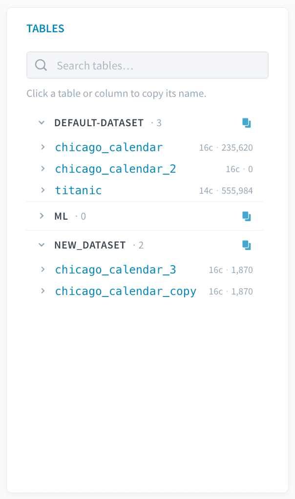

Browse tables and copy names
The Tables panel lists the datasets in your project, each expandable to its tables and their attributes. Use the search box to quickly locate an asset, then click it to copy its name to the clipboard, shaped so it drops straight into your query:
Asset clickedWhat gets copied
Datasetcatalog.schema: the catalog and schema that Trino needs to resolve tables in that dataset.
TableThe fully qualified catalog.schema.table, ready to use directly in a FROM or JOIN clause.
AttributeThe attribute (column) name only.
Browse tables and copy names — Sql action tables panel
This saves you from remembering how each dataset maps to its Trino catalog and schema, and helps the engine resolve your query on the first try.

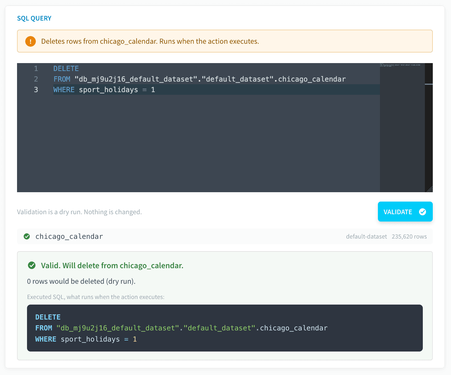

Once your query is ready, click Validate. This runs the query as a dry run and, on success, shows a validation summary at the bottom of the editor: a beautified version of EXPLAIN that tells you what the query will do, with the key details for that query type.
Write and validate the query — Sql action validation summary
Validate does not gate creation. The Create button is always available, but validating first is best practice: it confirms the query is well-formed and resolves against your tables before you commit the action.

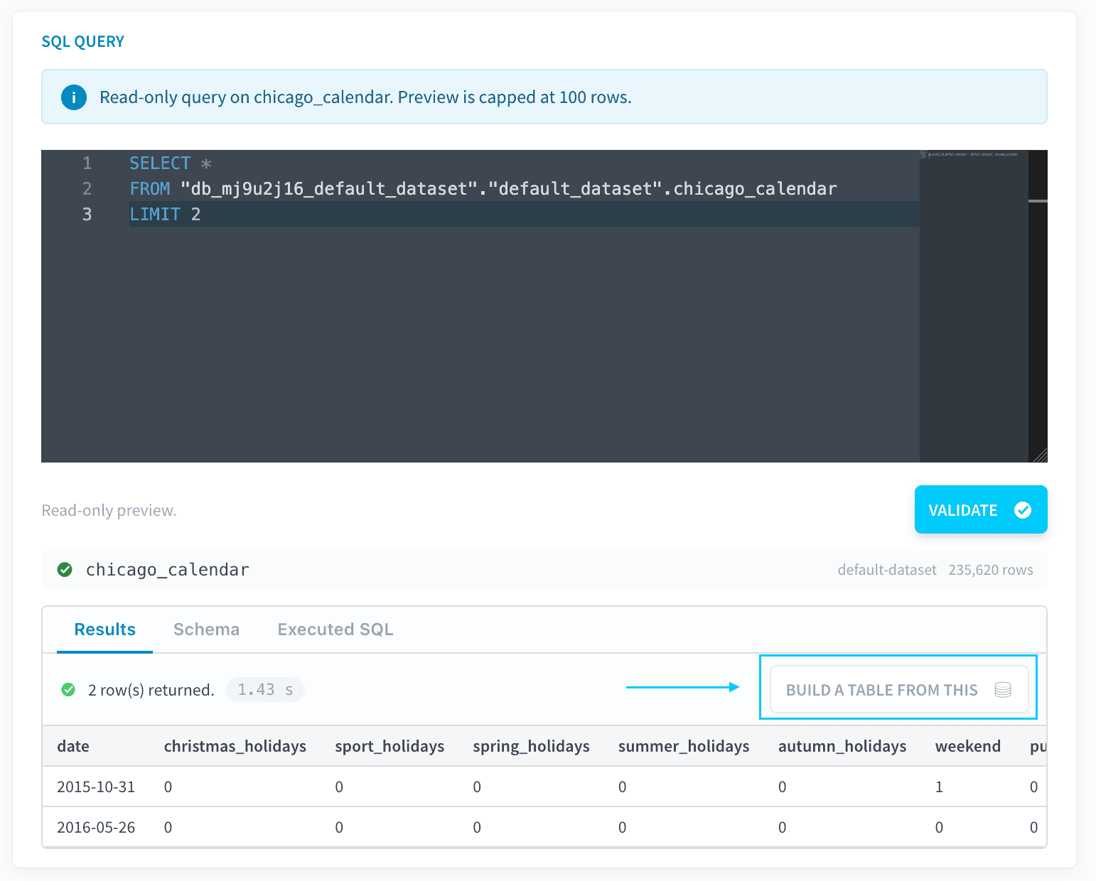

When you run a SELECT, the action offers the option to create a new table from the query result.
Create a table from a query — Sql action create table

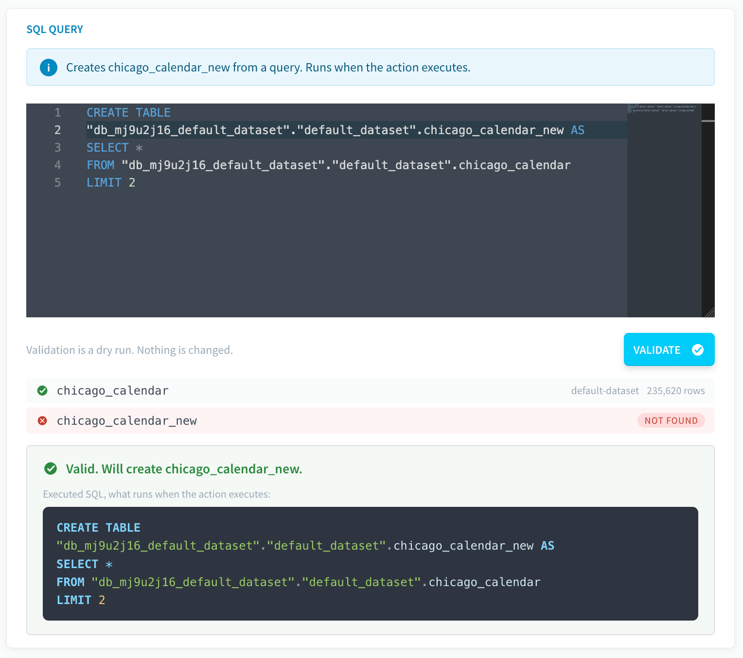

If you create and run an action with a CREATE TABLE AS SELECT (CTAS), or any other CREATE statement, the table is created on the target dataset, and the corresponding logical table is registered and built in the Lakehouse Manager as well. The new table is then available across the platform like any other Lakehouse Manager table.
Create a table from a query — Sql action create table next

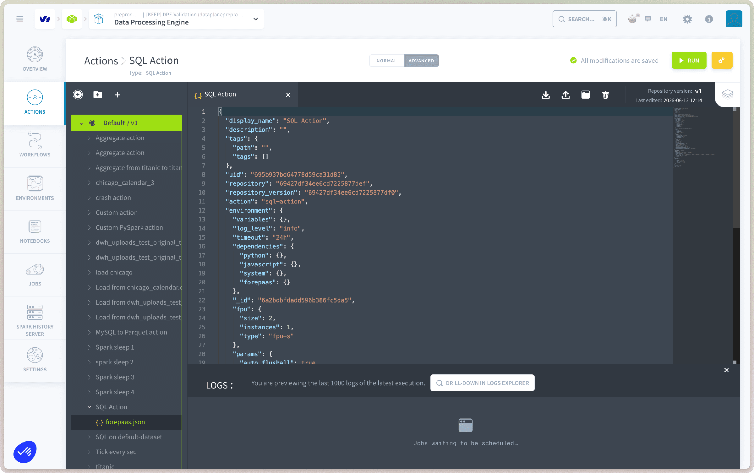

Use the Advanced mode
If you need to access the JSON configuration file of the action, activate the Advanced mode by clicking on Advanced at the top of the page.
Use the Advanced mode — Sql action advanced mode
