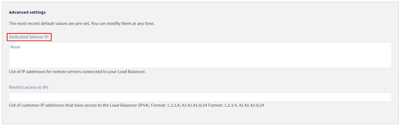

Via the OVHcloud Control Panel
You can define dedicated Additional IPs via the by navigating to the Network section, then Load Balancer.
Once you have selected the Load Balancer you want to modify, navigate to the Front-ends tab, where you can either create a new front-end or edit an existing one.
In Advanced settings, you can select the Additional IPs you would like to associate with your front-end.
Configure the front-end by associating an Additional IP
Once the front-end has been configured, click Add or Modify, depending on whether you are configuring a new or existing front-end.
Remember to deploy the configuration. There are two ways to do this:
  • via the Status section of the Home tab of your OVHcloud Control Panel, by clicking on the ... button next to your Load Balancer's ID and selecting Apply configuration
  • via the reminder box in the OVHcloud Control Panel, which notifies you that the configuration has not been applied, by clicking Apply configuration.
