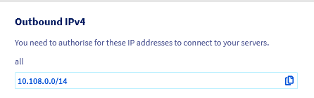

Obtaining the list of your outbound IP addresses
From the OVHcloud Control Panel
The list of IPv4 outbound addresses potentially used by your OVHcloud Load Balancer service can be found on the homepage of your OVHcloud Load Balancer service under "Outbound IPv4".
Outbound IPv4 address of your OVHcloud Load Balancer service

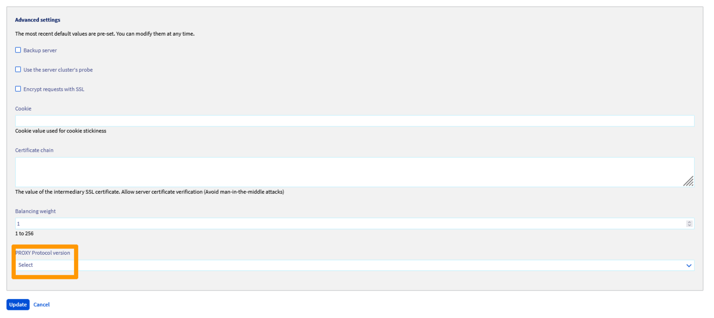

In the Clusters section, select the farm containing the server on which to enable ProxyProtocol, then click the edit button for the relevant server.
ProxyProtocol is configured via the ProxyProtocol version option. You will find the 4 modes described above.
Activating ProxyProtocol on a server in a farm
Once the desired mode is selected, click Update, then Deploy zone: YOUR ZONE to apply your changes in the relevant zone.
