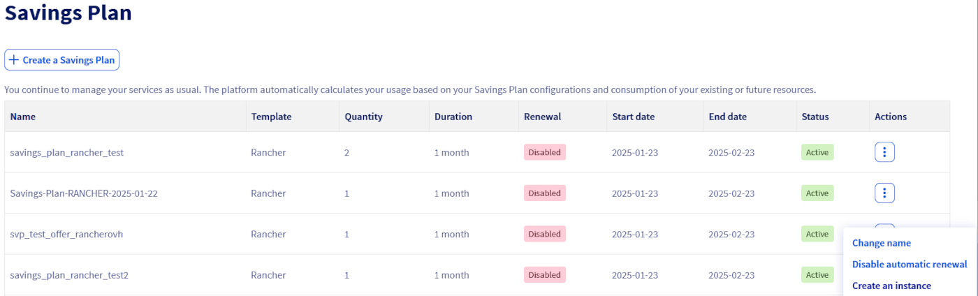

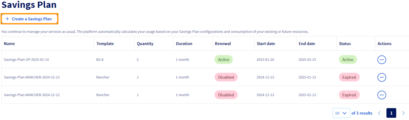

In the left-hand menu of your Public Cloud project, click Cost center, then the Savings Plan tab. Your Savings Plans are listed in the My Savings Plans table.

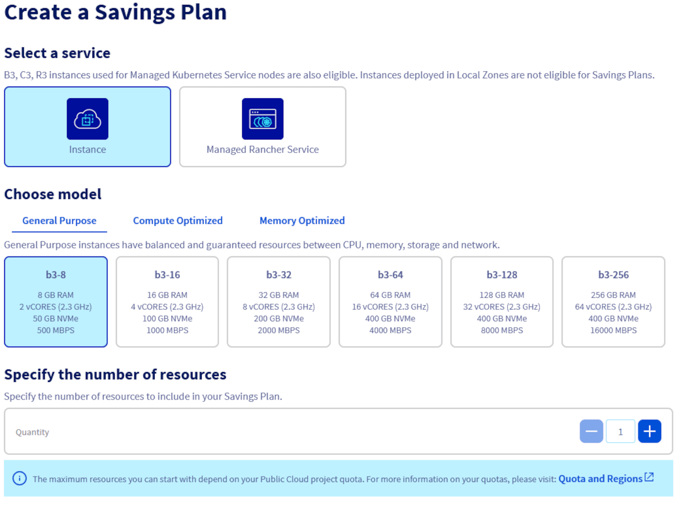

  1. Click Create a Savings Plan.
  2. In the Enter a name section, give your Savings Plan a name.
  3. In the Select a date section, choose the start date of the plan.
  4. In the Select a service section, select the type of resource for which the Savings Plan will apply: Instance or Managed Rancher Service.
  5. For instances, choose the deployment mode (1-AZ or 3-AZ region) in the Choose a deployment mode section.
  6. In the Choose a committed resource section, define the specific resource model and specify the number of resources affected by this plan.

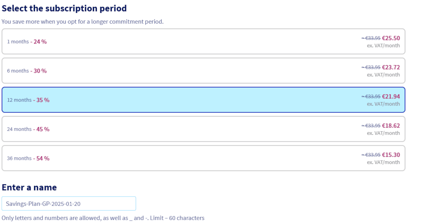

  7. In the Select the subscription period section, choose the duration of your Savings Plan from the available durations.

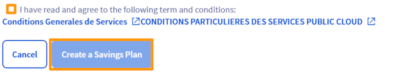

  8. Read the Terms and Conditions carefully, then tick the box I have read and agree to the terms of the following contracts: to confirm you accept them.
  9. Once all the parameters have been configured, click Create a Savings Plan to finalise the creation.

Using the OVHcloud Console, you can edit the name of the Savings Plan and activate/deactivate its automatic renewal. A plan that has not started yet can also be cancelled.
In the My Savings Plans table, click the Actions button on the row of your Savings Plan.

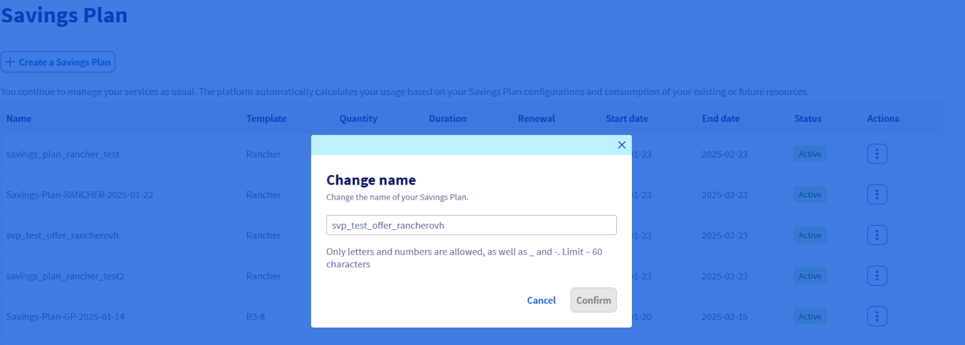

If you wish to change the name, click Edit name, change the name in the Name field and then click Save.

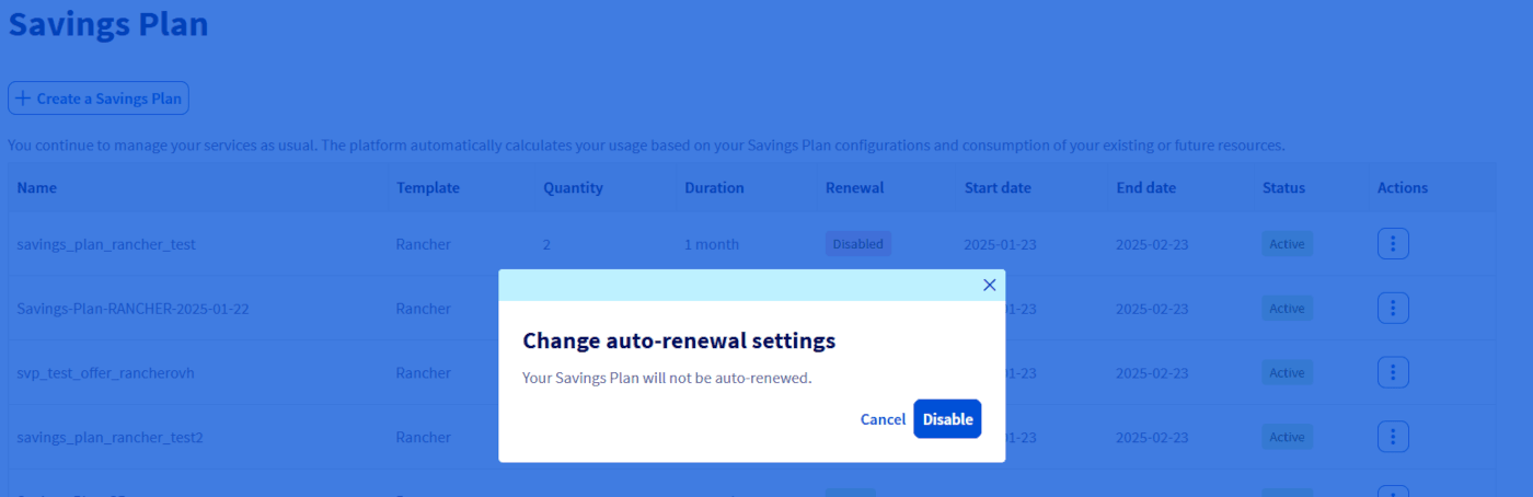

If you wish to activate/deactivate the automatic renewal of your Savings Plan, click Change renewal. The Change the renewal window states whether the automatic renewal will be enabled or disabled: click Confirm.
If your Savings Plan has not started yet, you can cancel it: click Cancel in the Actions menu, then confirm in the Cancel the savings plan window.
