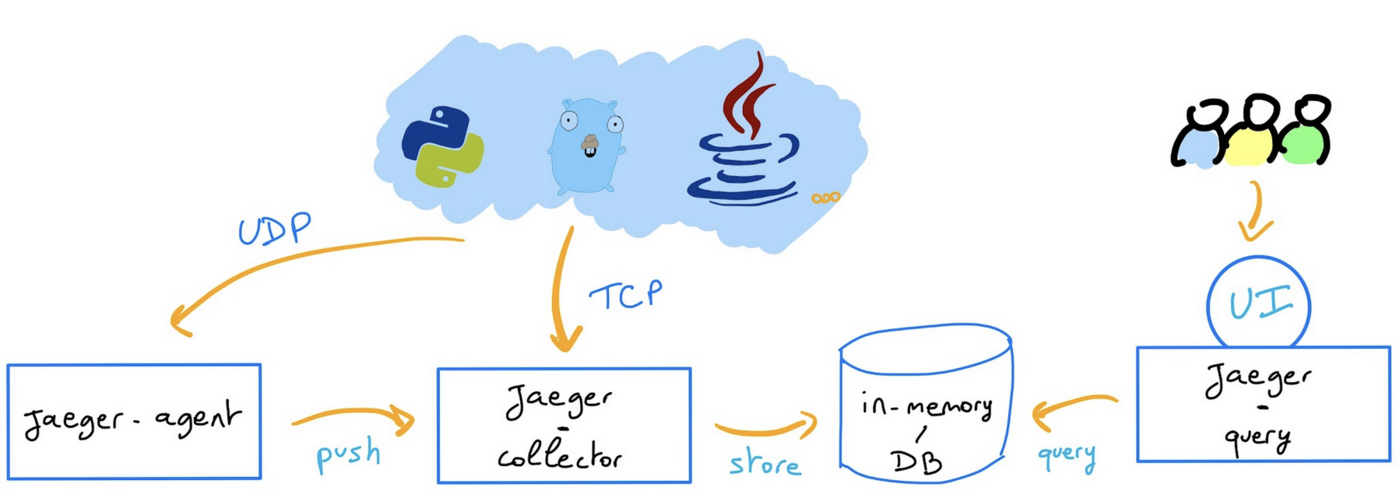

Jaeger contains several components:
Jaeger
Read more about Jaeger architecture and components.

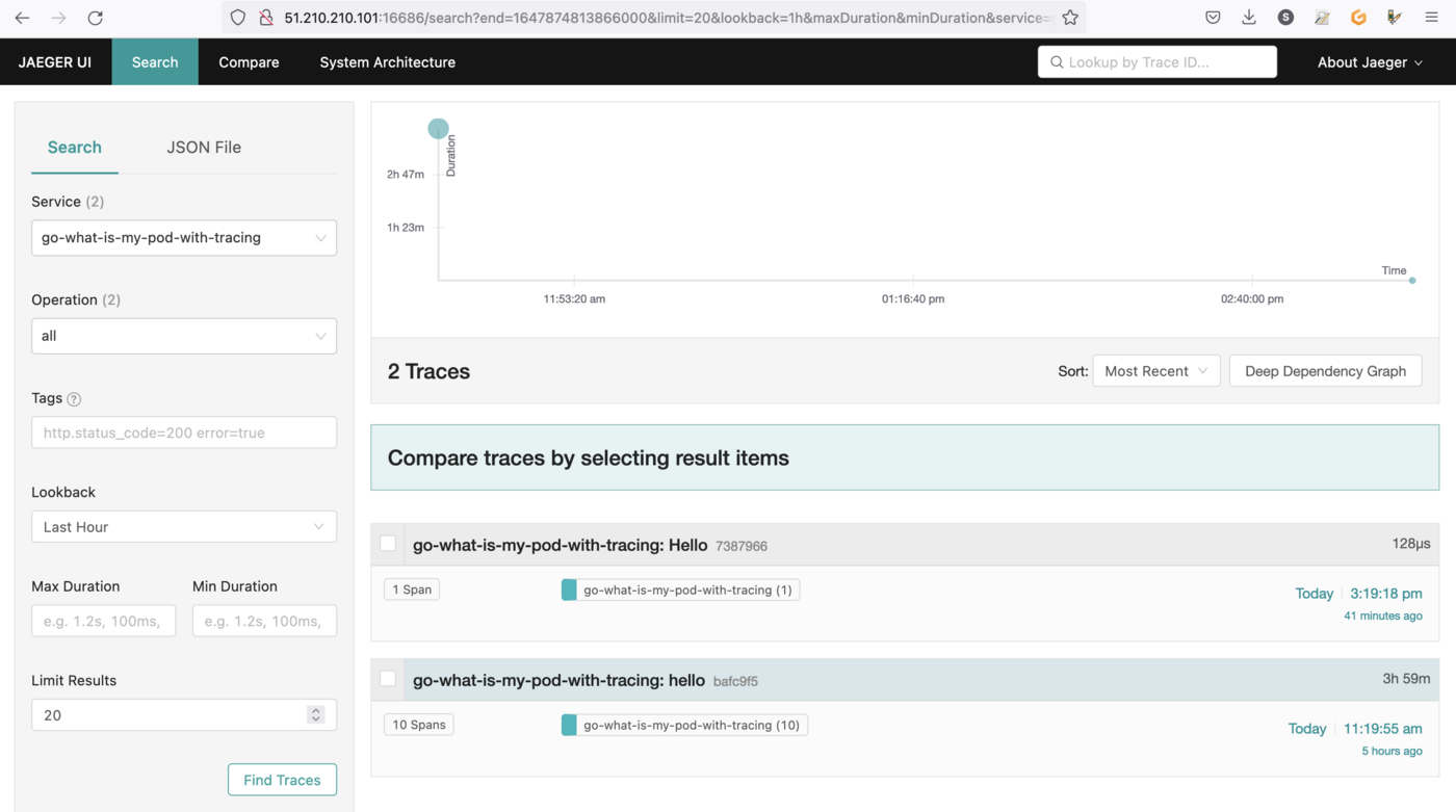

  • Visualize traces

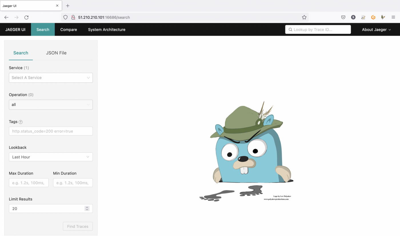

Open your browser and go to the Jaeger interface.
Jaeger Query

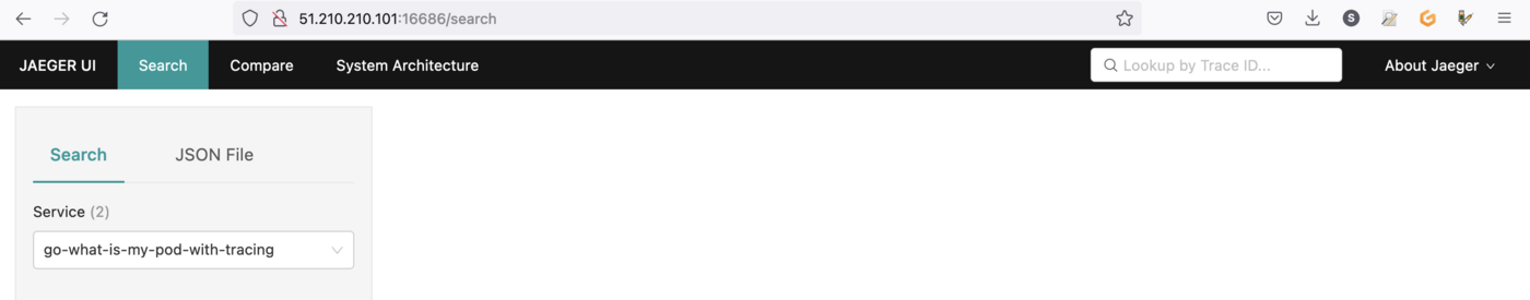

Open your browser and go back to the Jaeger interface (http://$JAEGER_URL:16686).
Jaeger query services
You should now see two available services:
  • go-what-is-my-pod-with-tracing
  • jaeger-query
Select go-what-is-my-pod-with-tracing service and click on Find Traces button.
Jaeger query traces

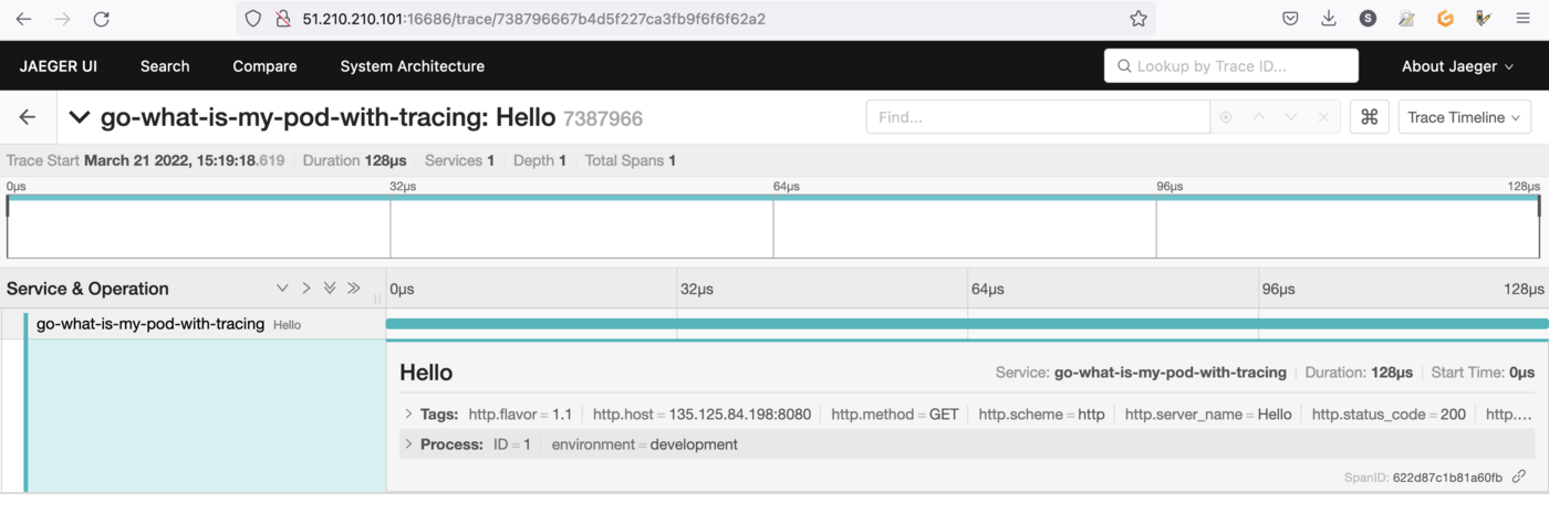

You can now click in a trace and visualize useful information.
Jaeger query trace details
