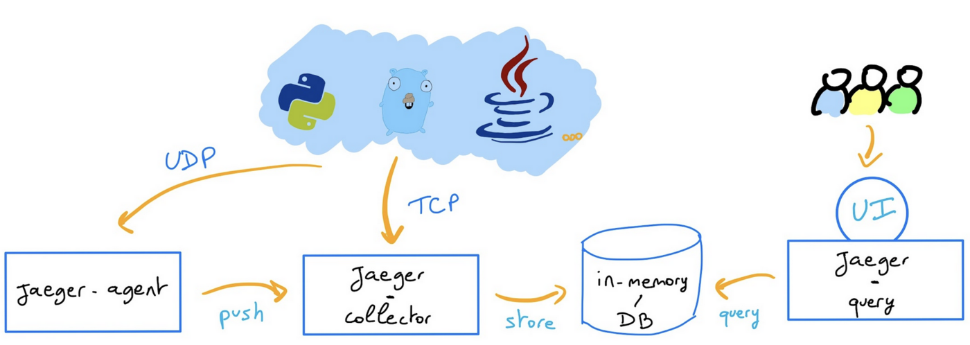

Jaeger contains several components:
Jaeger
Read more about Jaeger architecture and components.

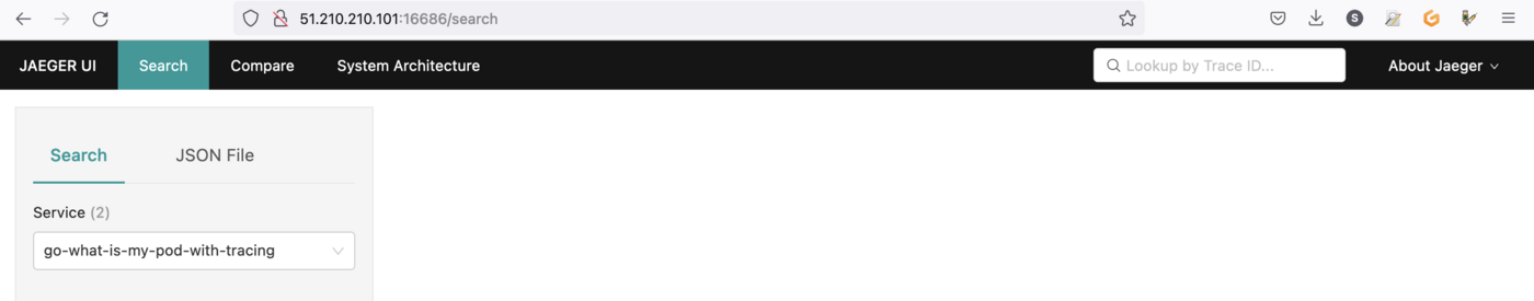

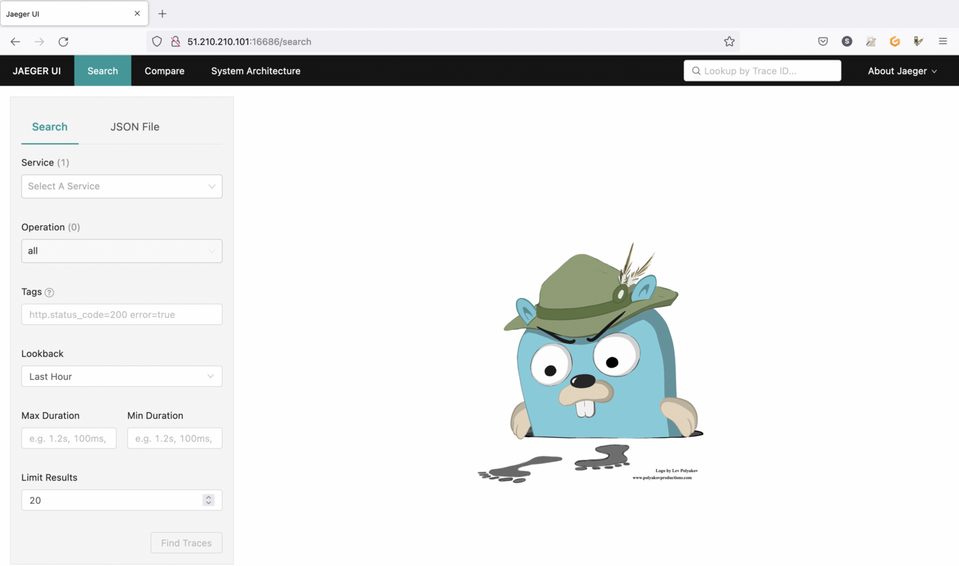

Access to Jaeger UI
Now you can retrieve Jaeger UI URL with the following command:
export JAEGER_URL=$(kubectl get svc jaeger-query -o jsonpath='{.status.loadBalancer.ingress[].ip}')
echo Jaeger URL: http://$JAEGER_URL:16686
You should obtain the following result:
$ export JAEGER_URL=$(kubectl get svc jaeger-query -o jsonpath='{.status.loadBalancer.ingress[].ip}')
$ echo Jaeger URL: http://$JAEGER_URL:16686
Jaeger URL: http://51.210.210.101:16686
Open your browser and go to the Jaeger interface.
Jaeger Query

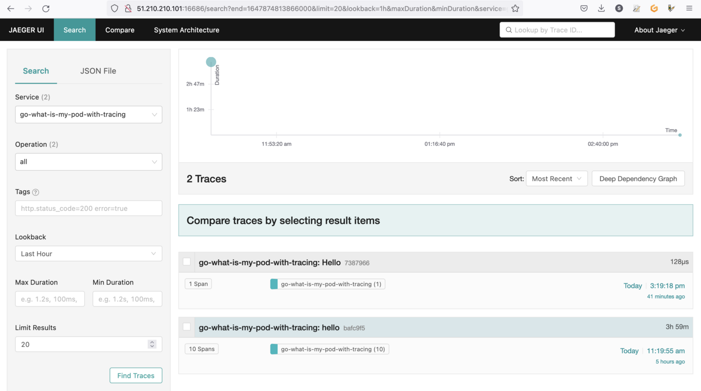

Deploy your instrumented application
In order to link your application to the Jaeger backend you need to use a tool like OpenTelemetry.
OpenTelemetry
OpenTelemetry is a collection of tools, APIs, and SDKs. Useful to instrument, generate, collect, and export telemetry data (metrics, logs, and traces) to help you analyze your software’s performance and behavior.
OpenTelemetry integrates with popular libraries and frameworks such as Spring, Express, Quarkus, and with a lot of languages. Go to the documentation to see how to integrate your application.
For this guide you will deploy a Golang application, instrumented with OpenTelemetry, that will send traces to a provider: your Jaeger collector.

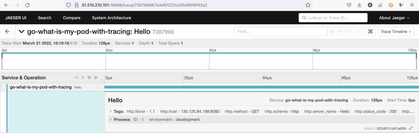

Our main.go file contains:
  • the import of the OpenTelemetry dependencies,
  • a tracerProvider method that initiates a connection to a Jaeger provider
  • a main() method that connects to the Jaeger collector you previously deployed and creates and sends a span each time the / HTTP route will be called

Open your browser and go back to the Jaeger interface (http://$JAEGER_URL:16686).
Jaeger query services
You should now see two available services:
  • go-what-is-my-pod-with-tracing
  • jaeger-query
Select go-what-is-my-pod-with-tracing service and click on Find Traces button.
Jaeger query traces
You can now click in a trace and visualize useful information.
Jaeger query trace details
