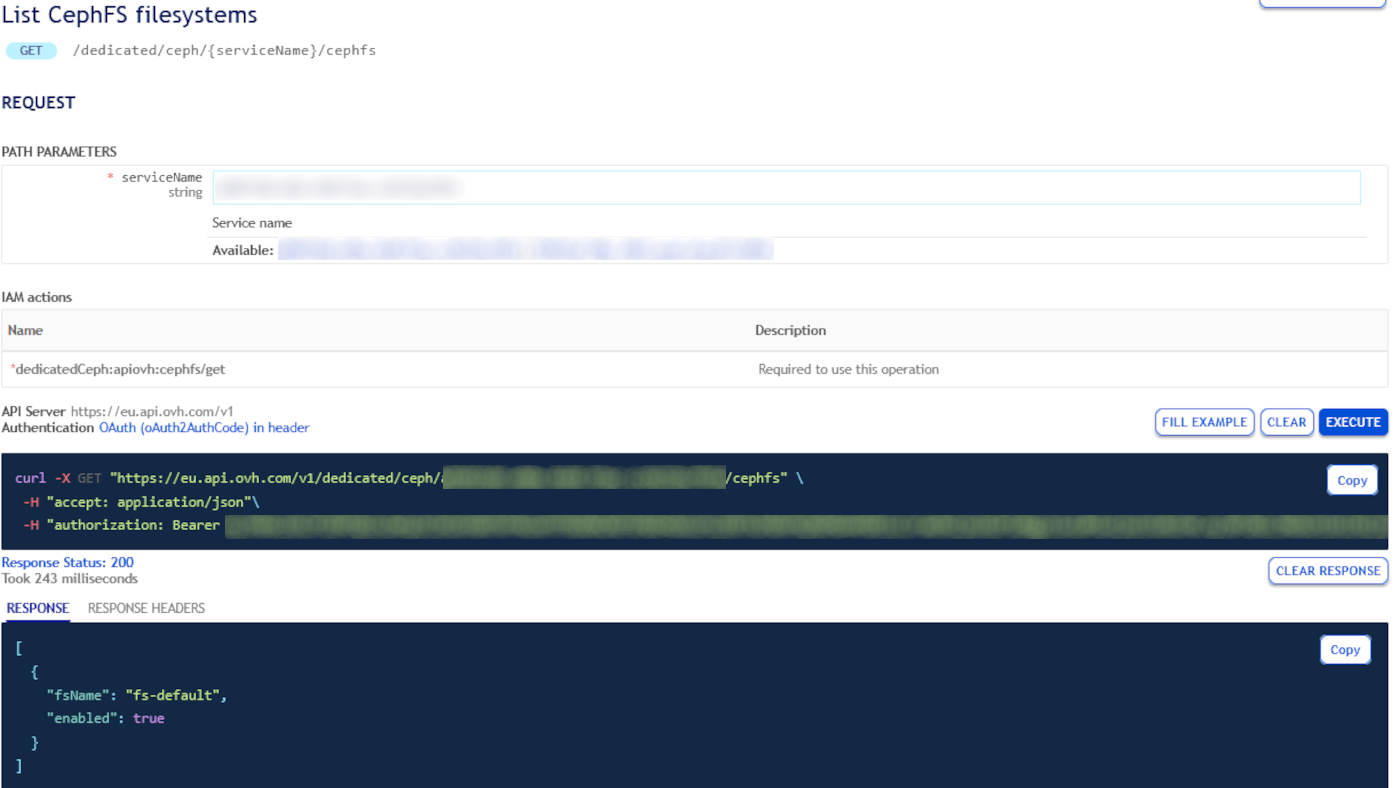

The first step is to list your existing CephFS instances. Here, serviceName corresponds to the fsid of your cluster:
api request 01

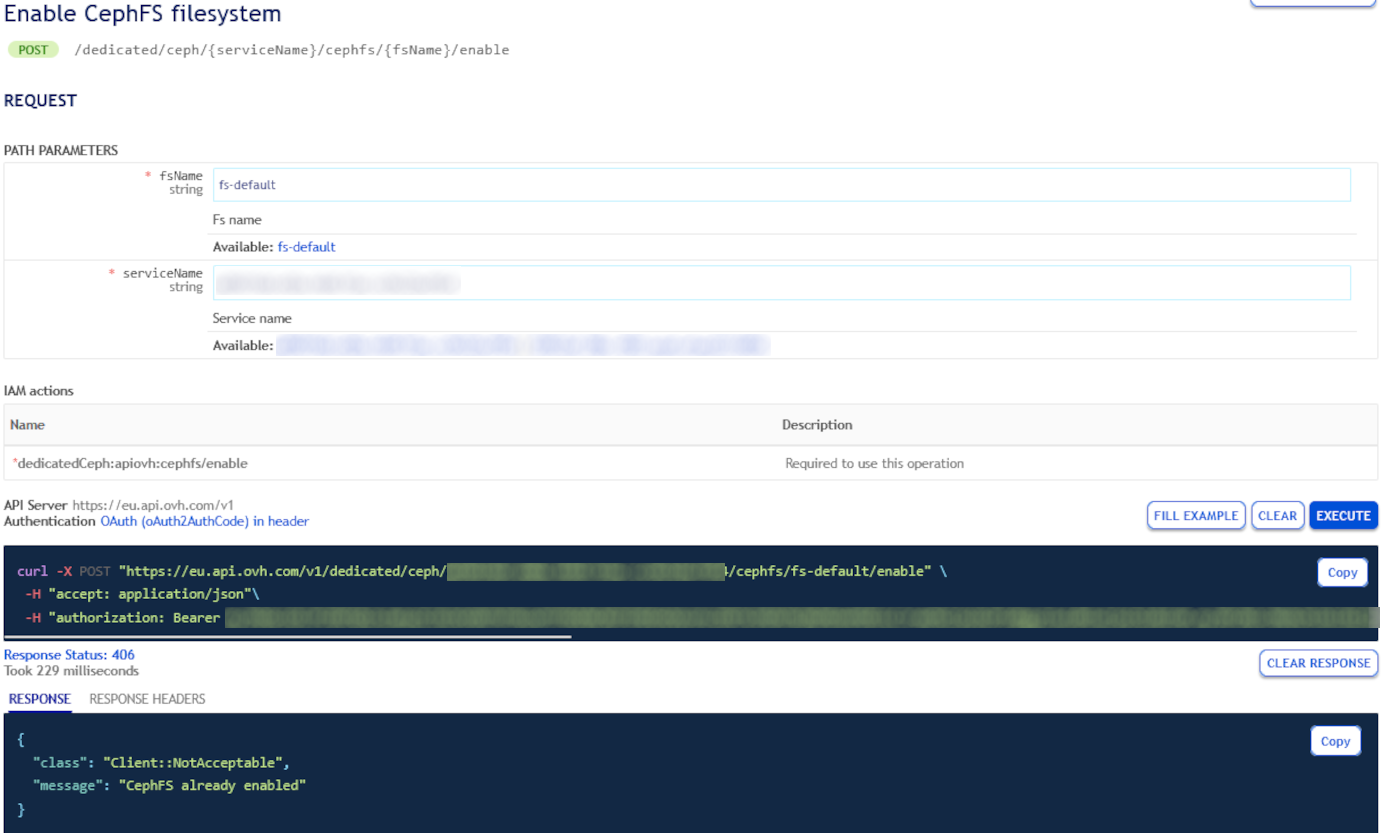

By default, this request returns an empty list. To create your first file system, you need to enable it:
api request 02
Your CephFS should be available within a few minutes. You can verify its status directly on your cluster by running:

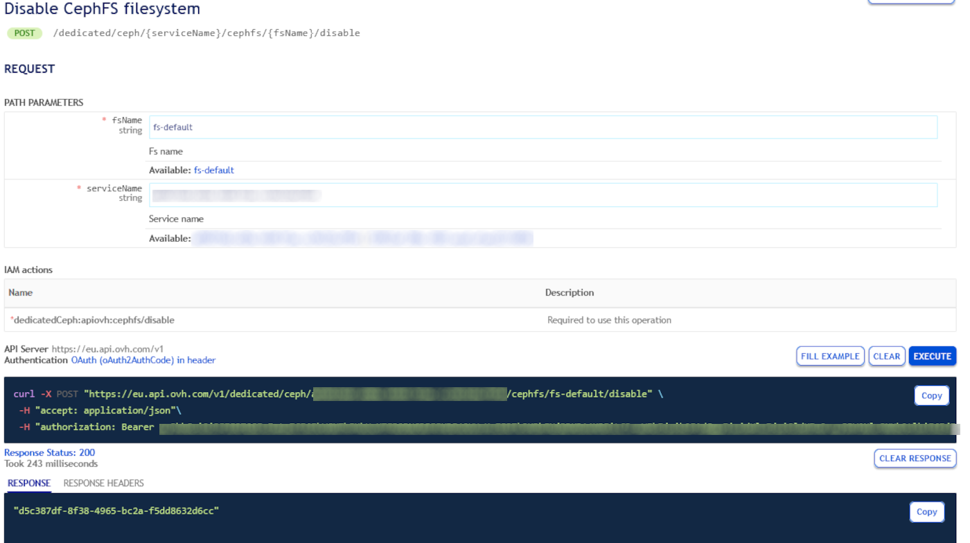

When your file system is no longer needed, you can remove it in two steps:
  • Disable your file system - This blocks access to CephFS, but your data remains intact. If needed, you can re-enable it later.
api request 03

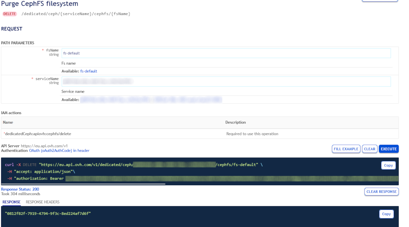

  • Purge file system data – This permanently deletes all data, and can only be done on a disabled file system.
api request 04

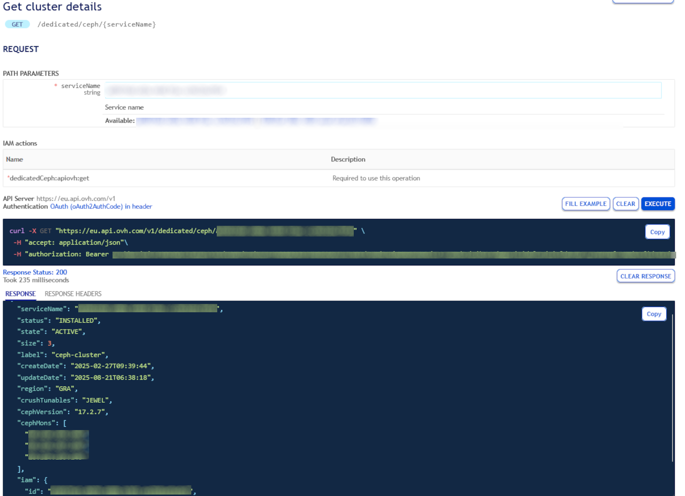

The FSID corresponds to the service name of your CDA. The monitor host IPs can be retrieved using the following API call:
api request 05

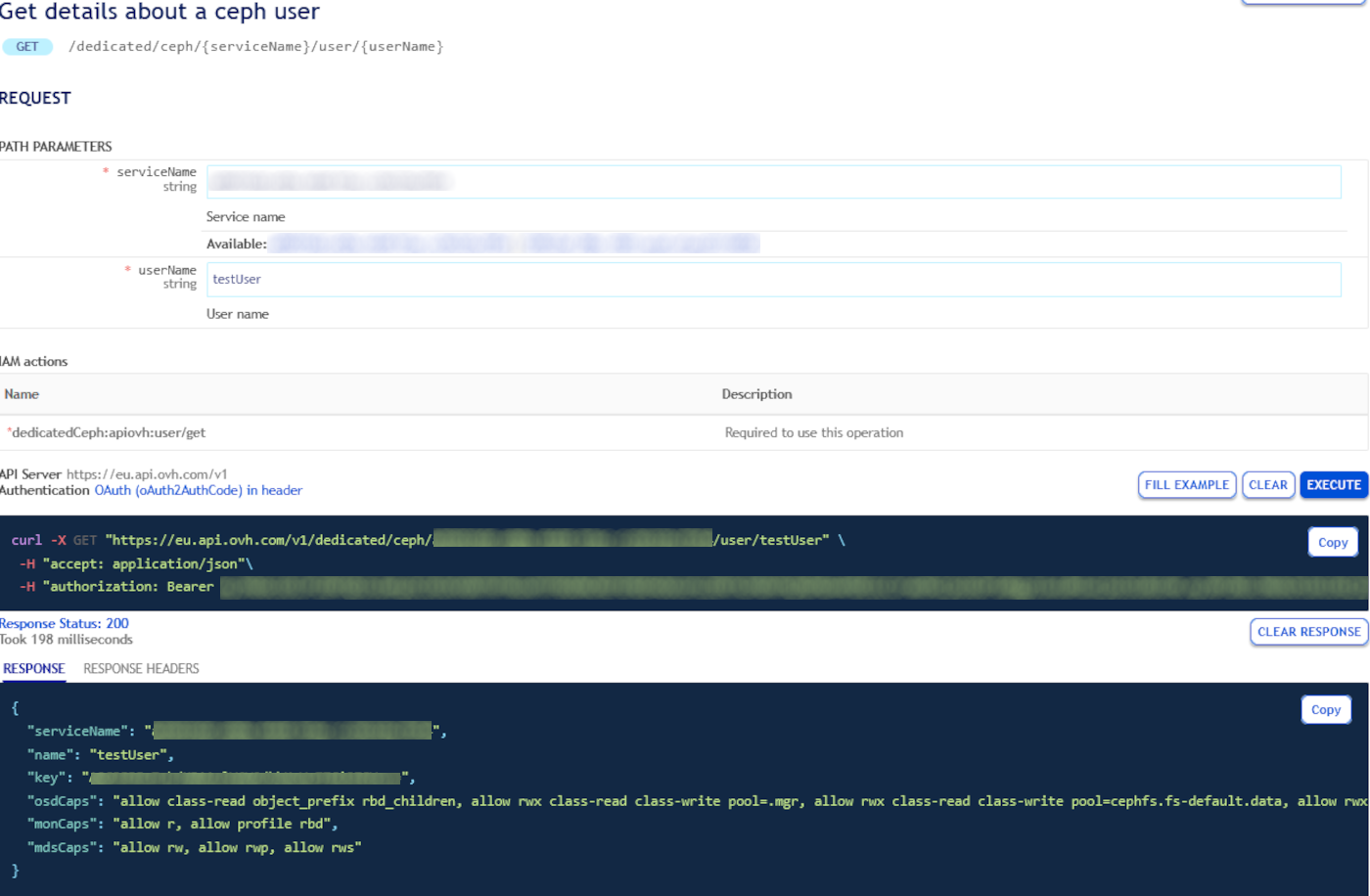

You will also need a second file containing the key for the user that connects to the cluster. Fetch the user key with the following API call:
api request 06
