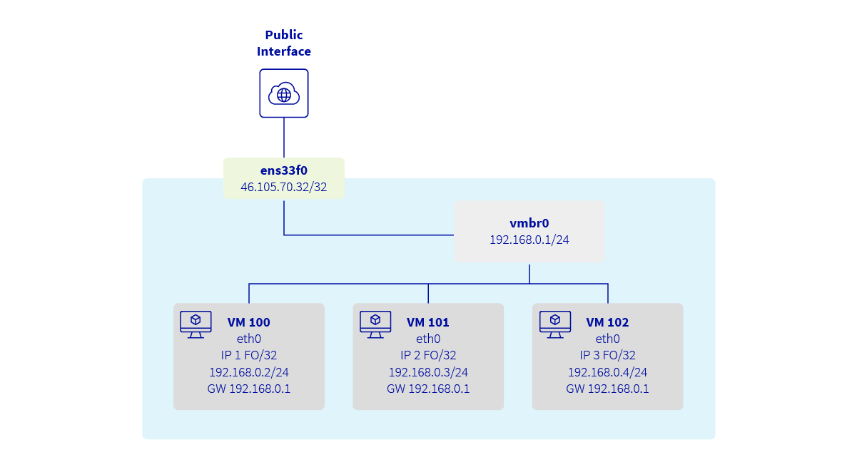

Additional IP in routed mode on public network interfaces
With this configuration, Additional IP addresses must be attached to a dedicated server. If you have multiple Proxmox virtualization servers and you want to migrate a VM from one server to another, you will also need to migrate the Additional IP address to the destination server, via the OVHcloud Control Panel or via the OVHcloud API. You can automate this step by writing a script that uses the OVHcloud APIs.
Target configuration schema
High Grade & Scale ranges
Advance range
Routed mode network schema for High Grade and Scale ranges
Explanations
Proxmox is a Debian-based distribution which relies on ifupdown2 for network configuration. In this guide, the network configuration will be modified via SSH and not via the Web interface.
We will:
  • connect via SSH on Proxmox
  • create a bond interface (only for the High Grade & Scale ranges)
  • create a bridge interface connected to the bond
  • allow packet forwarding between interfaces
  • add routes to the additional IPs

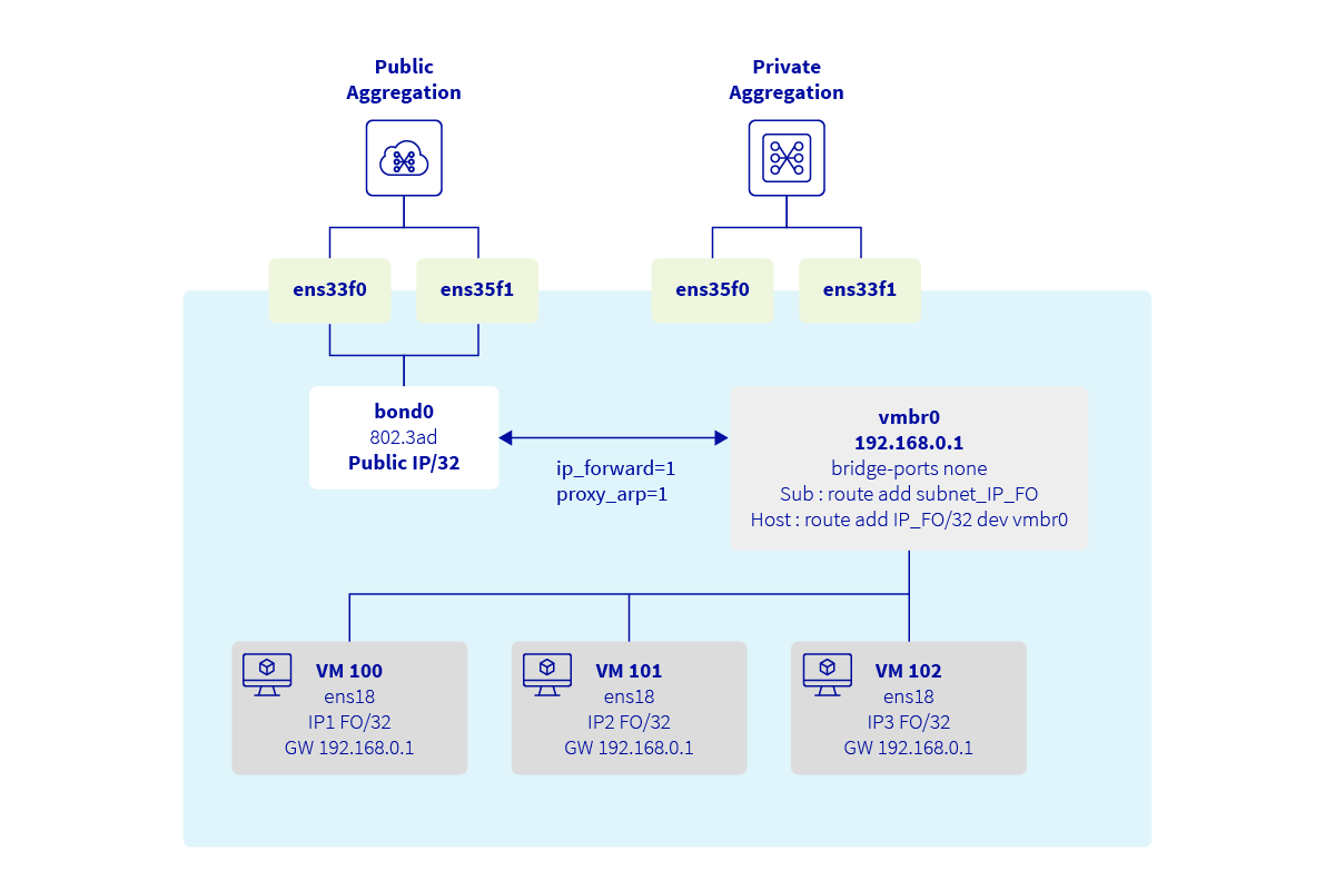

Configure the hypervisor
Log in to the Proxmox server via SSH:
ssh PUB_IP_DEDICATED_SERVER
Allow packet forwarding
Enable the ip_forward sysctl parameter. To do this, we recommend modifying the sysctl.conf configuration file.
Add the following line to /etc/sysctl.conf:
# Enable ip_forward
net.ipv4.ip_forward = 1
Next, reload the sysctl configuration:
sysctl -p
Configure the network interfaces
Advance range
vi /etc/network/interfaces
auto lo
iface lo inet loopback
# Public interfaces
auto bond0
iface bond0 inet manual
        bond-slaves ens33f0 ens35f1
        bond-mode 802.3ad
        bond-lacp-rate fast
        bond-xmit-hash-policy layer3+4
auto vmbr0
iface vmbr0 inet static
        address PUB_IP_DEDICATED_SERVER/32
        gateway 100.64.0.1
        # Define a private network used to communicate with the VMs,
        # it must not overlap with other private networks configured on the server
        address 192.168.0.1/24
        bridge-ports bond0
        bridge-stp off
        bridge-fd 0
        # Add a single Additional IP
        up ip route add ADDITIONAL_IP/32 dev $IFACE
        # Add an IP block
        up ip route add ADDITIONAL_IP_BLOCK/28 dev $IFACE
# Private interfaces
auto bond1
iface bond1 inet manual
        bond-slaves ens35f0 ens33f1
        bond-mode 802.3ad
        bond-lacp-rate fast
auto vmbr1
iface vmbr1 inet manual
        bridge-ports bond1
        bridge-stp off
        bridge-fd 0
At this point, restart the network services:
systemctl restart networking.service
When the networking service is restarted, VMs are not added back to the bridge. This is because Proxmox disconnects each VM from the bridges and does not reconnect them. To force the VMs to reconnect to the bridges, you can restart the VMs.
Client VM configuration example
The VM must be attached to the vmbr0 bridge.
Debian (ifupdown)
Ubuntu (Netplan)
Contents of the /etc/network/interfaces file:
auto lo
auto eth0
iface eth0 inet static
        address 192.168.0.2/24
        address ADDITIONAL_IP/32
        # The "src" option must be set so that packets reaching the Internet
        # have the public IP as source, instead of the private IP 192.168.0.2
        up ip route replace default via 192.168.0.1 dev $IFACE onlink src ADDITIONAL_IP

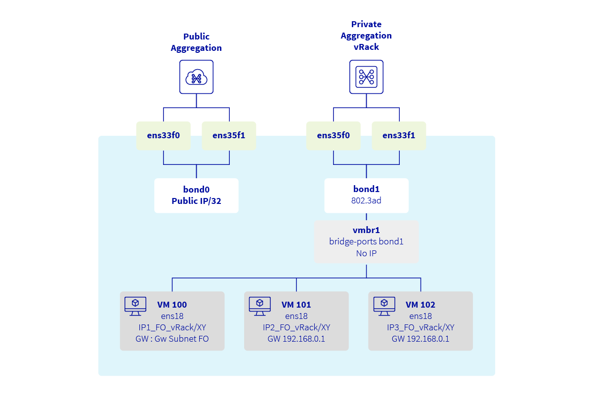

Additional IP via the vRack
This configuration is more flexible as you do not need to associate an Additional IP with a server, but with a vRack. This means that if you have multiple Proxmox virtualization servers and you want to migrate a VM from one server to another, you do not need to perform any action on OVHcloud APIs. The only requirement is for all servers to be connected to the same vRack.
This configuration only works with a block of additional IPs. It is not possible to use a single Additional IP (/32) directly in the vRack. To use an Additional IP, it must be configured on a public interface and cannot be directly integrated into the vRack.
schema vrack
Explanations
We will:
First, add your block of Additional IPs to the vRack.
Select your vRack from the list to view the list of eligible services. Click on the block of Additional IPs you want to add to the vRack, then click the Add button.
Advance range
auto lo
# Public interfaces
auto bond0
iface bond0 inet static
        gateway 100.64.0.1
        bond-mode 802.3ad
        bond-lacp-rate fast
auto bond1
        bond-mode 802.3ad
        bond-lacp-rate fast
auto vmbr1
        bridge-ports bond1
        bridge-stp off
        bridge-fd 0
The VM must be attached to the vmbr1 bridge.
Debian (ifupdown)
Ubuntu (Netplan)
auto lo
auto eth0
        address 46.105.135.97/28
        gateway 46.105.135.110
