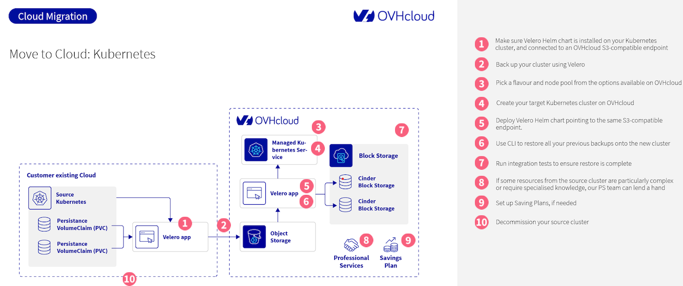

The following diagram illustrates the complete migration journey from your existing Kubernetes environment to OVHcloud. This visual roadmap provides a clear understanding of each phase involved in transferring your cluster.
Migration of a Kubernetes to OVHcloud
Let's now dive into the detailed steps for migrating your Kubernetes cluster to OVHcloud:
  1. Install and Configure Velero with OVHcloud S3
    Ensure the Velero Helm chart is installed on your Kubernetes cluster and configured to use the OVHcloud S3-compatible storage.
  2. Back up your cluster using Velero
    Refer to the official Velero documentation on backup reference to back up your Kubernetes manifests and Persistent Volume Claims (PVCs). Ensure that all backups are successfully stored in your configured OVHcloud Object Storage.
  3. Create your target Kubernetes cluster on OVHcloud
    • Follow the instructions in the OVHcloud documentation for creating a Kubernetes cluster.
    • Choose your preferred deployment mode and proceed with the cluster creation.
    • Optional: OVHcloud Professional Services can assist you in creating an Infrastructure-as-Code script for your new Kubernetes deployment using OpenTofu, streamlining the provisioning process.
  4. Pick a flavour and node pool for your new OVHcloud cluster
    • Size your worker nodes: Carefully assess your existing architecture's CPU and RAM requirements and select OVHcloud node flavors that match these specifications.
    • Replicate network setup: Ensure your new cluster's network configuration mirrors your original cluster (e.g., private nodes on a private subnet, dedicated outbound gateway).
    • Choose deployment mode: Select a deployment mode (e.g., 1AZ or 3AZ) based on your fault tolerance needs and high availability requirements.
  5. Deploy Velero Helm chart on the new cluster
    • On your newly created OVHcloud Kubernetes cluster, deploy the Velero Helm chart. To do this, you can follow this guide.
    • It is essential to configure Velero to use the same OVHcloud S3-compatible endpoint where your existing backups are stored. This action will automatically make your backup resources available to the new cluster.
  6. Restore your backups onto the new cluster
    • Utilize the Velero CLI to restore all your previous backups onto the new cluster. Refer to the Velero documentation on file system backup for detailed commands.
    • Before restoring, set your application to maintenance mode on the source cluster to prevent data inconsistencies during the transition.
    • After restoration, carefully update all your DNS records to point to the new cluster's services.
    • Ensure your ingress controllers and Load Balancers are properly configured and ready on the new cluster.
    • Map the source cluster's storage class to the target cluster's equivalent using Velero configuration if your storage classes differ between environments.
    • Optional: If the deployment process appears overly complex, or if you require assistance with migration and rollback strategies, reach out to the OVHcloud Professional Services team.
  7. Run integration tests to ensure restore is complete
    • Execute all your application's integration tests on the new target cluster.
    • Thoroughly verify the health and functionality of your applications after the deployment.
    • If any issue is detected, be prepared to roll back to your source cluster if necessary.
  8. Seek Professional Services assistance (if needed)
    If certain resources from your source cluster are particularly complex or require specialized knowledge for migration, the OVHcloud Professional Services team is available to provide expert assistance. You can find more information on the Professional Services page.
  9. Set up Saving Plans (if needed)
    Explore the option of OVHcloud Saving Plans to optimize your cloud costs. Learn more about the available Saving Plans to determine if they align with your financial strategy.
  10. Decommission your source cluster
    After fully confirming that your applications are running reliably and without issues on the new OVHcloud Kubernetes cluster, you can safely decommission your source cluster.
