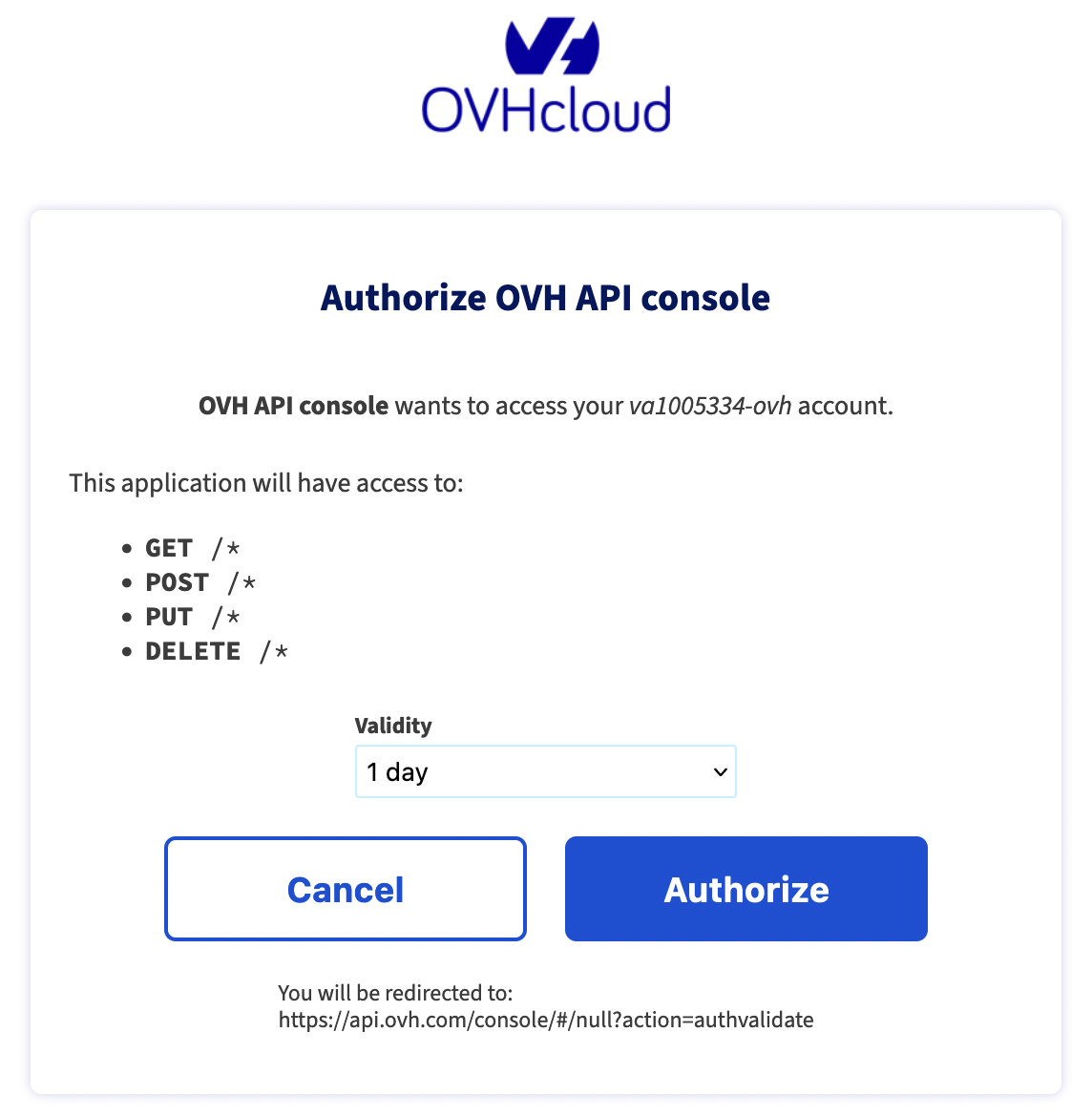

Configure kube-proxy through the API
The API Explorer
To simplify things, we are using the API Explorer which allows to explore, learn and interact with the API in an interactive way.
If you go to the Kubernetes section of the API Explorer, you will see the available endpoints, such as:
