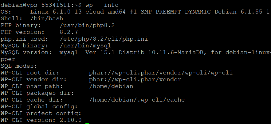

Test the installation of WP-CLI by running the command:
wp --info
If WP-CLI has installed successfully, a message like this will appear:
