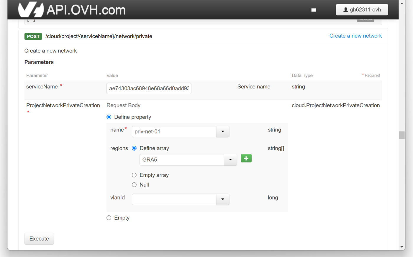

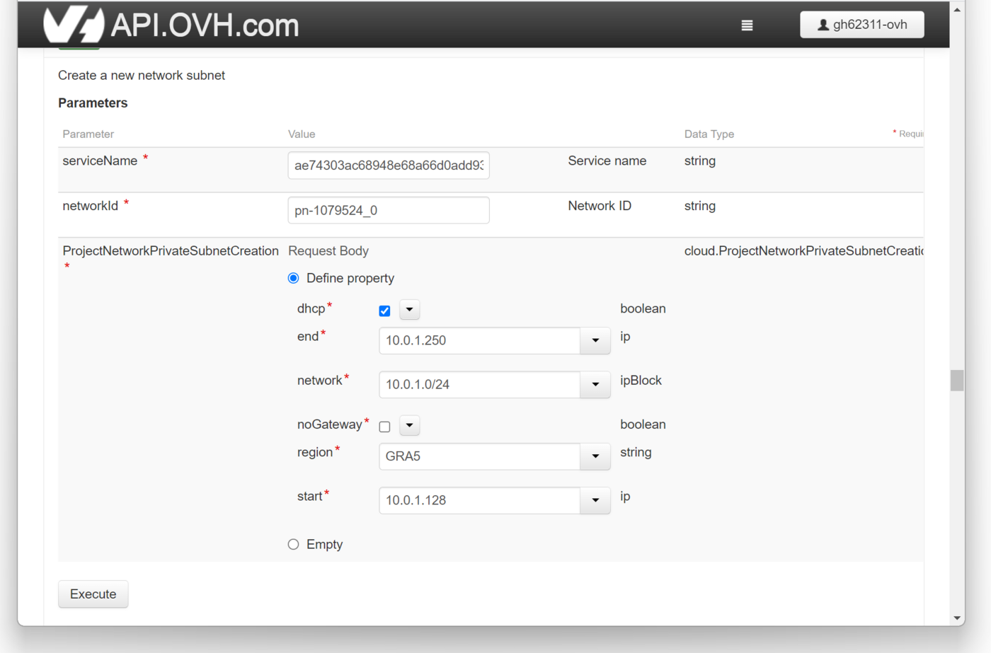

First of all, we will need to set up vRack Private Network for our Public Cloud. To do it, we follow the Configuring vRack for Public Cloud guide. Once you have created a vRack and added it into a Private Network, you can continue.
As explained in the Known limits guide, the following subnets are not compliant with the vRack feature and can generate some incoherent behaviours with our used overlay networks:
10.2.0.0/16 # Subnet used by pods
10.3.0.0/16 # Subnet used by services
172.17.0.0/16 # Subnet used by the Docker daemon

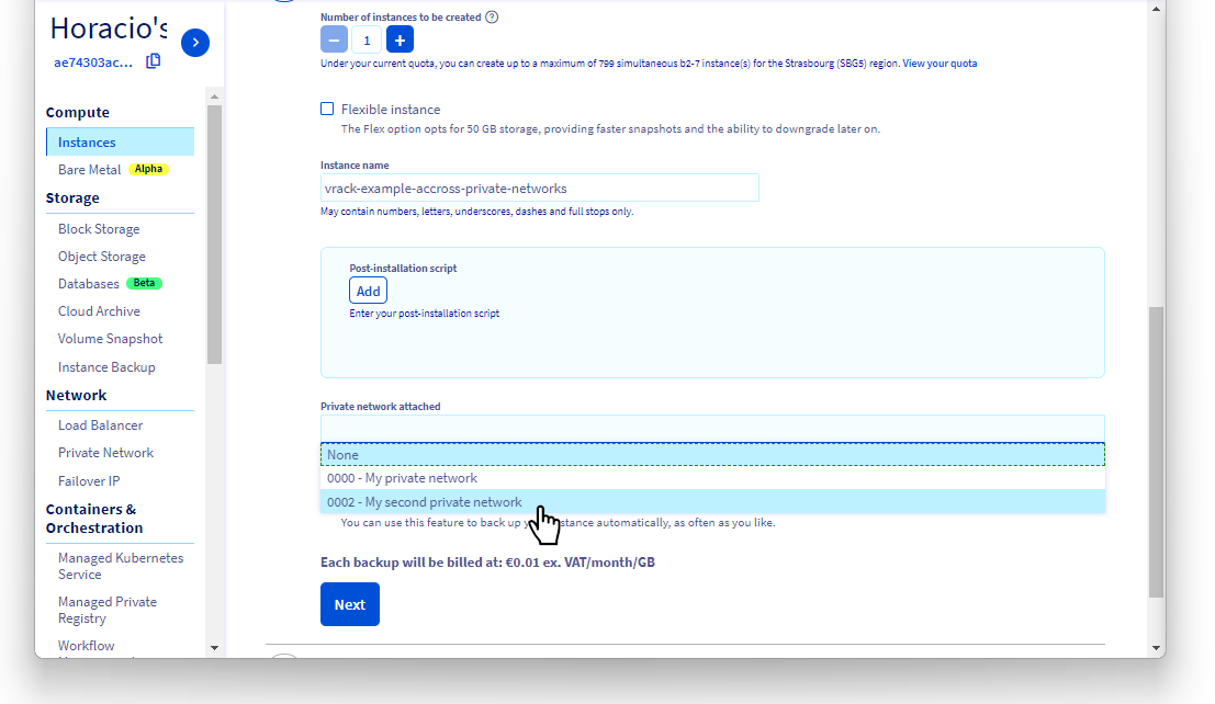

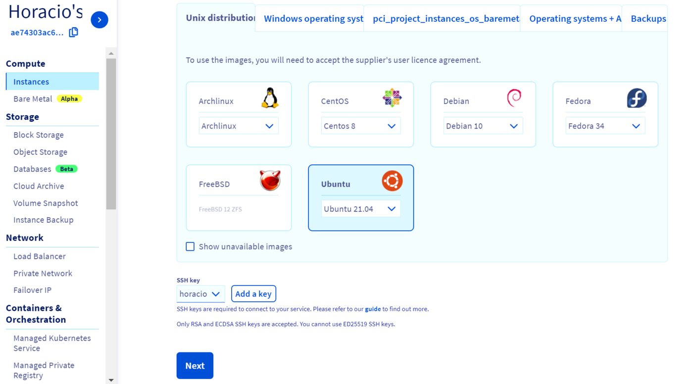

Now we can create a new Public Cloud instance inside the vRack, by following the Integrating an instance into vRack guide.
We are going to create an Ubuntu instance.
In the Network settings section of the instance creation page, we attach it to the private network we created before.

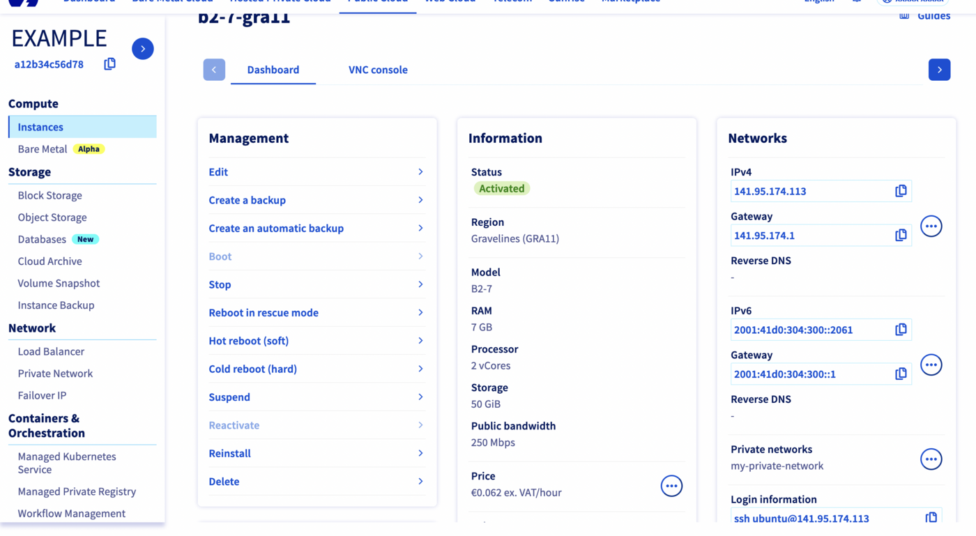

After instance creation, click on the name of the newly created instance: the connection details are displayed in the Connection details card of its Overview tab in the OVHcloud Console.
If we log in to the instance using SSH, we can see that it has two network interfaces, one attached to the public IP address we used to log in, the other attached to the private network:

Please take note of the private network IP address (in this case 10.0.64.51), as we will need to use it to configure WordPress.
