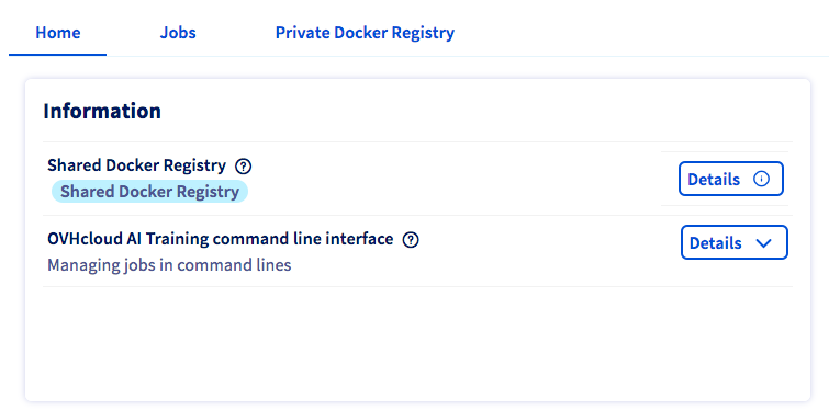

If you want to know the exact commands to push to your shared registry, please consult the lower part of the Docker registries tab of the Configuration page (AI Notebooks, AI Training or AI Deploy): select a region to display the Registry URL and the commands to log in, tag and push an image.
